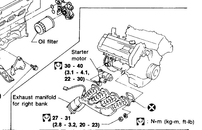

I purchased a used 1996 infiniti i30 about a month ago, and sometimes when I try to start it, it wont start. The transmission and engine are great, and the car runs excellent. I took it to a friend who is a mechanic and he could not find the problem. He test the starter, ignition switch, and battery, and they all work.
Here is the problem:
I put the key in, and when I turn it, it wont even make a noise. All the lights on the dashboard will come on, but that's it. This only happens sometimes, and the car works perfectly all the other times. It worked 10 times in a row the past few days when I tried to unlock and lock the doors with the key (manually) because I thought it was the securtity system. It still might be the security system, but I tried to start it by using that technique, and it didnt start. If it does not start the first time, It takes about a minute of continuously turning the key to get it to start. It worked twice today when I put it in neutral and then tried to start it, and sometimes it works when i turn the wheel a little and then try to start it.
Sorry this is long, I just tried to give as much information as I could to make it easier (or more difficult) to answer.
Any help would be greatly appreciated.
Thanks!!!

Hey mines doing the exact same did you ever find out what was going on

This sounds like the starter has gone bad and needs to be replaced. To be sure here guide to confirm the issue and the instructions in the diagrams below for your car in case the starter is the problem:
