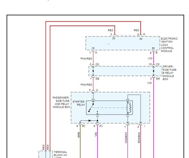

Does anyone happen to know if the w202 chassis came with a inertia safety cutoff switch or reset button.I have the car listed above C280. I recently replaced my heater core and had to dismantle the entire dash. In the process I lost my one and only fob and had to have one made. I had to wait to get the key to test out the HVAC system before I put the dash back together. I received the key and went to test it. Unfortunately, I got in the car and found the car would crank but not start. I now have replaced the fuel pump, fuel filter, fuel pump relay, crankshaft position sensor, checked all my fuses and still have the same issue. I can hear the fuel pump come on and it seems to have pressure in the lines. unfortunately I am unable to test the pressure at this time but the crank is solid and doesn't seem to struggle. I have also replaced the battery. I deep in this nonsense money wise and will take all info and suggestions at this point. I don't have the time or money to have it towed to a mechanic and would prefer not anyway. Due to the fact I live so far out and a tow would be ridiculous. Please help!! I'm a decent mechanic but this has got me up in arms and irritated to all heck. I don't believe it is the PCM because everything else works electrically... I'm stumped.

No, it does not have an inertia switch and if it did the pump would not be running. It sounds like the most likely issue is the new key. When you put the key in switch does the security light flash or stay on? If it does then the key isn't programmed properly to your car. If the light is not on then I am concerned you overlooked something in the process of changing the heater core in which case it's a matter of back tracking until you find it.
If you can check on the security light and let us know what you find we will be happy to help you track down the issue unfortunately a security issue can cause the same symptoms as other issues so we need to eliminate that as the cause before we start trying to find other problems. Please keep us to date on your progress and thank you for using 2CarPros!

I checked to see if the security light stayed on and it did not. Neither the light on the center console or the key stayed on. On top of everything I still have the dash pulled but do have everything plugged in... Except for the after market stereo (head unit), the ash tray, glove box and head light/parking light switch. Not sure if either of those would have a ground that would cause an issue. I was also curious if replacing the brake light switch would eliminate any trouble shooting? Thanks for quick reply back by the way, much appreciated. Still stuck though. Not sure if I should buy a ODBll scanner and try that too...

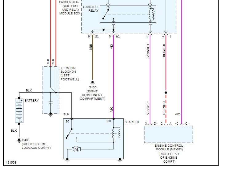

As far as the scanner if you have easy access to one certainly can't hurt. As far as the brake light switch the schematics show that it isn't part of the starting circuit. I have attached a copy of the wiring diagram for the starting circuit and hopefully that will help you track down the issue. I suspect it has something to do with the terminal block in the driver's foot-well. Hopefully this will help you track down the issue. Here are a few links to some of our tutorials that you might find helpful:
