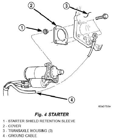

I do not have a picture of the starter. What are trying to do related to that?

The starter location is even more sad. This drawing simply shows how it is mounted. Chrysler has always put them on the driver's side of the engine. In all my years at the dealership in the 1990's, I never changed one of these, so I do not know how difficult it is to get to it.
