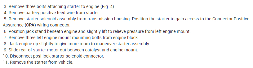

starter replacement instructions please?
2002 DODGE INTREPID
ELEVATORGUY2
almost everytime i turn the key to start the car all i get is a click. i have to turn the key multiple times before the car will start. i figured it was the starter but i have noticed it is getting harder to start as the temperature drops.
Jan 18, 2009 at 9:01 PM
DANNY L
  • 5,648 POSTS
Hello, I'm Danny.

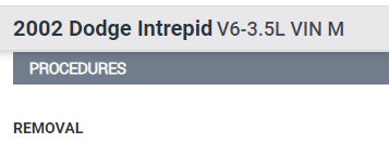

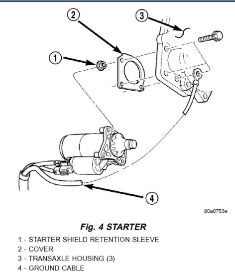

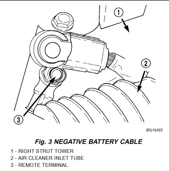

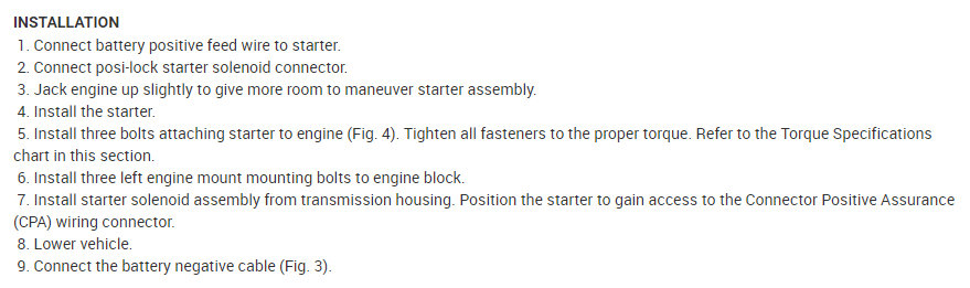

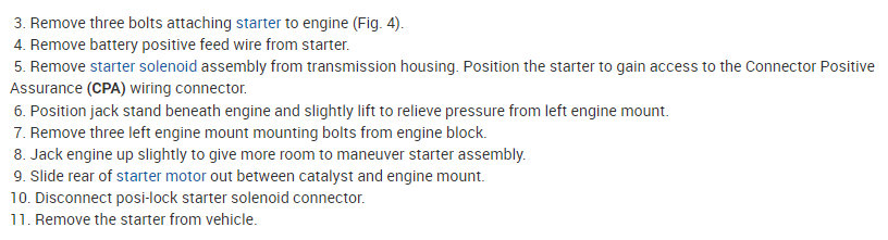

It sounds like you might be having an issue with the starter motor solenoid which is a part of the starter motor assembly. Here is a tutorial showing the function of the solenoid and its replacement:
https://www.2carpros.com/articles/how-a-starter-and-solenoid-works
Once removed from your vehicle your local auto parts stores will test for free. I've attached picture steps below showing how to remove and replace the starter motor assembly on your Dodge. Hope this helps and thanks for using 2CarPros.
