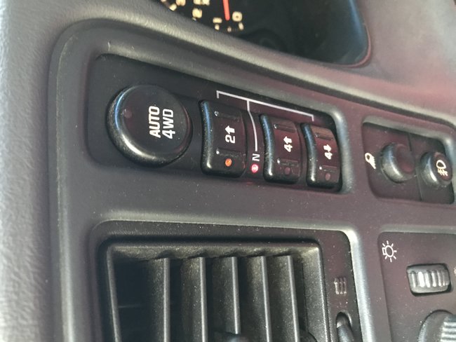

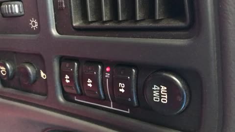

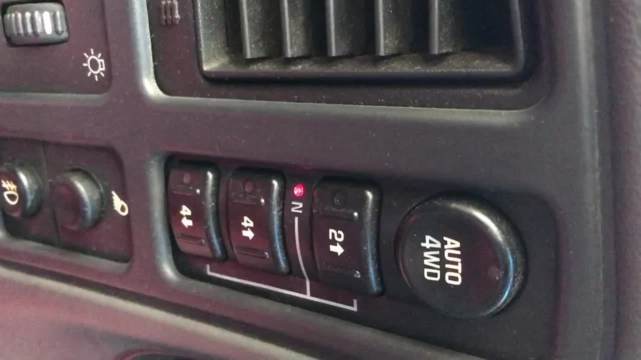

Where my 2WD/4WD selector is, my truck has been going from 2WD to N. It changes only when I turn truck on and off. For example, went 15 miles and it was in N. Turned truck off then came back and was in 2WD. I’m thinking it’s a loose connection somewhere. When I try to go to 2WD from N it just blinks. You’ll see in video attached.

Here is photo and video:
Jul 25, 2020 at 9:26 AM
You are probably correct that there is a connection issue but it could also be the actuator. However, the flashing and staying in Neutral is indicating a fault. That means you have a fault code so we need to start with that or we are just guessing and that can get frustrating and costly.
Here is a guide that will help with this but we need to check for codes and go from there. If you can't pull codes then just stop by a parts store and they should be able to pull them for you.
Let me know what you find and we can go from there. Thanks
