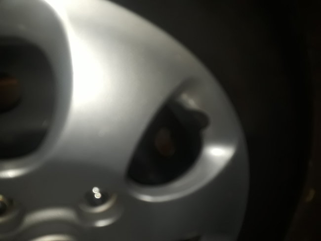

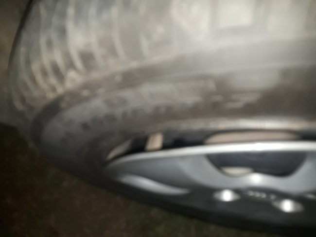

Walmart installed tires on my car and one of the hubcaps was installed wrong. No valve stem in the valve stem hole. Also they cross threaded one of my lugs the valve stem is pushing the hubcap out about an inch and they are telling me it is safe to drive an hour and a half one way to work at 70 mph. Is that safe?

This is a picture of the tire.

Sorry, I did not see the photo sooner. I cannot see a valve stem behind the wheel cover. This looks like a plastic cover with one of the fingers that did not go in the right direction. That is actually real common, but it definitely should not have been left like that. Sometimes a long flat-blade screwdriver is needed to nudge the finger in the right direction, then the cover can be pounded on.
Some of these have a thick wire ring around all of the fingers. If yours is of that style, first try to push that finger in. If the wheel cover pops into place, you are done. If it will not seat properly, try to pull it off, then have the mechanic put it on properly. That is better than losing it alongside the road. Some of these are held on by two special lug nuts that have an extra lip for that purpose. You cannot lose that type of cover, so just ignore it until you get back to the shop.
As a word of warning too, plastic wheel covers become brittle with age, and those fingers will break off very easily. I do not have any words of encouragement for that. That is why we see so many of these laying on the side of the road. I even have one minivan at home with a wheel cover that fell off when the van was just sitting for a few years. Good time to buy some better aftermarket metal replacements.

The valve stem is behind the plastic finger.

Here is where it should be yet it is not and what about the lug that is cross threaded? I will ask again is it safe to drive on the interstate?
