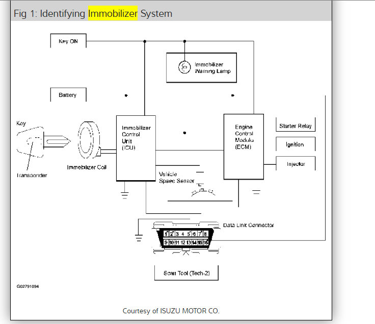

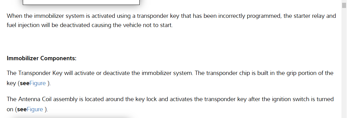

Need to reset the security system on my car is there a way to bypass it?
Apr 29, 2019 at 11:42 PM

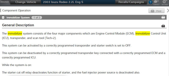

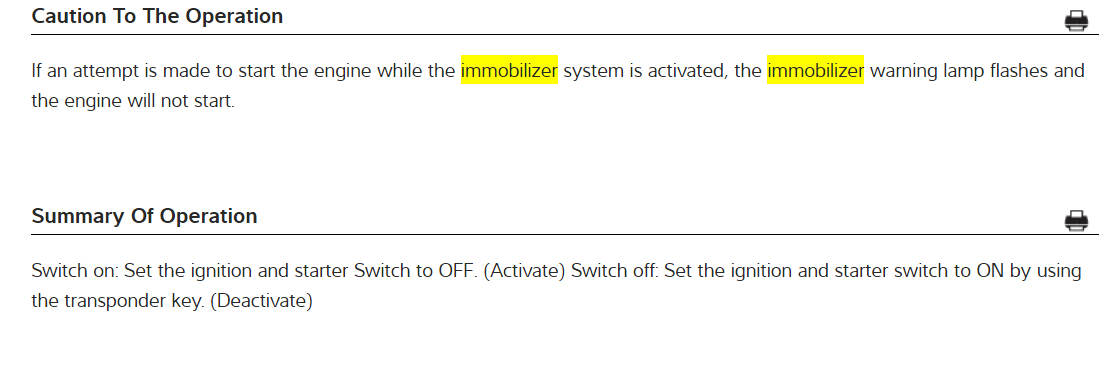

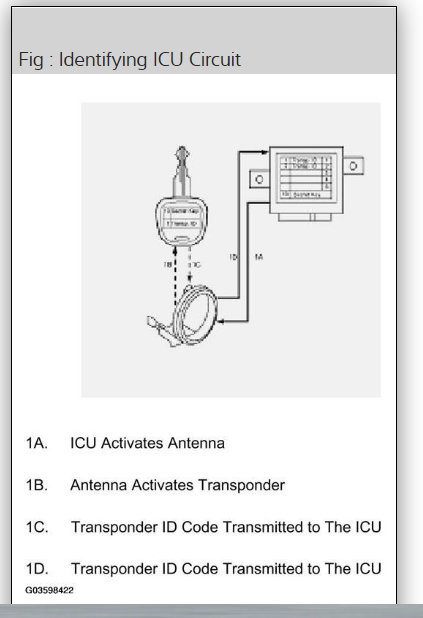

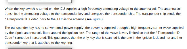

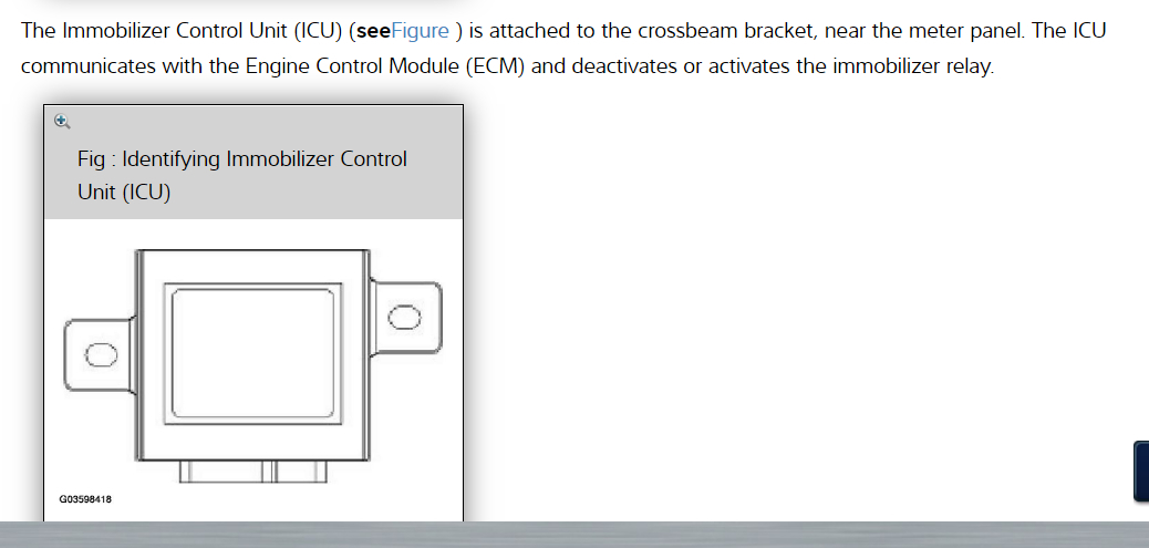

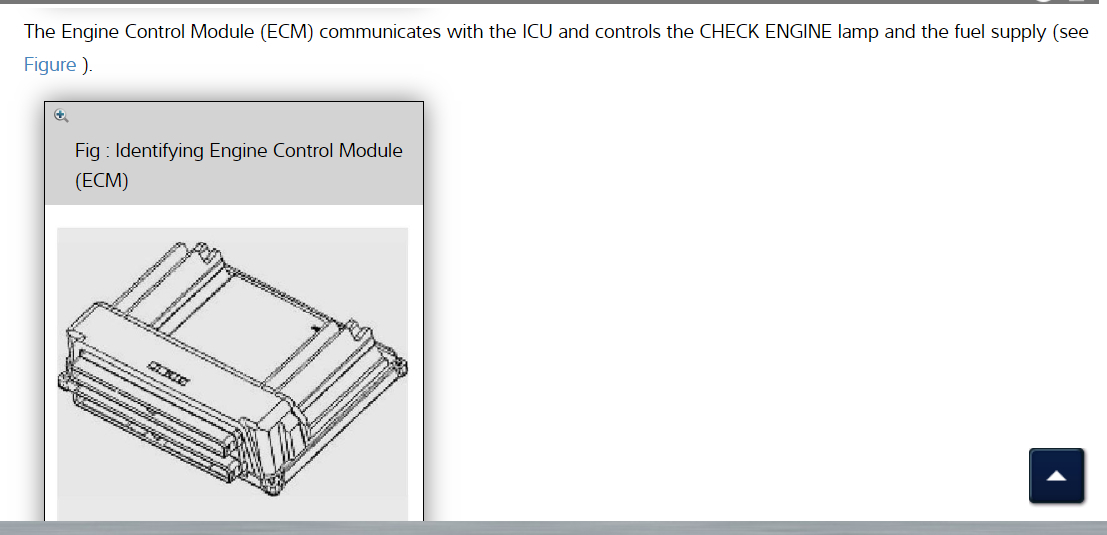

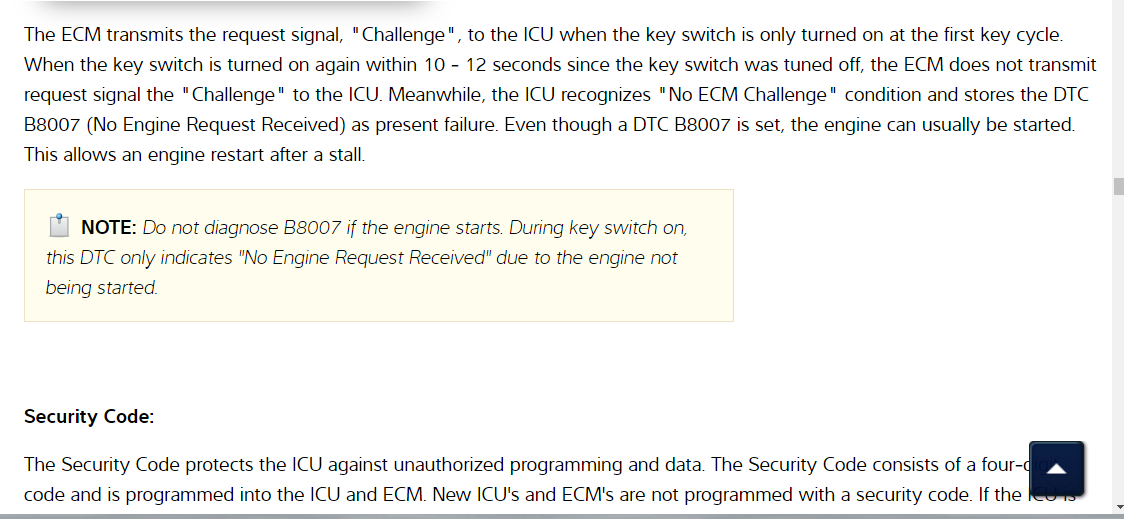

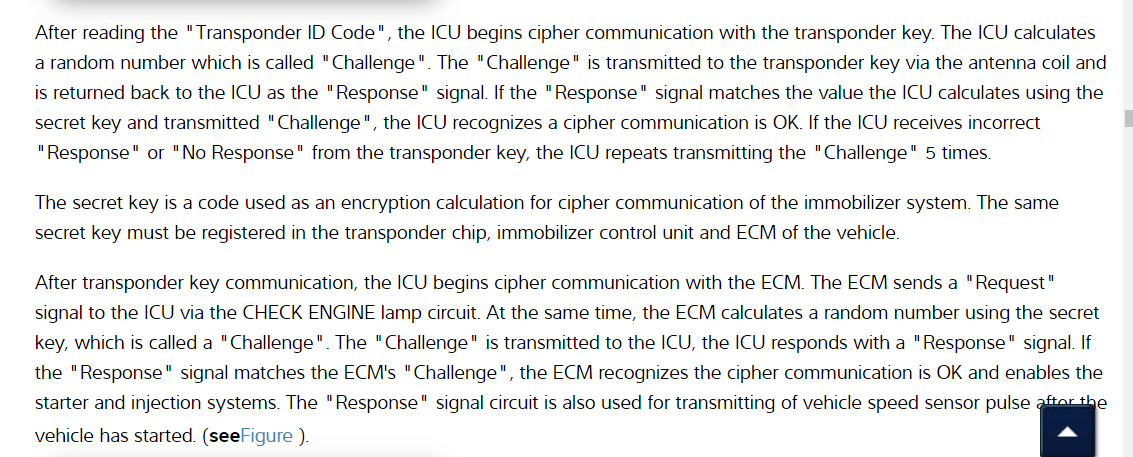

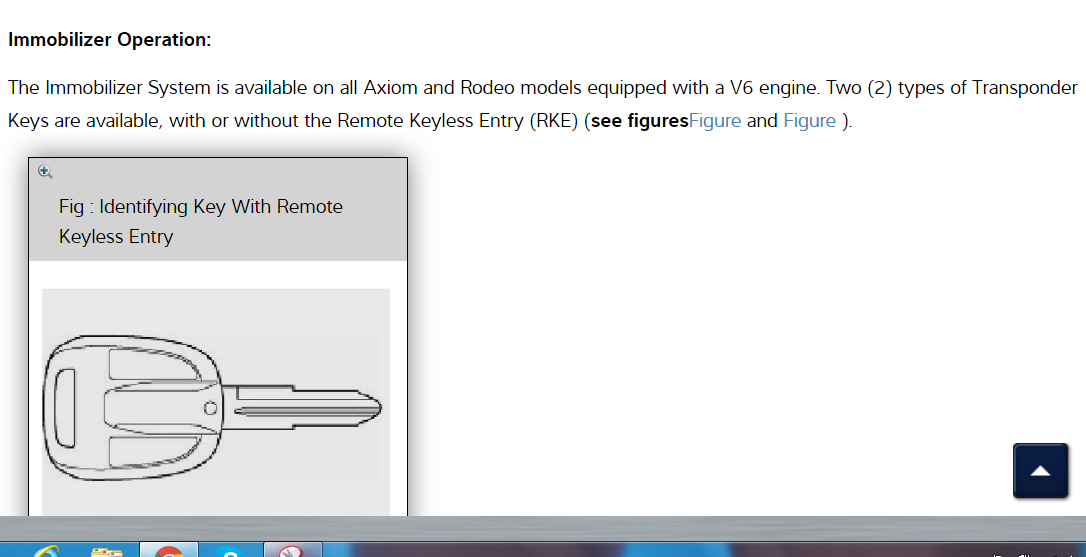

Hi Gloria,

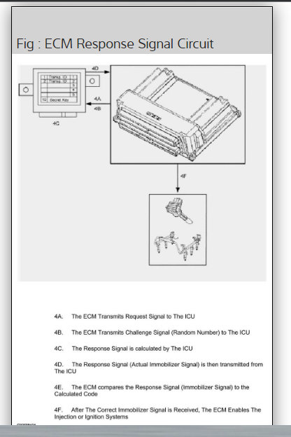

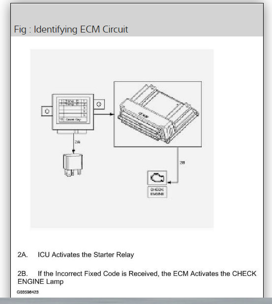

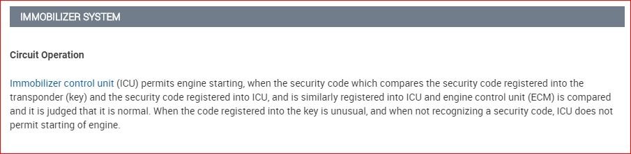

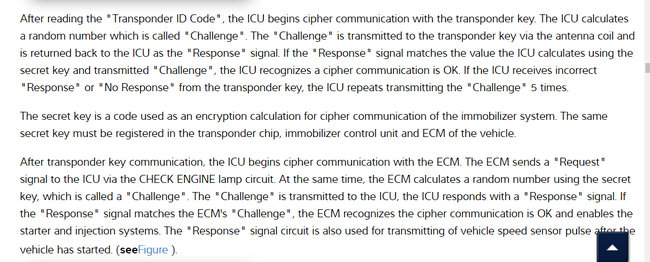

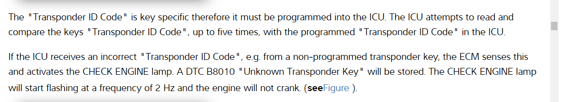

Unfortunately, these systems are designed purposefully to avoid being bypassed so that the car cannot be stolen.
I attached a copy of how it works and as you can see, your key needs to send a coded message to the ICU which sends it to the ECM and they all agree that the key is a good key. Once this happens, the ECM sends all the needed messages to start the vehicle. Without this coded message, there is not way to bypass it.
Sorry. Let me know if you have further questions or if I can help figure out what the issue is. If you want me to, then we need to retrieve the codes in the system. That will tell us if there is an issue with the key or one of the modules.

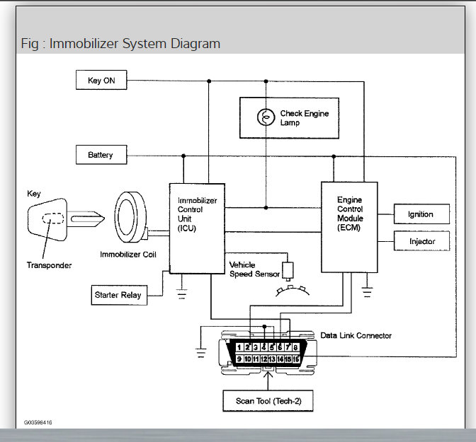

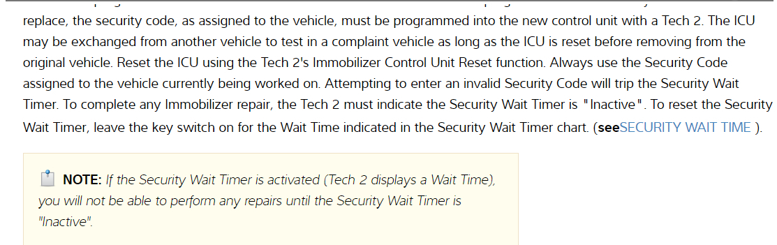

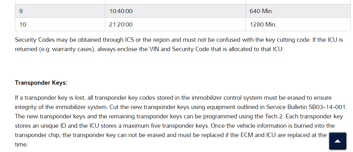

Need to bypass immobilizer? Light flashes.
May 1, 2019 at 7:33 PM (Merged)

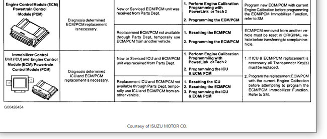

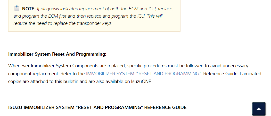

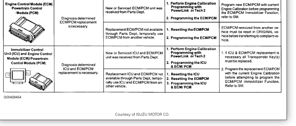

SCGRANTURISMO
  • 4,897 POSTS

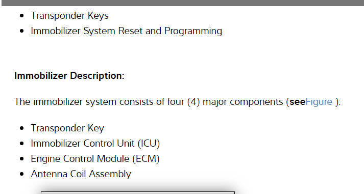

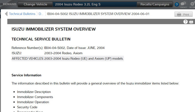

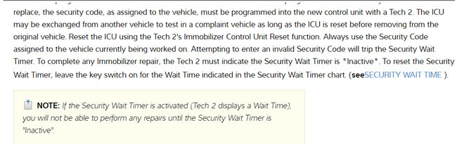

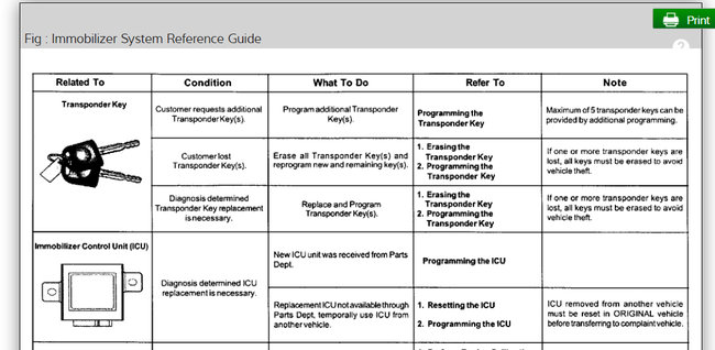

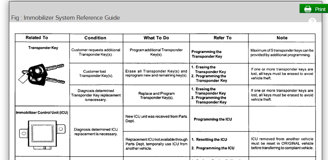

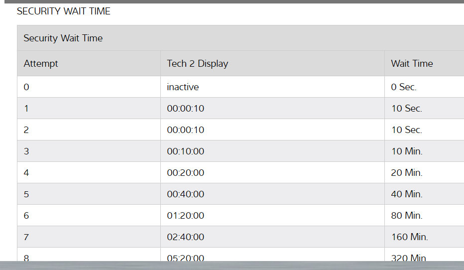

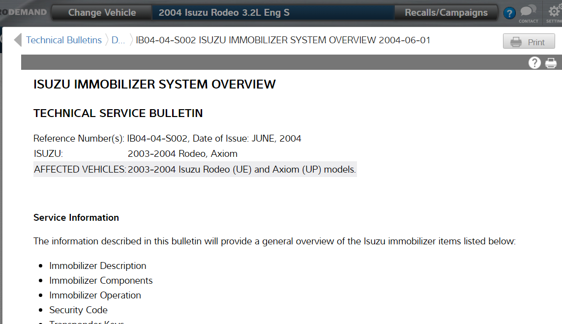

I have included for you in the diagrams below the Isuzu Factory Technical Service Bulletin (TSB) for resetting the Immobilizer System. Please go through it and get back to us with what you decide to do.
Thanks,
Alex

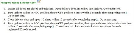

LOSTCLOUD

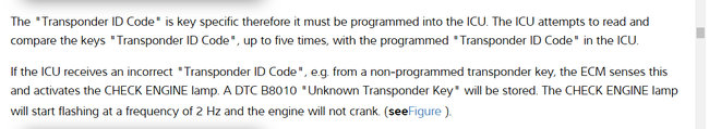

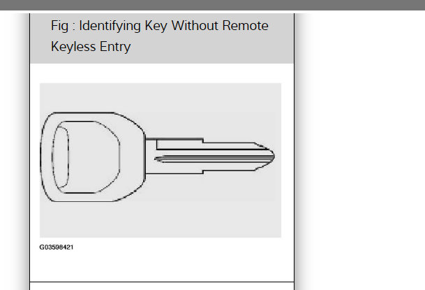

When I turn my key the engine sounds as if it is going to start and then it turns off and the immobilizer light begins to blink. I took out the battery thinking that it was low, but it is not. I had to get a key made through the dealer, but the alarm switch did not come with it. They told me I would be able to use this key until the alarm came. They also told me that this 2004 rodeo does not have a chip in the key, so I should not have any problems with copies. How can I start my engine and turn off my immobilizer light?
Apr 13, 2021 at 10:43 AM (Merged)
HMARVEL
i recently purchased a 2004 rodeo and had to get a duplicate key made. The dealer told me that the key does indeed have a chip in it and if you try and use a non-chip duplicate, you may experience immobilizer problems. I would try to reset the system by following this guide.
https://www.2carpros.com/articles/how-to-reset-a-security-system
Try a hard reboot of the security system.
LOSTCLOUD
Yep that worked great guide

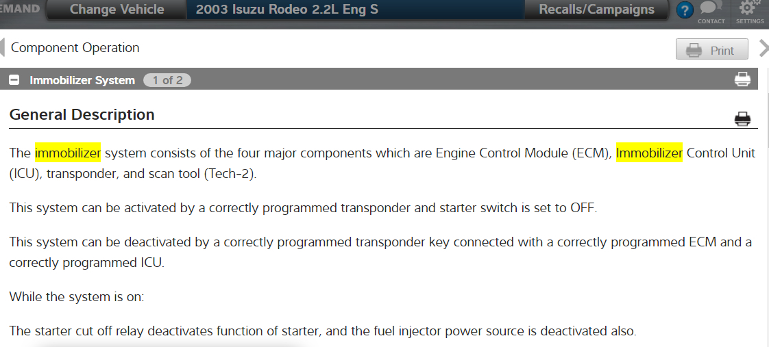

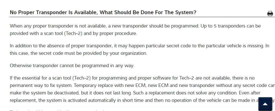

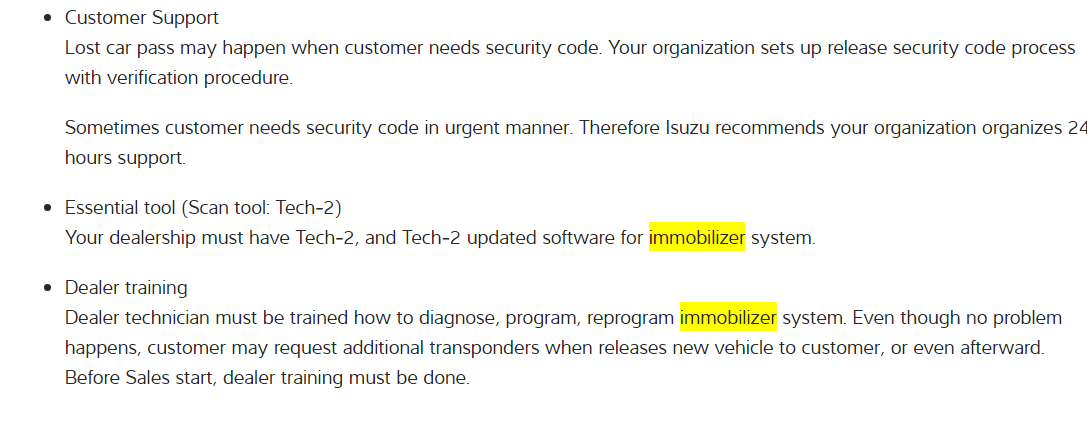

THE LEGEND

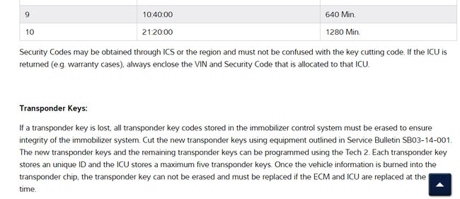

Key is lost as is key fob. ignition is unlocked, switch is accessible. Can I bypass immobilizer as vehicle has to be driven to workshop?
Apr 13, 2021 at 10:44 AM (Merged)
SCGRANTURISMO
  • 4,897 POSTS

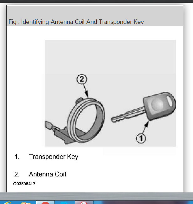

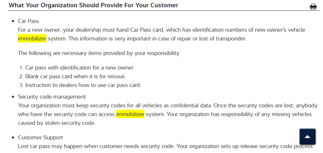

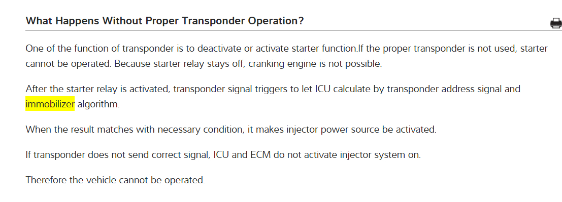

In the diagrams down below I have included all the information for your vehicle about the immobilizer system. If you have lost your immobilizer transponder ignition key, you should contact your local dealership for support. Please go through this guide and get back to us with what you are able to find out.
Thanks,
Alex

MARKIMPORT
Engine will not turn over. All lights come on it is in park and when key is turned to start it seems locked out from turning over. When key is removed factory alarm does a ding dong 10 times. I have disconnected battery for 20 minutes and reconnected with key in on position. Still no turn over.

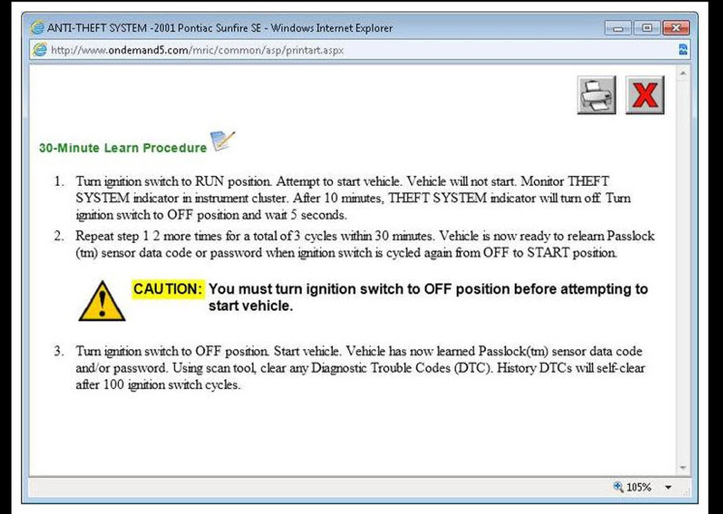

HMAC300
  • 48,601 POSTS
try a security system reset see pic and link one should get it going if not that then scan for codes . if battery was dirty/replaced sets the security off.
Check out the diagrams (Below). Please let us know what you find.

TOM1967
does anyone know how to reset the anti-theft system? please help.
CJ MEDEVAC
  • 11,004 POSTS
This will work with most cars, Remove the negative battery cable from the battery. Then hold it to the positive battery terminal for 1 minute this will discharge the capacitors rebooting the system. This guide can help as well.

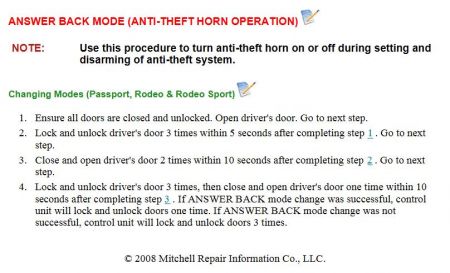

COWEYESONE
My car alarm goes off erratically when I use my key in the drivers door to open the car. My remote does not work. How can I disengage my alarm so this will stop?
KHLOW2008
  • 41,814 POSTS
Hi coweyesone, Thank you for the donation. I can only finid the procedures for turning the horn off and hope it helps.

COWEYESONE
Tried this procedure already. Is there a way to totally disengage the system. I don't need the alarm at all.
KHLOW2008
  • 41,814 POSTS
I could not find any data on the method to disable the alarm except to disconnect the control unit and this might affect other functions such as the security system.
