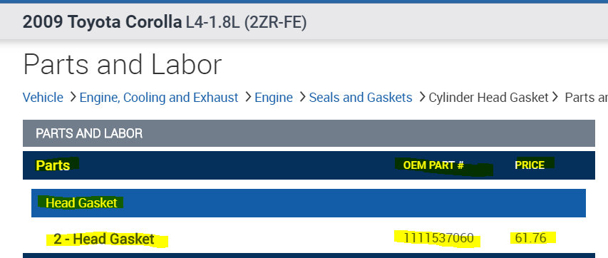

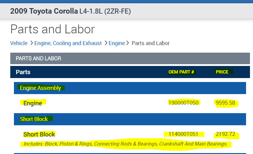

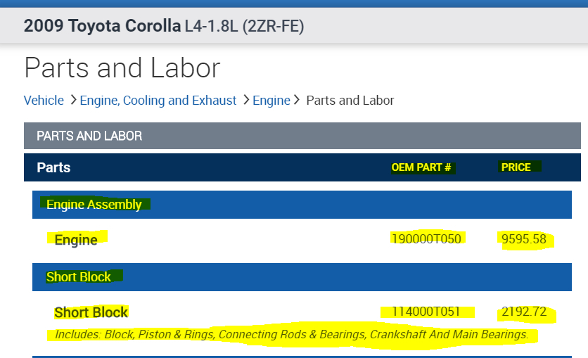

SCGRANTURISMO
  • 4,897 POSTS
In the diagrams down below I have included the Original Equipment Manufacturer (OEM) part numbers and prices for both a new replacement engine and a head gasket kit. I have also included the price for a new short block, as well, if you decide to go that way. As far as a re-manufactured or used engine, you will have to find that yourself, but I would recommend looking at LKQ, which is Ebay's used parts warehouse. They will deliver to wherever you need it sent to. We offer repair advice and instructional how to guides and instructions so you can repair your vehicle yourself. Please go through this information and get back to us if you would like the step by step instructions from the vehicle manufacturer for the removal and installation of your vehicle's engine or the step by step instructions for replacing your vehicle's head gasket. We will be happy to shoot one or both of them over to you.
