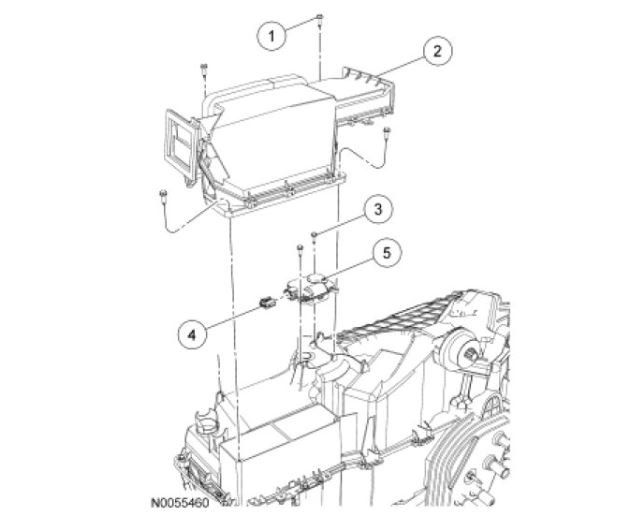

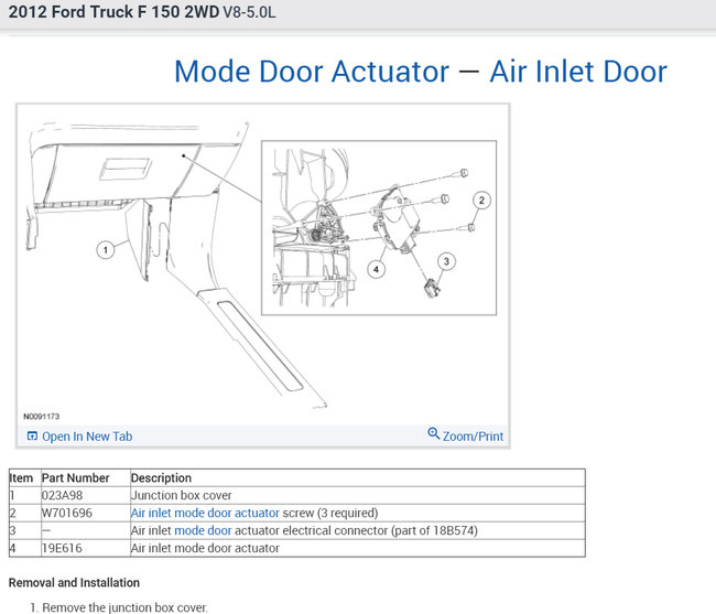

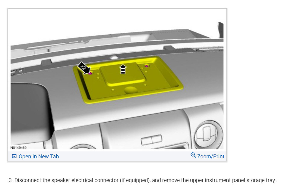

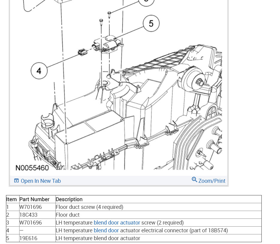

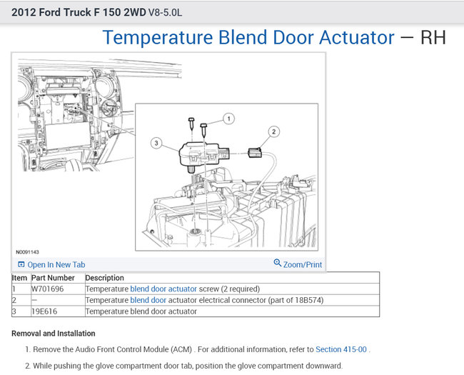

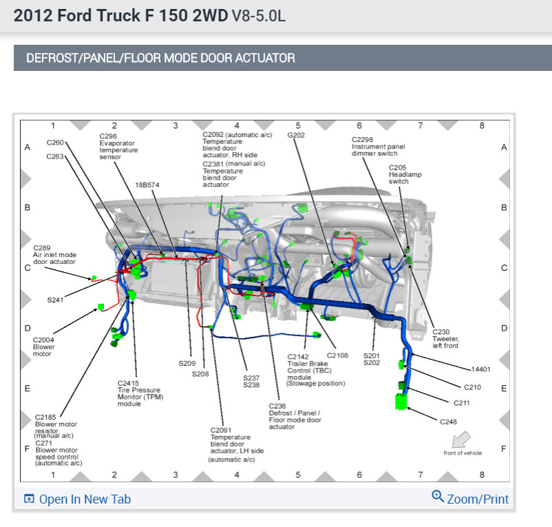

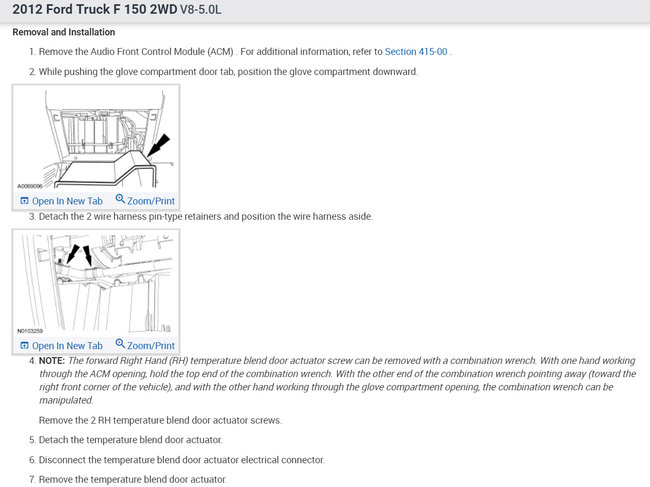

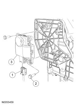

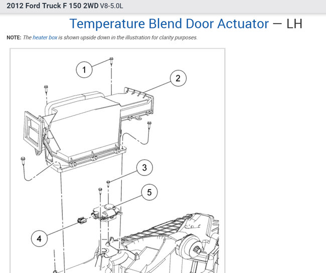

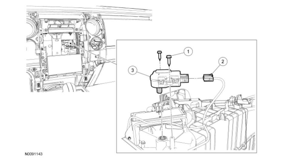

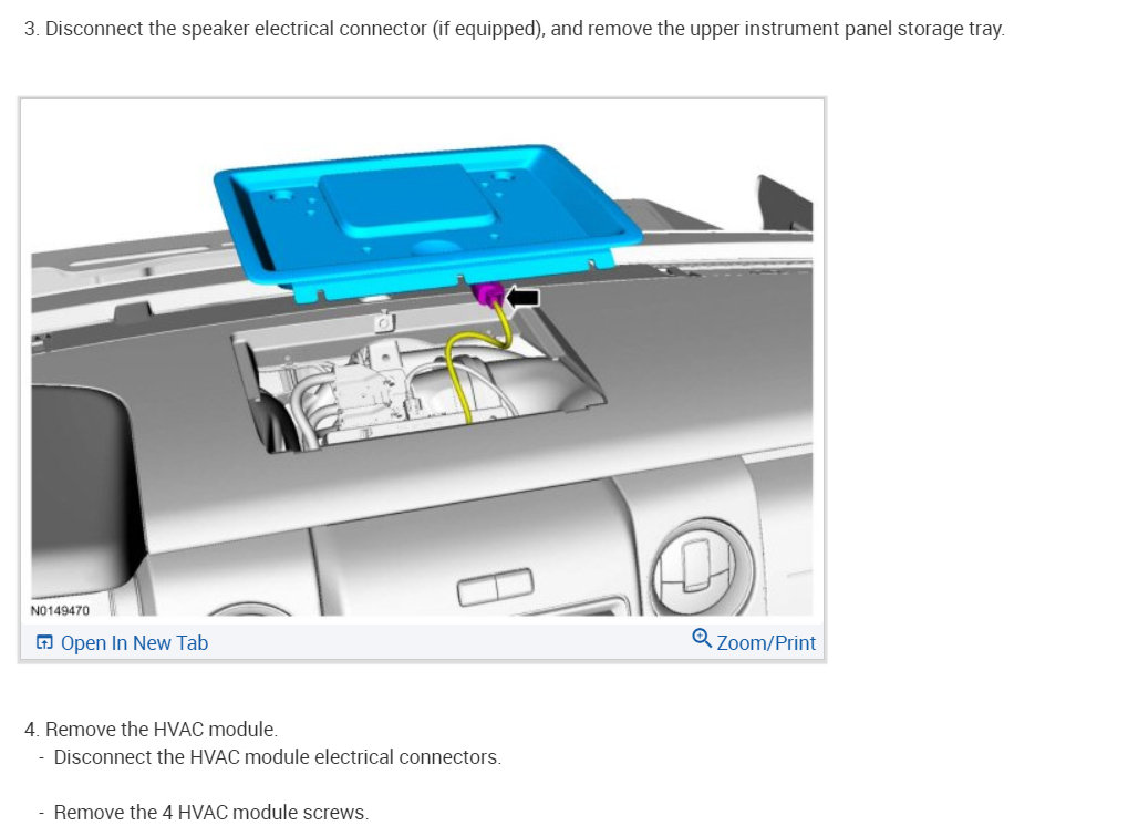

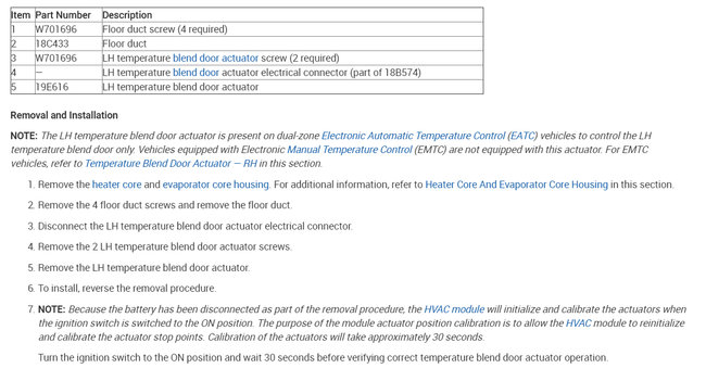

If I can jump in here. I would try to isolate the noise to the effected actuator and then replace it. Below are diagrams to show you the locations. Can you please shoot a quick video with your phone so we can hear the noise? that would be great. You can upload it here with your response. Check out the diagrams (below). Please let us know what you find. We are interested to see what it is.

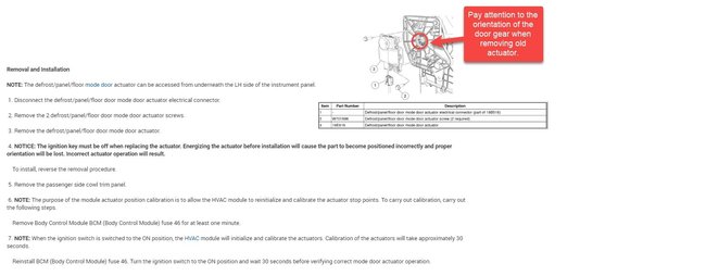

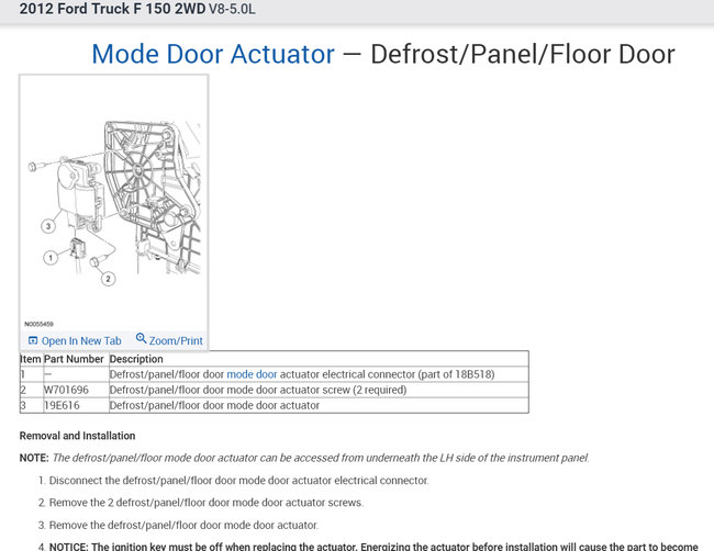

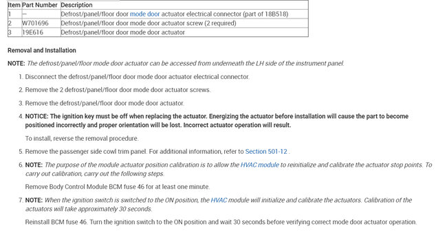

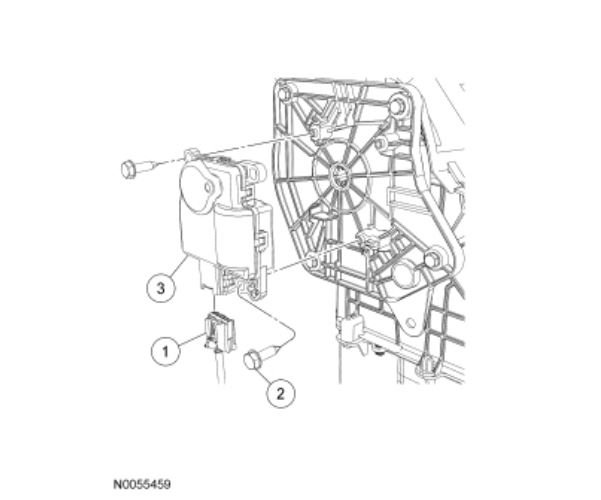

Good job on the video! This is the mode door actuator which is located on the driver side under the dash. You'll have to lay down and reach up to unscrew the 2 8mm bolts to remove the actuator, a pretty easy and straightforward job for anyone to do. After you install the new one, remove fuse #46 from the interior fuse panel behind the passenger kick panel for 1 minute then re-install it, this will recalibrate the actuator when you start the truck. I've attached a picture of the actuator for reference.

Thanks for the information and the reference picture. I will order the actuator and try to install it myself in a few weeks. I had surgery the day after I sent you the video and have just returned home, should be able to attempt the repair in about 3 weeks. Thanks for all of your help in nailing down which actuator to replace. You guys provide a great service for us DIY types.

I was able to replace the mode door actuator over the weekend and the problem is now resolved. The replacement took about 1 hour but would have gone faster if I had realized that I needed to manually rotate the mode door to get the actuator gear lined up with the mode door gear so the actuator would fit into place. Once I figured that out things went smoothly. Thanks again for all of your help.

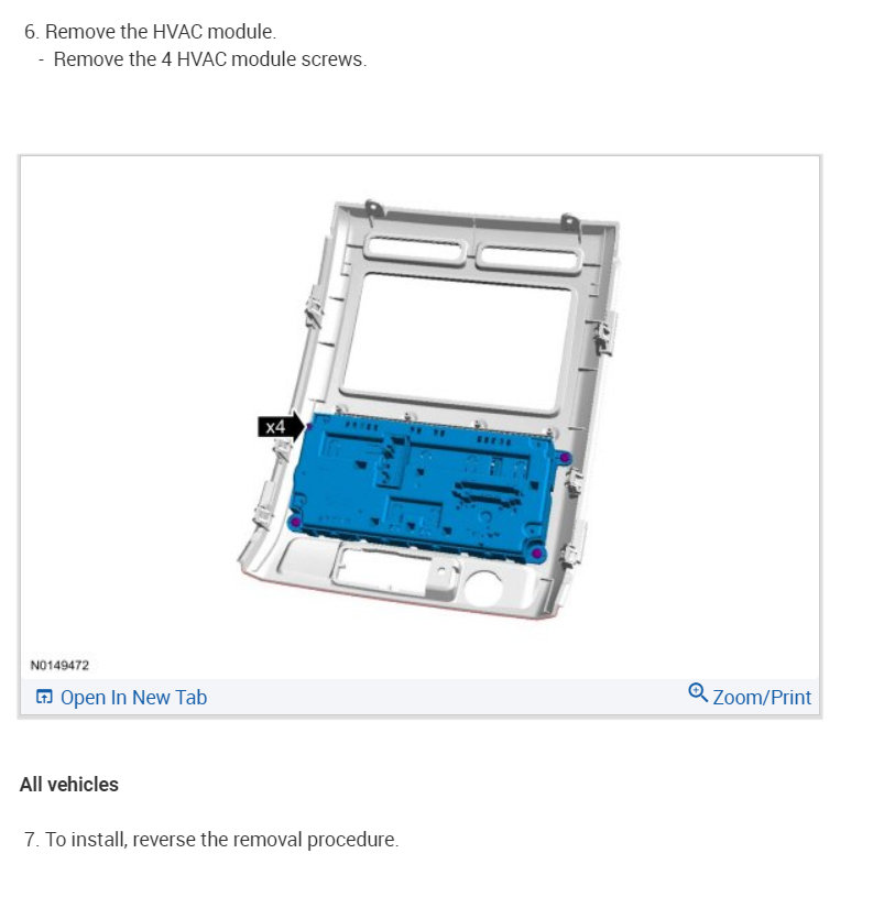

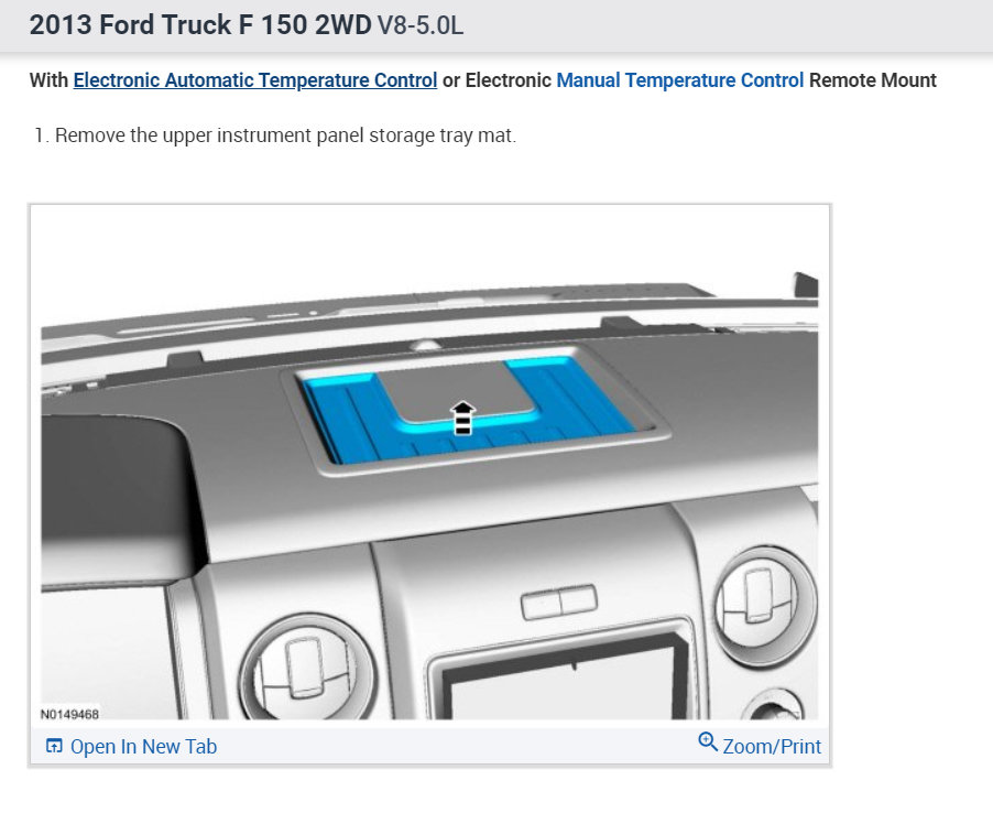

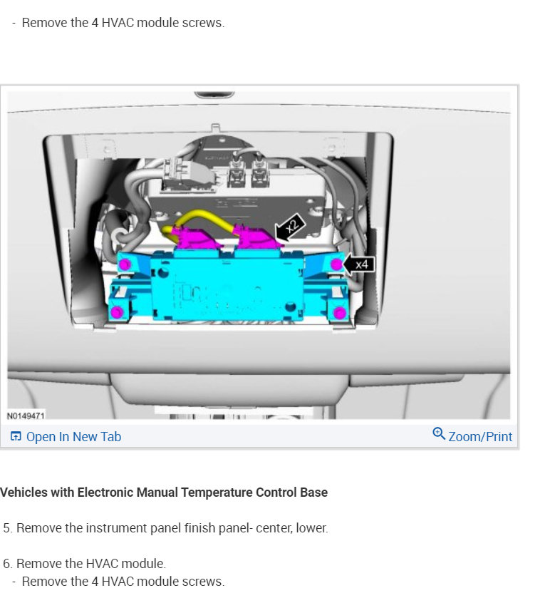

  • 55,389 POSTS
This happens when the control head goes out. here are the instructions on ow to replace it. You will need to get the part number off of it but here are some examples of cost.
Dash Control Unit
DL3Z19980D
$198.92
With Power Telescopic Mirror
Dash Control Unit
DL3Z19980E
$202.25
With Heated Rear Window
Dash Control Unit
DL3Z19980F
$203.08
Feb 24, 2020 at 2:46 AM

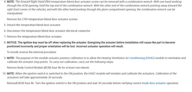

Sounds like a new mode door actuator is in your future. I have included the instructions. Check out the diagrams (below). Please let us know what happens.

Try commanding heat and cool and see if it gets louder or stops. Then try going from defrost to floor and vent and see if the noise changes. Check out the diagrams (Below). Please let us know what happens.
