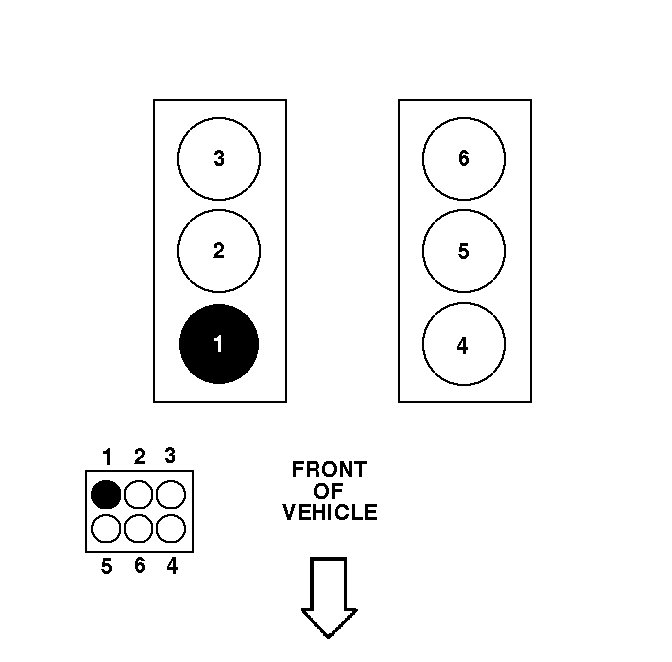

I recently changed my spark plugs and, when I started my car it would shake a lot. then when I finally put it in reverse and tried to drive it, the car would accelerate slowly and shake even more.What could I have done wrong?

You may have crossed the wires and they are not going to the right cylinders. I attached a picture of cylinder location and the firing order. Make sure that is correct. The firing order is:
Firing Order 1-4-2-5-3-6
Also, did you gap the spark plugs prior to installing them? Are any of the spark plug wires laying on the exhaust manifold which may cause them to melt and arc?
If you feel confident that the order is correct and plug gap was correct, you may have damaged the plug wires when removing, they may not be all the way on, or you may have disconnected a vacuum supply component or something on the air tube, so check that too.

I agree with JakobandNicholas. I see plenty of people make the 456 mistake! 123, 465 is the correct routing for the wires on the coil. If you have done this, I apologize! Any additional diag would be mechanical, i.e. valve train, bottom end.
