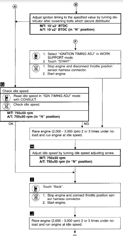

Need to know the exact position of the crankshaft pulley For ignition time
Sep 21, 2025 at 8:17 PM
  • 55,710 POSTS
Sure here is a guide to help you and the timing balancer so you can see what to adjust it to. Check out the images (below). Please let us know what happens.
