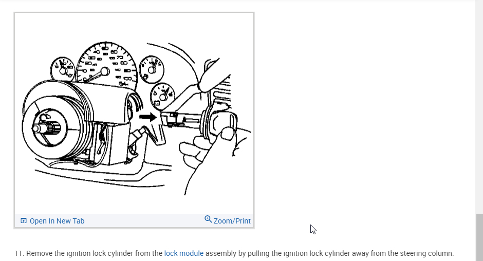

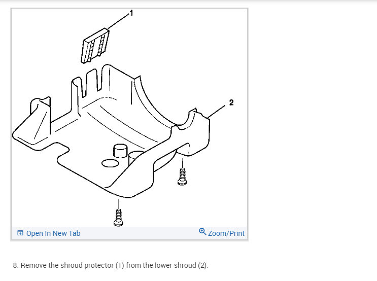

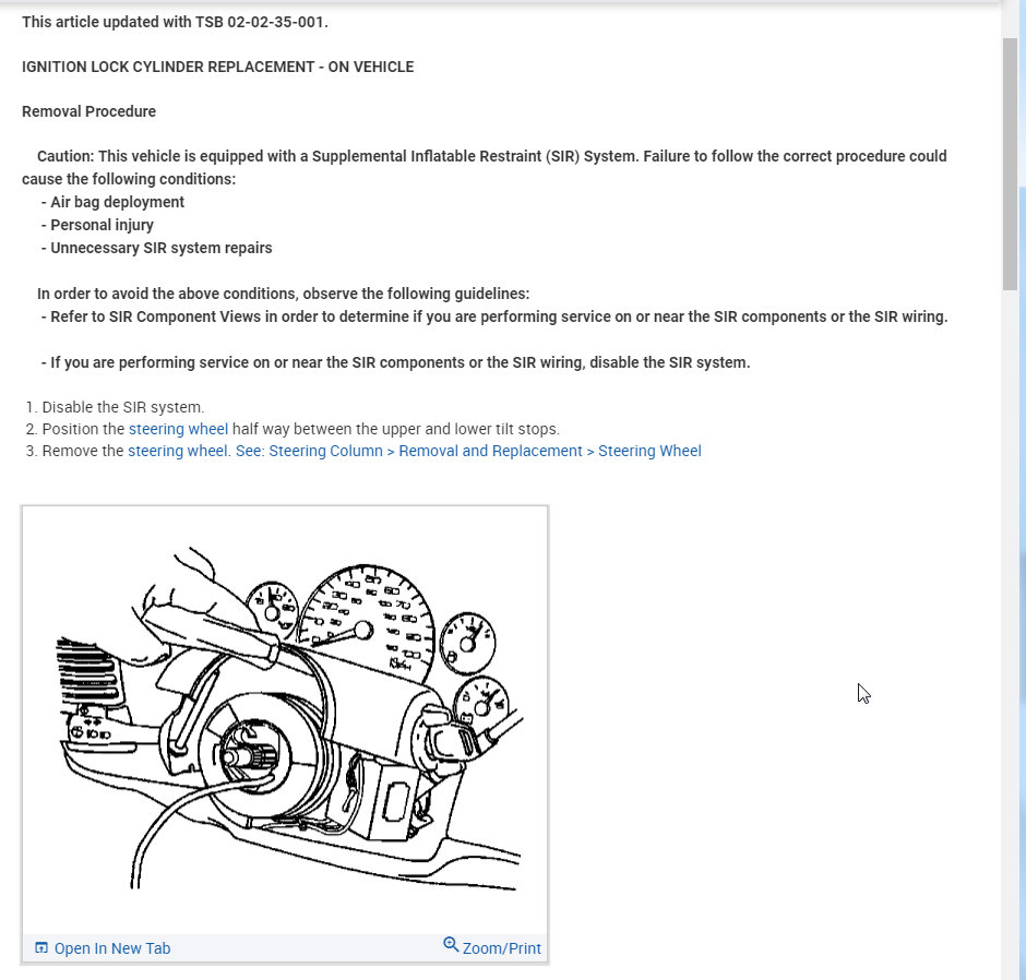

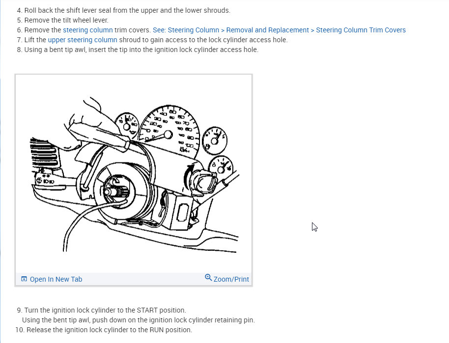

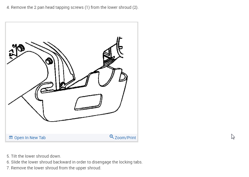

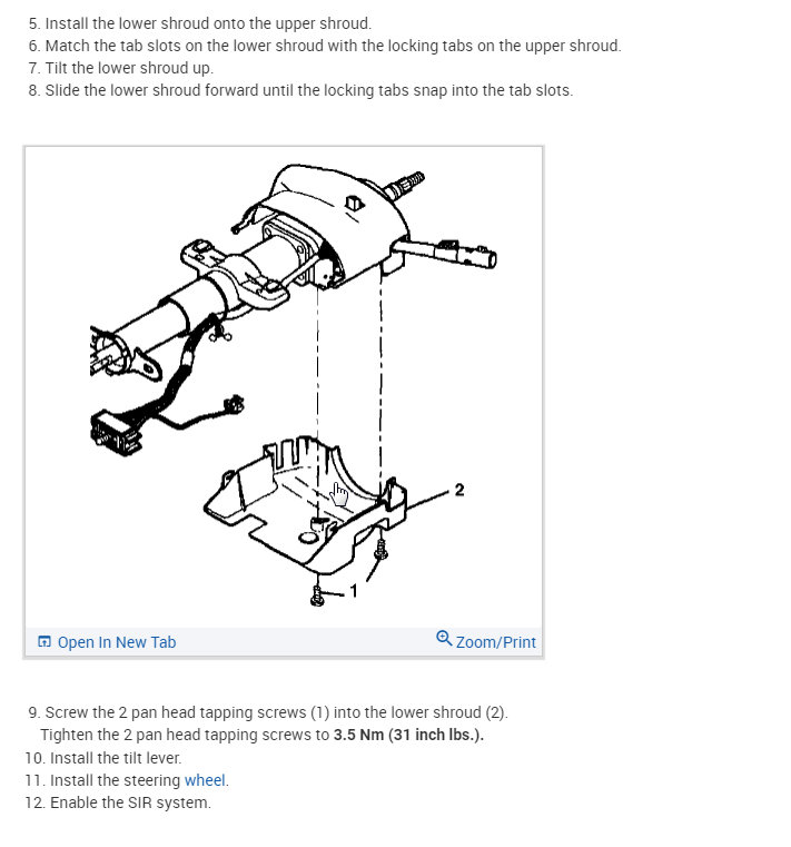

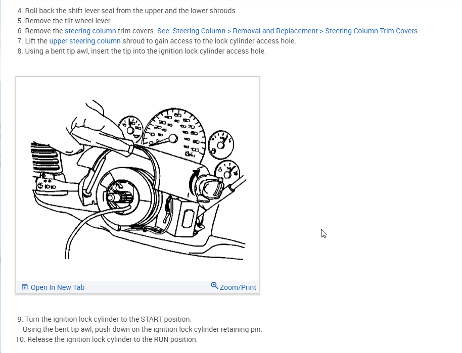

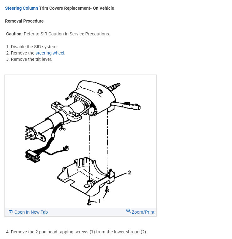

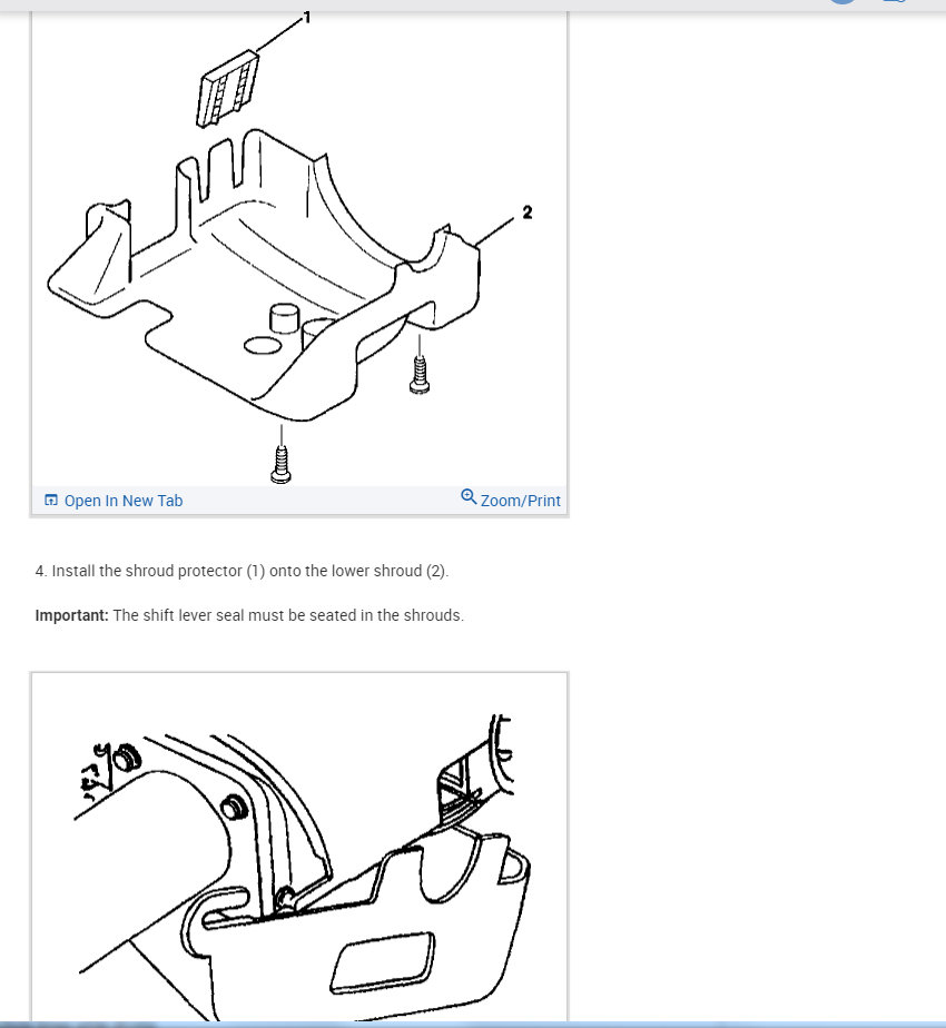

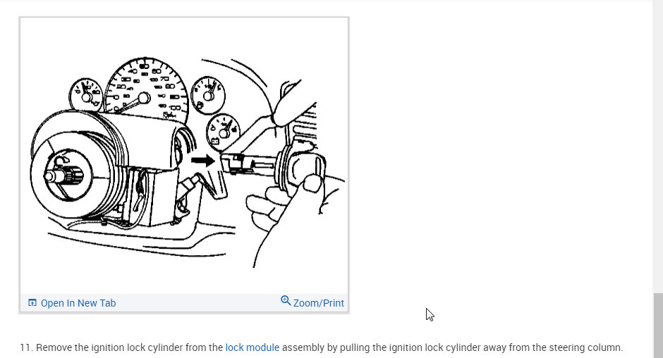

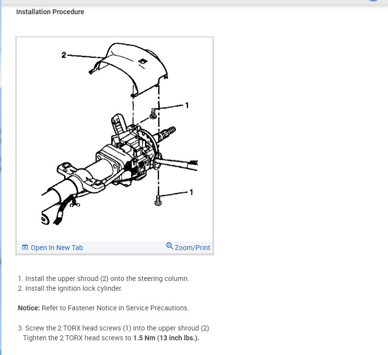

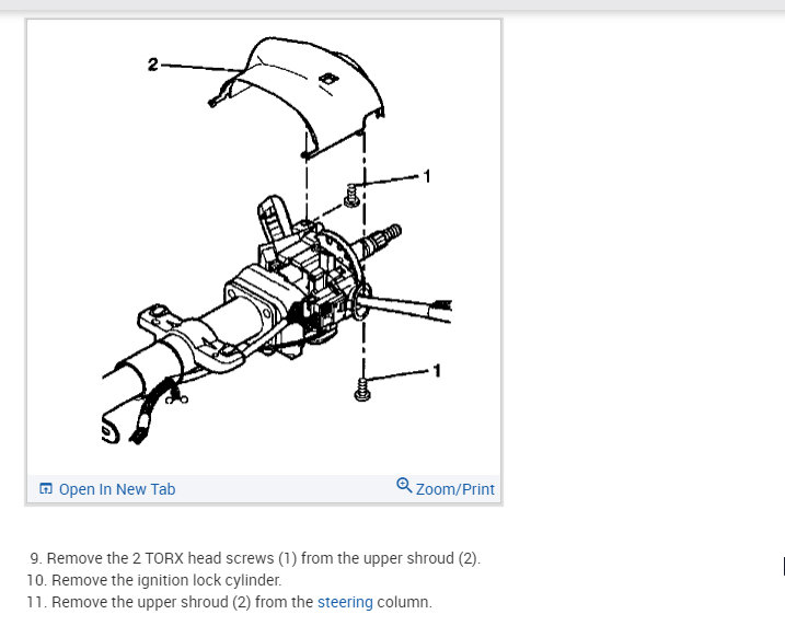

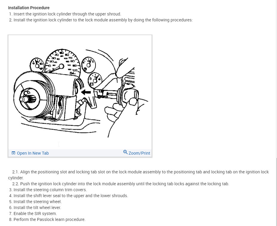

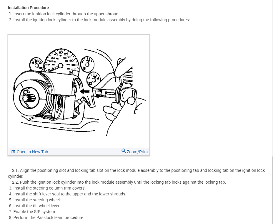

I am replacing the tumbler (key part of ignition switch) but cannot get the top cover off of the steering so I can get to the ignition switch. Also,the steering wheel adjustment lever must come off apparently but how do i achieve this?
Jan 22, 2020 at 9:39 PM
I attached the procedure for this. I am not sure where you are having issue but run through the procedure and see if you are missing something. More than likely there is a screw or clip that you haven't released yet.
Let us know if you have issues still figure out what it was. Thanks
