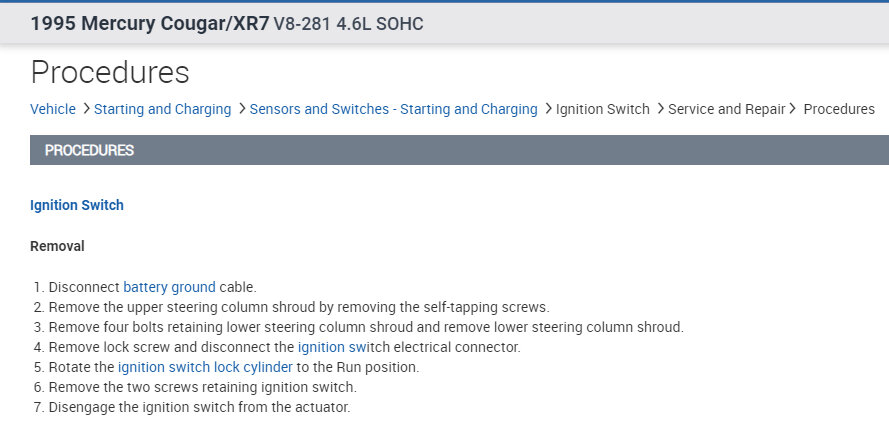

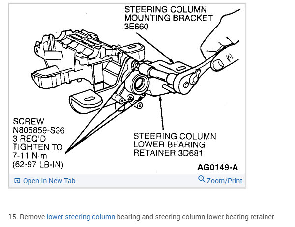

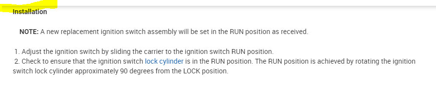

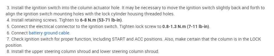

Based on the description, it does sound like the switch itself has failed. I understand that it still can start and run the engine, but that doesn't mean it isn't faulty.

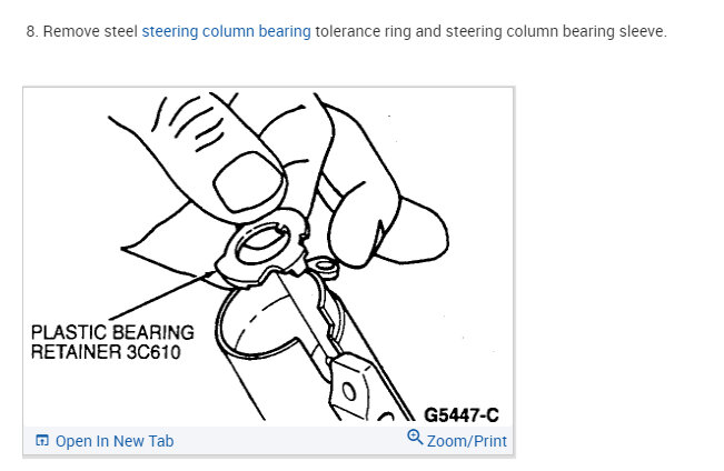

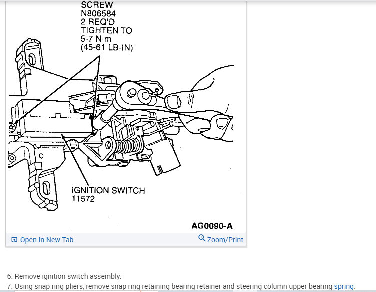

If you look below, I attached the directions for replacing the switch. I would recommend removing and inspecting it to see if there is an issue between the lock cylinder and switch or if the switch itself is worn.
Let me know what you find.

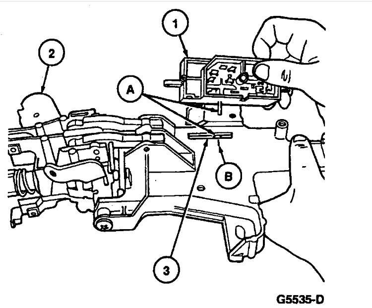

Hey Joe, thanks for the message. Was able to get the ignition switch removed and it is clear that the problem lies between the lock cylinder and the ign switch. The small plastic rod that connects the two has clearly snapped in the middle. Is this part no. 3e715 and do you have any additional information as to how to replace it? It looks like a significantly larger amount of disassembly may be required to get to that piece.

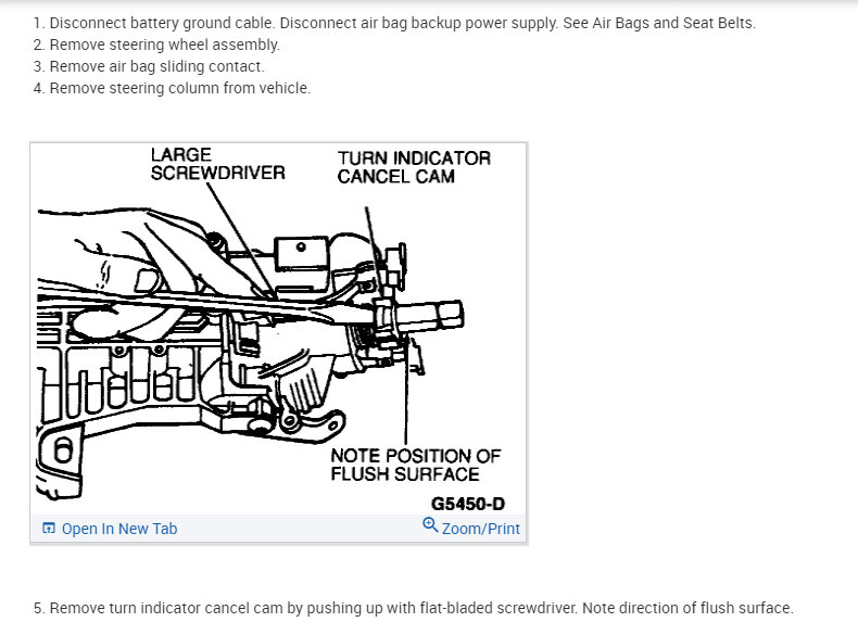

I can’t find much info on the lower rod, based on a quick search it looks like servicing this might require removing the whole steering column? These two plastic rods look fairly well encapsulated and enclosed in the metal column…

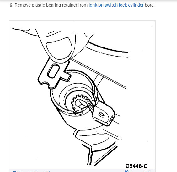

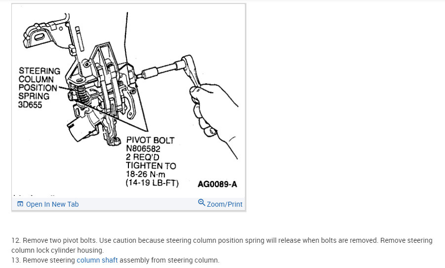

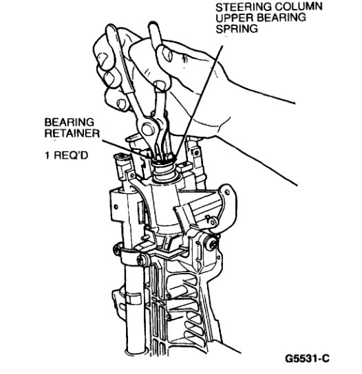

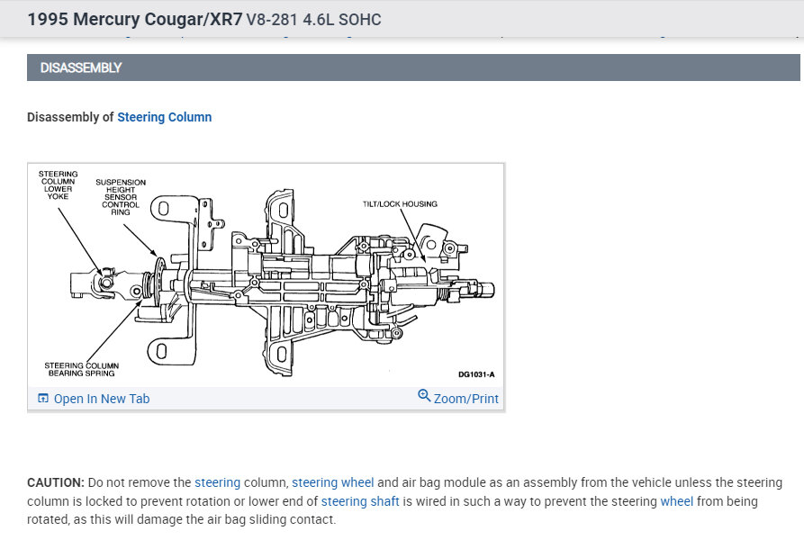

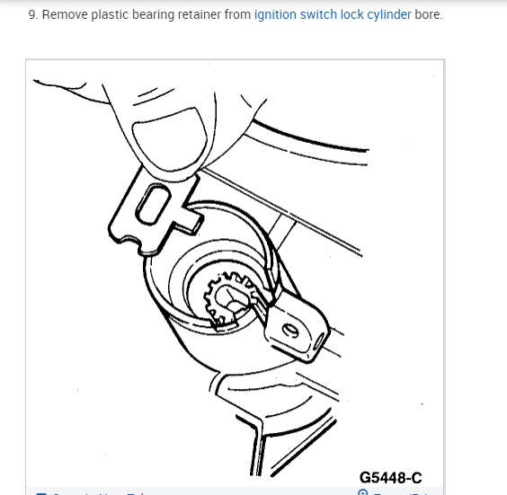

  • 110,244 POSTS

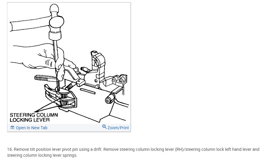

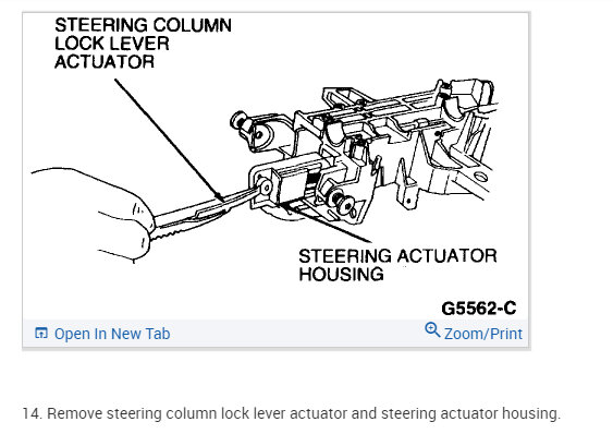

Unfortunately, they don't have directions specific to that part. However, I attached the directions for disassembling the steering column. Take a look through them and let me know if they help.

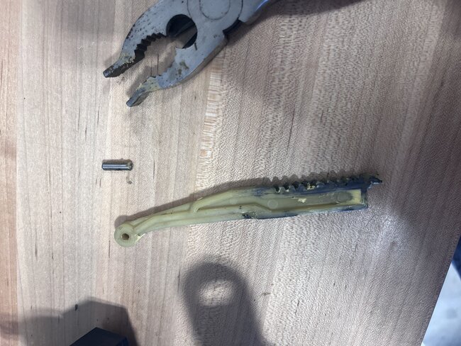

I was able to get it fixed, it was in fact the lock lever actuator. Thank you for the help and diagrams!
Aug 22, 2023 at 2:24 AM
  • 110,244 POSTS
Thanks for the update. I'm glad you got it taken care of. Looking at the pic, that thing looks well used. LOL
