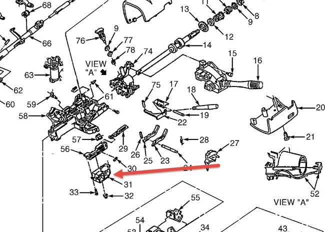

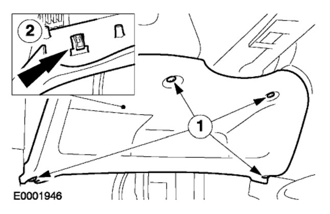

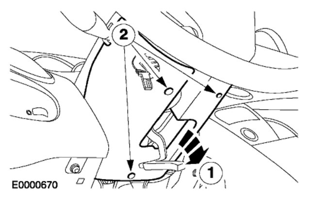

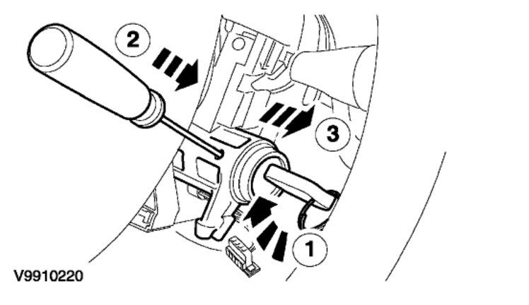

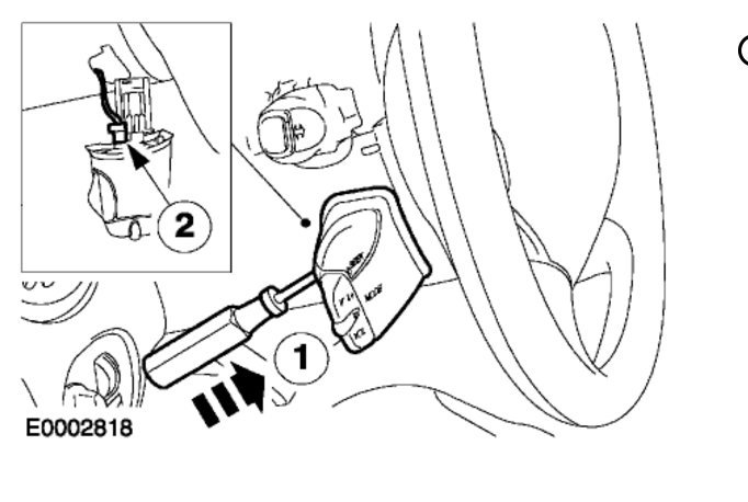

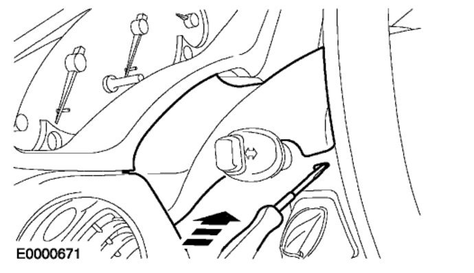

Here are diagrams to help you get started you will need to remove the steering wheel to access the ignition key. Check out the diagrams (Below) Please let us know if you need anything else to get the problem fixed. Cheers

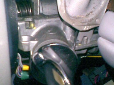

OK, hopefully this is it. Right behind the lock cylinder I can see this plastic square shaped rod that moves back and forth when the key is turned. The left part of that plastic piece is broken off. The ignition switch works. I can manually put the switch to the off position and turn it on using the key, but it won't move backward. Could that plastic piece be it. If so is it replaceable. Or does the steering column need to be replaced. Thanks again. (Hope this picture helps, it's the part with the yellow on it)
https://images.2carpros.com/forum/automotive_pictures/235026_Lock_1.jpg
May 14, 2020 at 6:25 AM (Merged)
DOCFIXIT
  • 18,828 POSTS
O.K. that plastic piece is it it will push rod forward but not retract so car stays on. Dealer item and am not sure but I think you have to buy the collar that houses tumbler steering lock. Just got in from work give me till mid AM and I'll post what I find out.

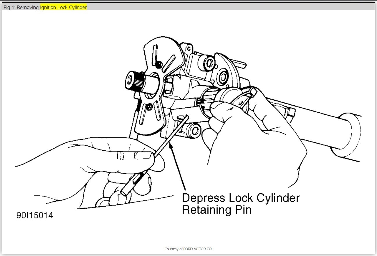

look under the steering wheel there should be a small hole under the key cycinder put a small alen wrench in put be gentle push the pin and pull cylinder out slow so you can see just how new one goes in and insert new cylinder

you should not have to remove any of it there should be a small hole you just put allenwrench in to and you should feel a small bump push that bump and you can pull cylinder out and then you need to make sure you watch how cylender comes out and put new one in untill you hear a click then cylinder is locked in place and your done but if you have to take cover off all you should need to take off is the bottom
