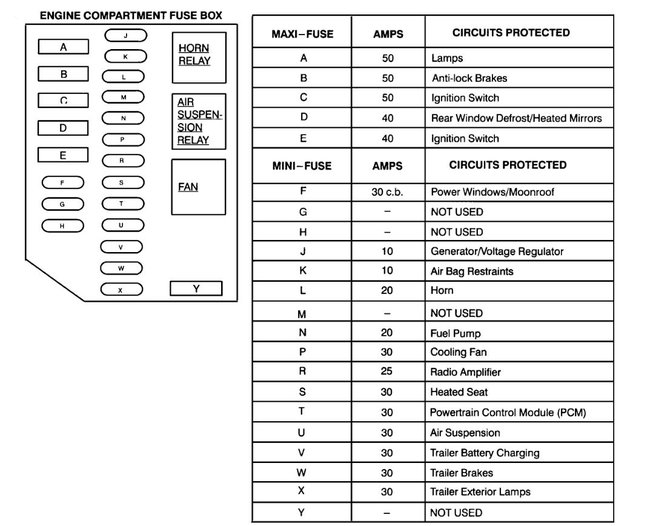

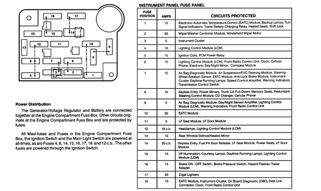

Since you didn't ask for a specific one, I have attached the under hood and interior fuse block diagrams
Test light is the best way to check fuses, see the guide below
Fuse block pictures are attached below,
let us know if you need anything else
