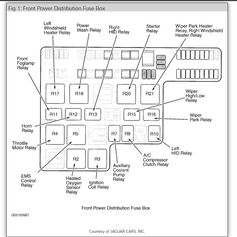

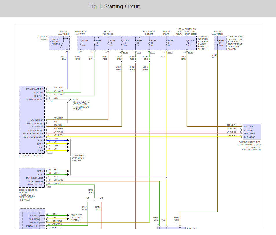

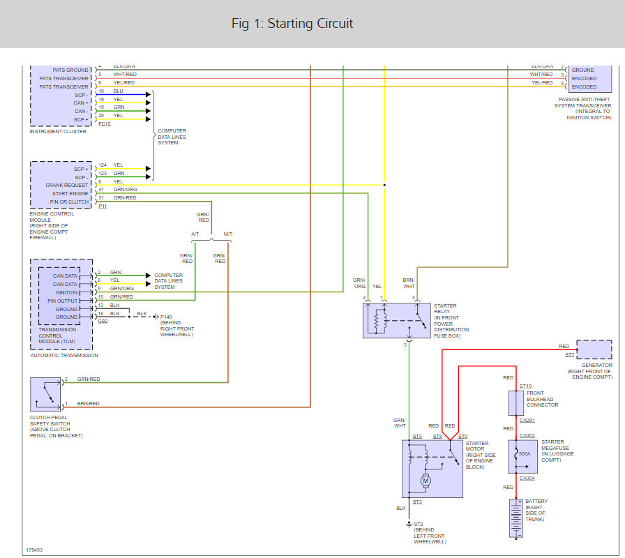

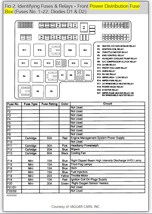

Hello good afternoon, I am not getting anything off the car ignition when I turn the key for the car to start, however when I use a screw driver to bridge the starter at the bottom of the car it starts. Do you know what Is causing that to happen? If yes can you give me a solution please? Thank you.
NB
Please note that the car is a crash car that I am trying to fix.
Aug 24, 2018 at 4:03 AM
  • 55,433 POSTS

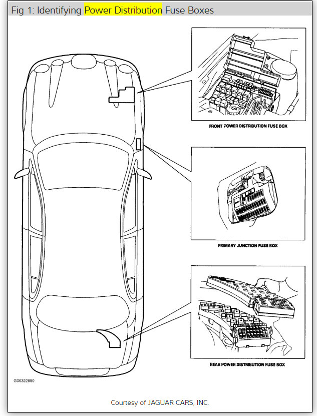

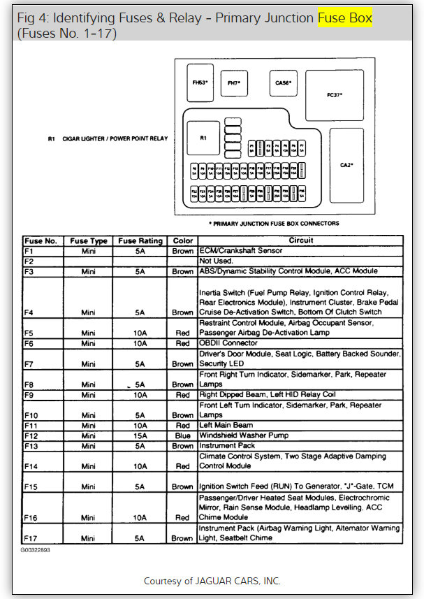

There is a starter relay in the front fuse panel that needs to be checked. Here is a guide to help us get started the relay location and the starter wiring diagrams so you can see how the system works:
Please check the fuses as well.

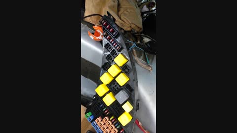

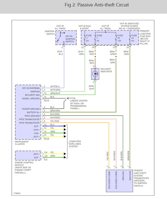

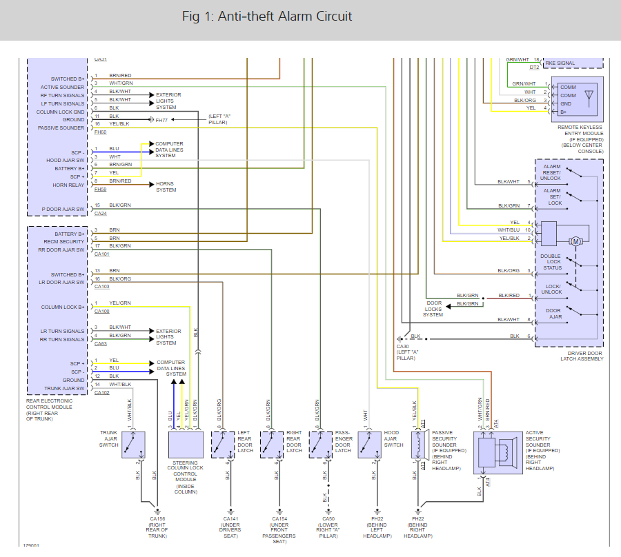

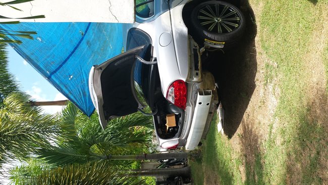

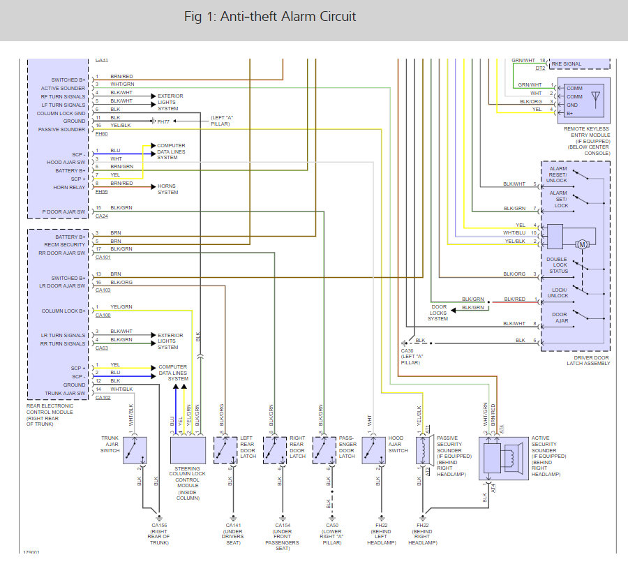

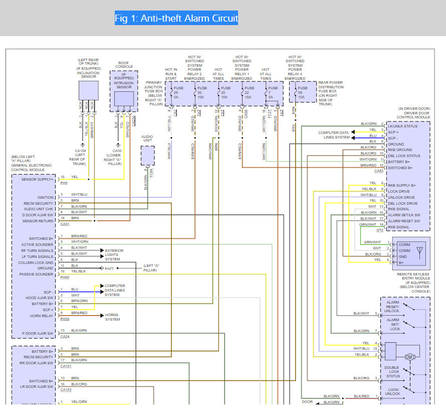

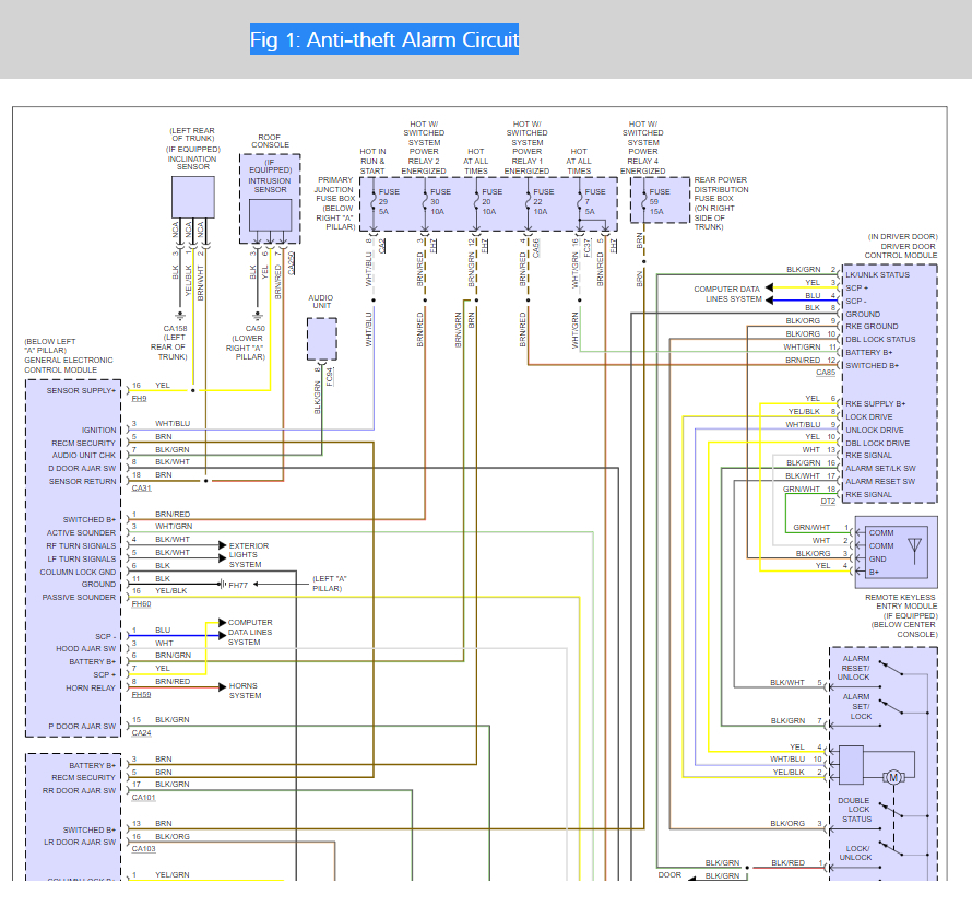

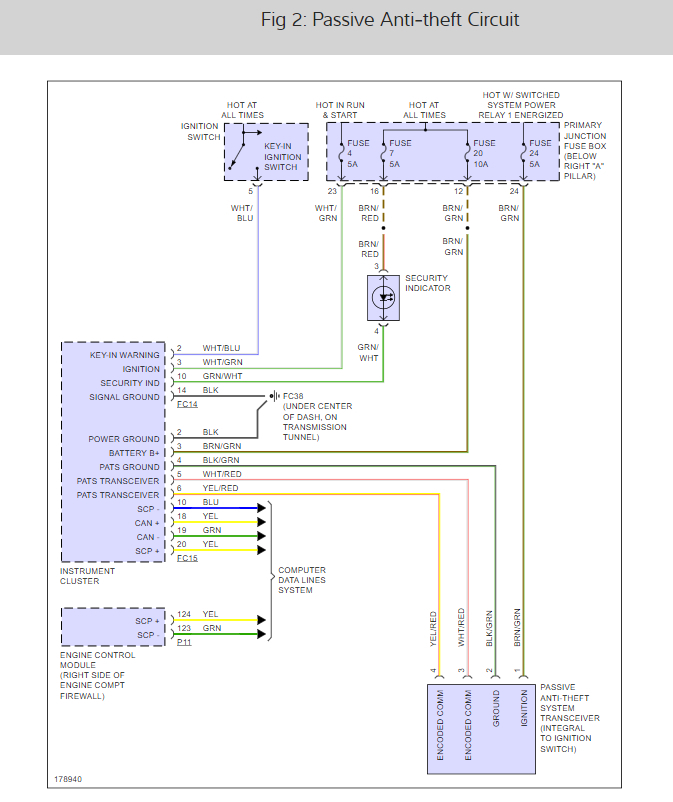

Hello, this is a follow up question from the one that I posted before. So I checked all the fuses and they are okay. The battery in the car is a new working one. The car is still not cranking or starting. However, the security system/alarm system is not working. Can you tell me how to get it working again? I think that is causing the vehicle to not crank or start. What are your thoughts? Please help. Thanks.
Aug 29, 2018 at 3:36 AM
AUSTINO
  • 228 POSTS

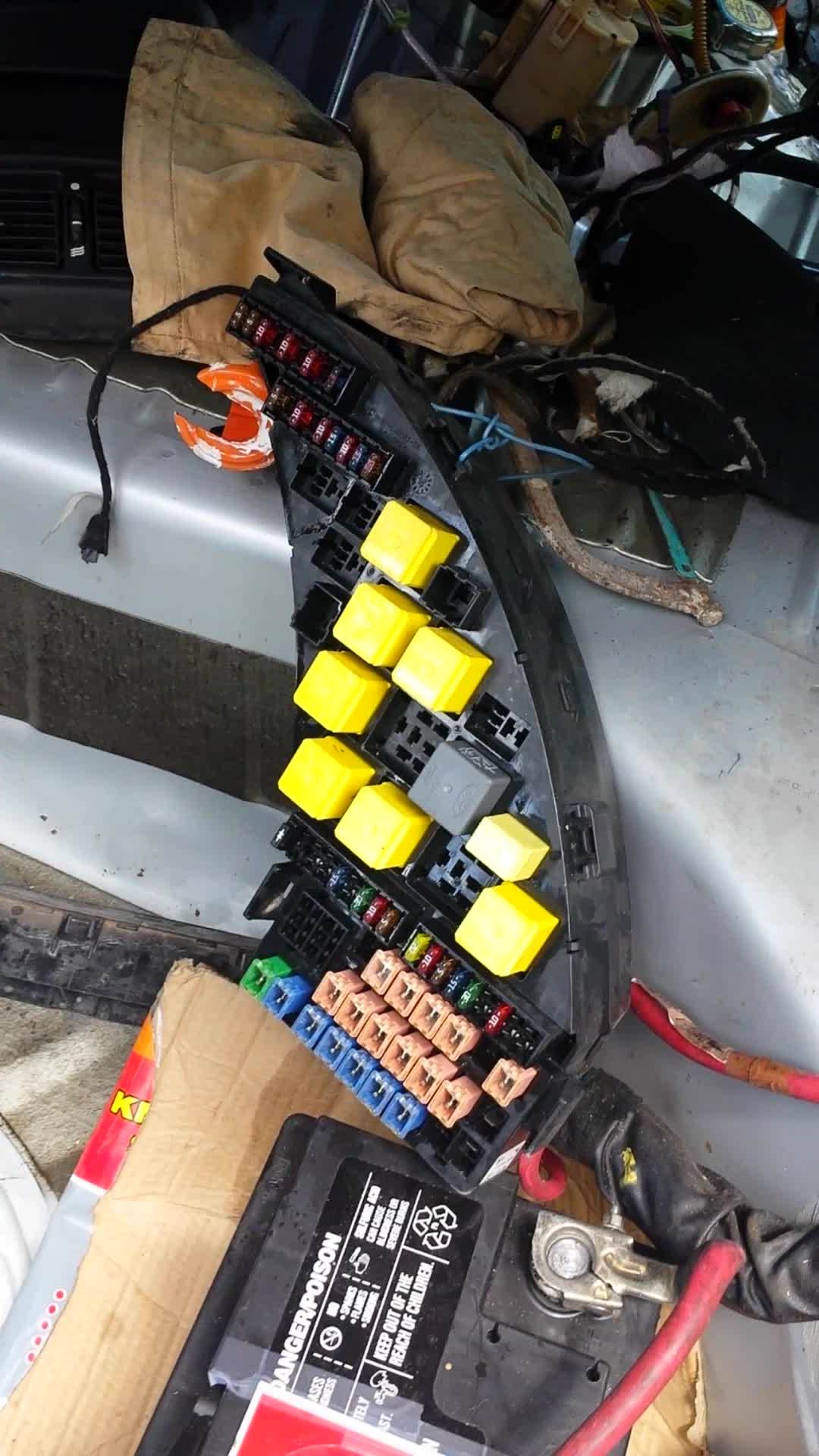

Ken, I did ask this question earlier in the" Ask A Question box". I also added a video and picture of the car. Do you think you can find it please?
Aug 29, 2018 at 3:39 AM
AUSTINO
  • 228 POSTS
Hello, this is a follow up question from the one that I posted before. So I checked all the fuses and they are okay. The battery in the car is a new working one. The car is still not cranking or starting. However, the security system/alarm system is not working. Can you tell me how to get it working again? I think that is causing the vehicle to not crank or start. What are your thoughts? Please help. Thanks. See images or video of the vehicle below please.
Aug 29, 2018 at 8:31 AM (Merged)
  • 55,433 POSTS
Thanks for the video. We need to go over the power and grounds for the security system to make sure it is working. Here is a guide and the wiring diagrams to help you see how the system works and where to test:

Hello , I checked and the security /alarm system is not working, can you tell me how to fix it please ? Thanks
Aug 31, 2018 at 12:49 AM
  • 55,433 POSTS
Can you tell me if the security light is flashing when you crank the car over?
Aug 31, 2018 at 5:26 AM
AUSTINO
  • 228 POSTS
I bought the car from someone crashed so I am just trying to repair it, so as a result I don't know which light is the security light.Can you help me to identify the security light please?
Aug 31, 2018 at 7:53 AM
AUSTINO
  • 228 POSTS
Do I have to program the remote for the car before it can start the car? Just wondering. Thanks
Aug 31, 2018 at 8:12 AM
  • 55,433 POSTS
Yes, you do need to program the remote to the car which a shop or dealer must do.
