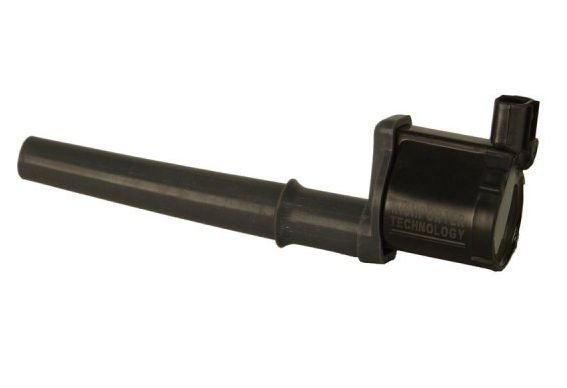

i need to know where the ignition coil is located. All the diagrams I have seen on the internet are all different.

There are eight individual coils, one for each plug. They look like the one pictured. If you have no spark at all the coils they all receive power on the red with light green stripe wire from fuse number eleven in the central box. The anti-theft system can shut them down as well.
