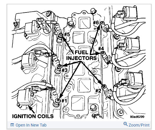

Your engine has what is called ignition coil on plugs. That means each spark plug has it's own coil. So how did they confirm that the coils are not getting spark? Did they remove one and hold it against the block and crank the engine?

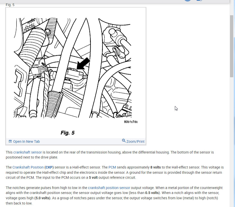

If the engine was running prior to this then we need to check and make sure they didn't unplug the crank sensor or something else related to the ignition.

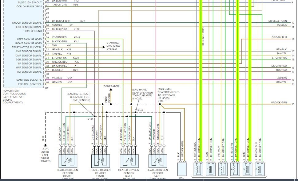

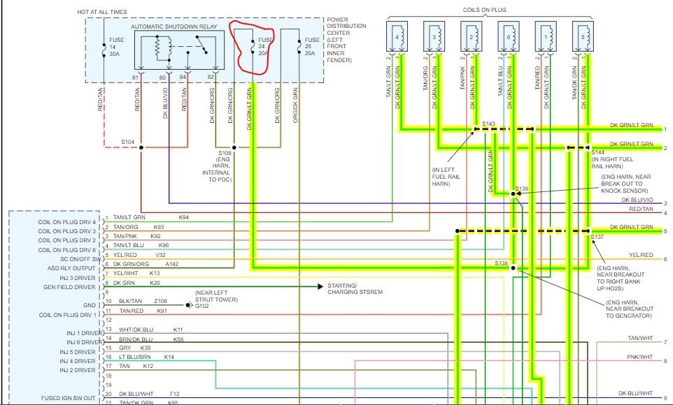

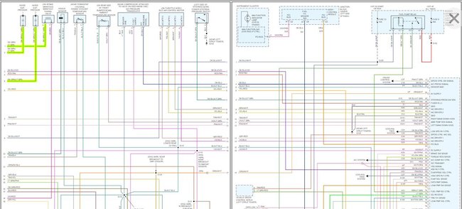

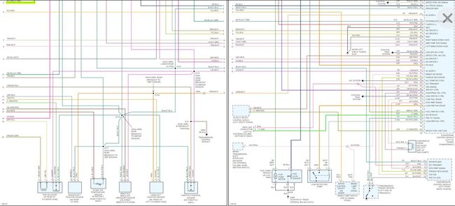

Good evening,
I attached a wiring diagram for you of the system.
Did they verify power to the fuse I circled on both sides?

Okay, so I just talked to him again the engine was running before the coils are all brand new. he said he read something about unplugging the crank sensor and plugging it back up and it might fix the problem, it didn't. he said everything is put together hooked up the way it should be, so I'm assuming it is a wiring issue or maybe another component. I'm honestly not sure I asked about the fuses he told me that he checked every one of them, so I'm assuming that means both sides.

Okay, did he check for power to the coils?
The fuse test was not a visual test, it is a power test.
