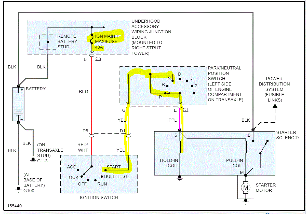

Actually, power from the starter doesn't go to the ignition switch. Power from the ignition main maxi-fuse sends power to the ignition switch. When the key is in the start position, power from the switch goes to the park/neutral switch. If the transmission is in park or neutral and the sensor is good, power then goes to the smaller wire on the starter (purple in color).
So, there should be a heavy gauge black wire at the starter motor that has 12v at all times. With the key in the start position, the purple wire should get 12v which engages the starter.

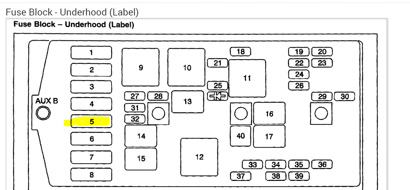

Reconfirm the fuse indicated in the pic below is good. Also, make sure there is power to it. Here is a link you may find helpful:
If the fuse is good, see if it will start by placing the transmission in neutral. Also, confirm the gear indicator light shows the correct gear position.
If everything checks good and the starter still doesn't engage, have a helper turn the key to the start position while you check if the purple wire at the starter gets 12v. Again, it will only have power in the start position. Additionally, reconfirm that the heavy gauge black wire has 12v at all times.

See pics below. Pic 2 shows the fuse to check.

Did you check if there was power to the purple wire on the starter with the key in the start position? Also, is the fuse I indicated above the one that is failing?

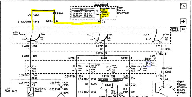

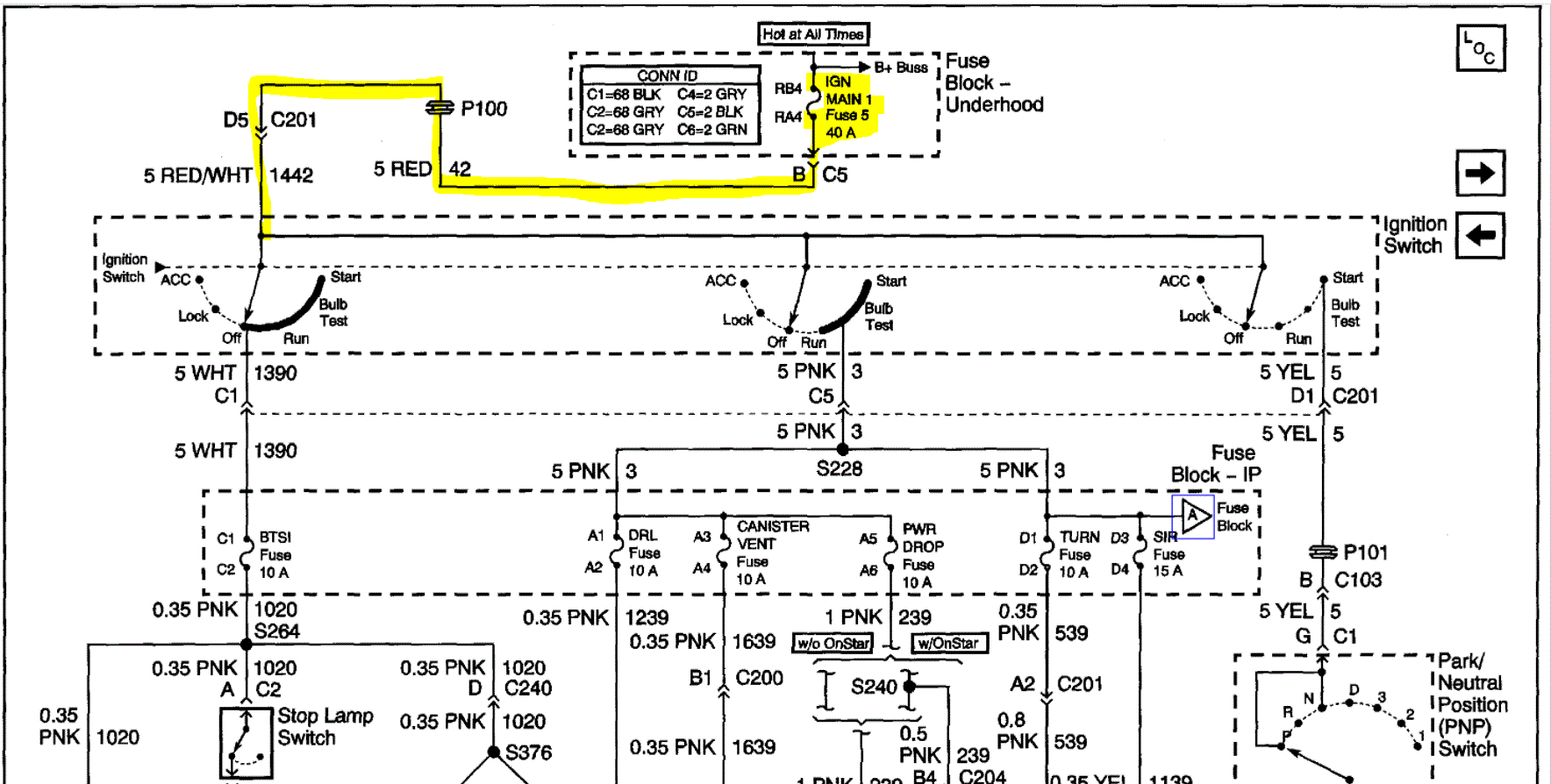

Okay, that tells me you have a short to ground on that specific wire. If you are providing power to that wire and it lights the tester, the opposite side of that wire has to be providing a ground. Otherwise, the light wouldn't turn on.
If you look at the first pic I attached above, you will see the red wire runs directly to the ignition switch. So, either there is a short between the fuse panel and the switch or the switch is bad.
Here is what to do: The next thing I would do to confirm this theory is accurate would be to check for continuity between the red wire and the negative battery terminal. If there is, then we know that wire is shorted.
You will need a multimeter to perform this. If you don't have one, then we need to first disconnect the battery and then disconnect the wiring at the ignition switch. Once it is disconnected, reconnect the battery and install a new fuse to see if it still fails. If it doesn't, it sounds like the switch is bad. If it does fail, the problem is at some point in the wire itself.
I found an OEM wiring schematic for this and highlighted the wire in question, so you have a reference to what I'm suggesting.

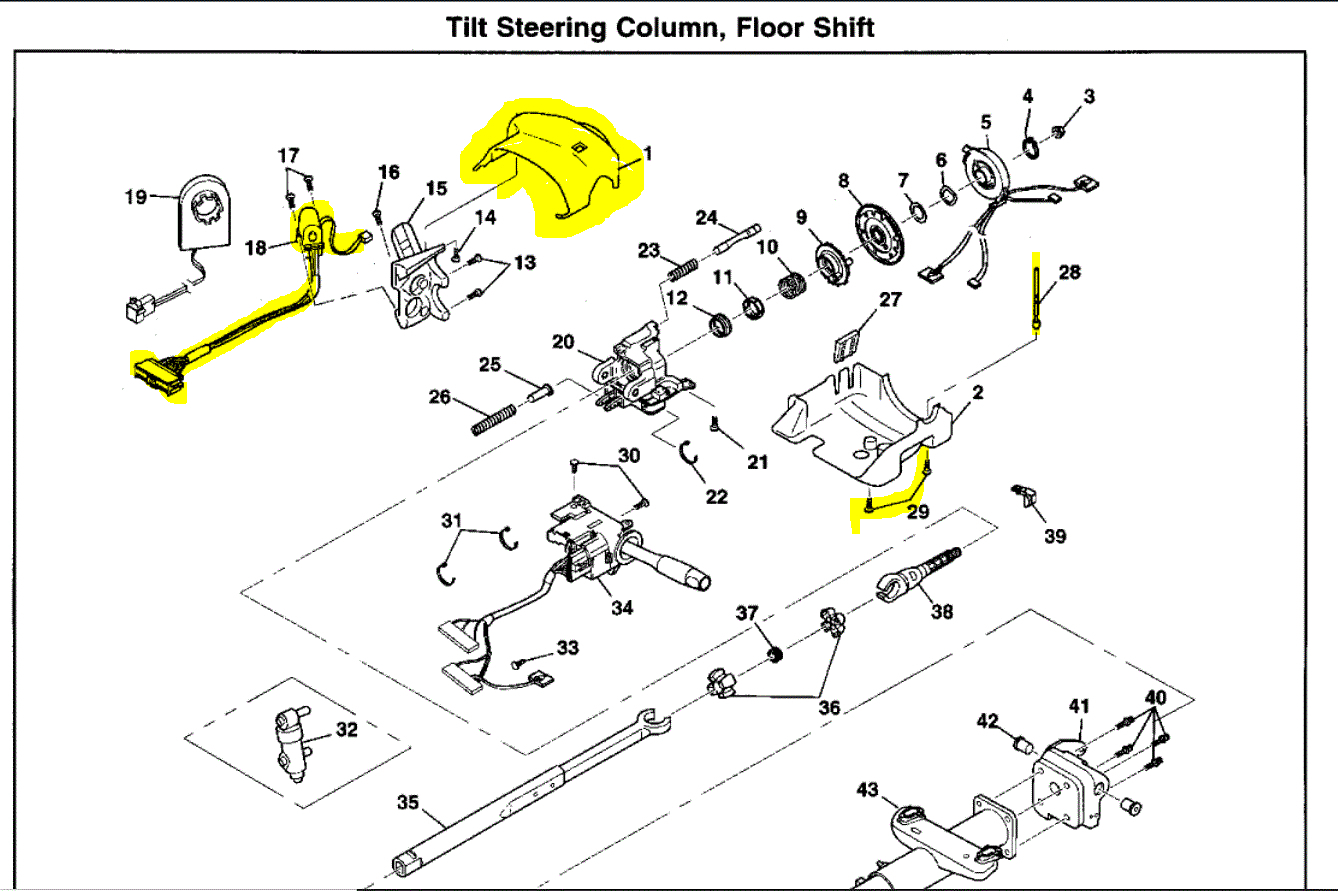

Pic 2 shows the switch and wiring. Both the upper and lower trim covers need to be removed. Before you do this, make sure the battery is disconnected for at least 30 minutes because you will be working around the wiring related to the airbag.
Let me know what you find or if you have questions.
See pics below. Note: Pic 2 shows the wiring. Both connectors from the switch should be disconnected for the test.
