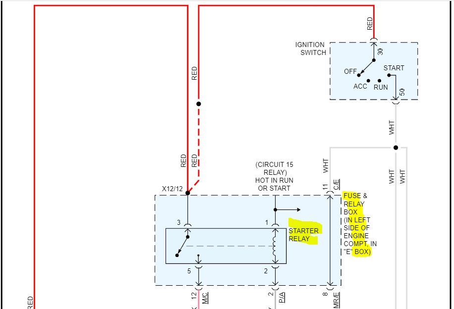

I was on the highway and my car ran out of gas, Tripple A came and put gas in my vehicle, but my battery had drained, otherwise the flashers on. They proceeded to give me a jump start it started for about 5 seconds and when I gave it gas it stalled out. now the vehicle won’t turn over even if it’s jumper cables. Hooked up. On the dashboard a message appeared saying start error can you please help also. The day before I heard this loud clicking noise and hole parked and. The vehicle was off it clicked. 5 times and stopped.
Nov 2, 2022 at 4:03 AM
  • 110,244 POSTS
Where was the clicking sound coming from? Was it outside the vehicle, the engine compartment, or was it from the interior?

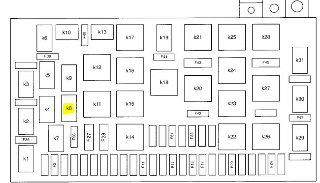

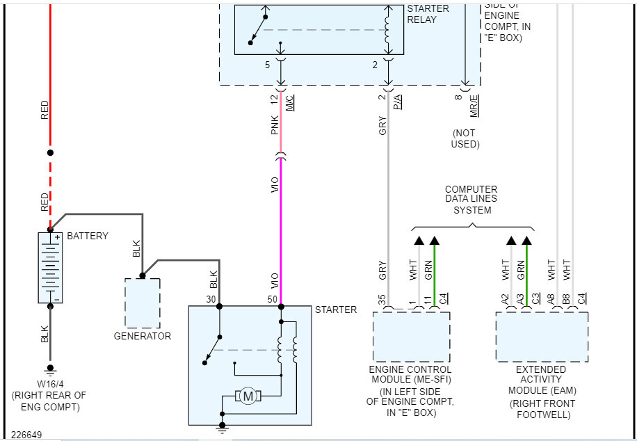

You may have a starter relay that has failed. I attached the wiring schematic specific to the starter motor. I need you to locate the fuse/relay box under the hood and check the starter relay, if there is another code relay with the same part number, switch them to test. If there isn't, here is a link that will help you test the relay:
Let me know what you find.
