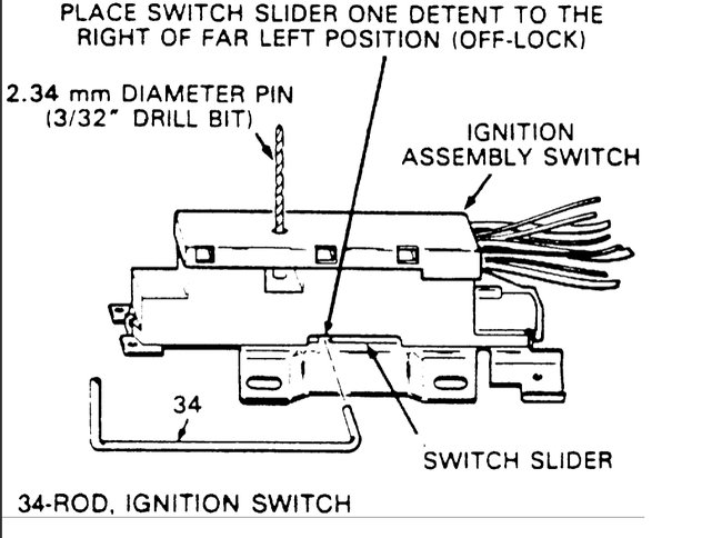

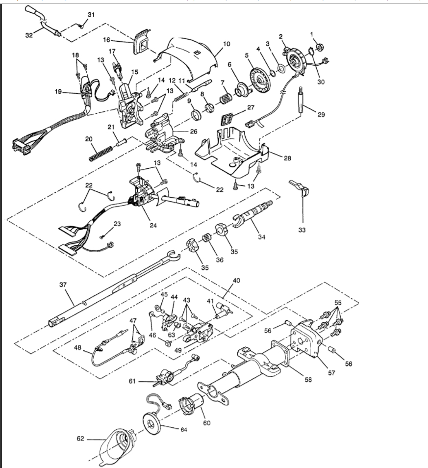

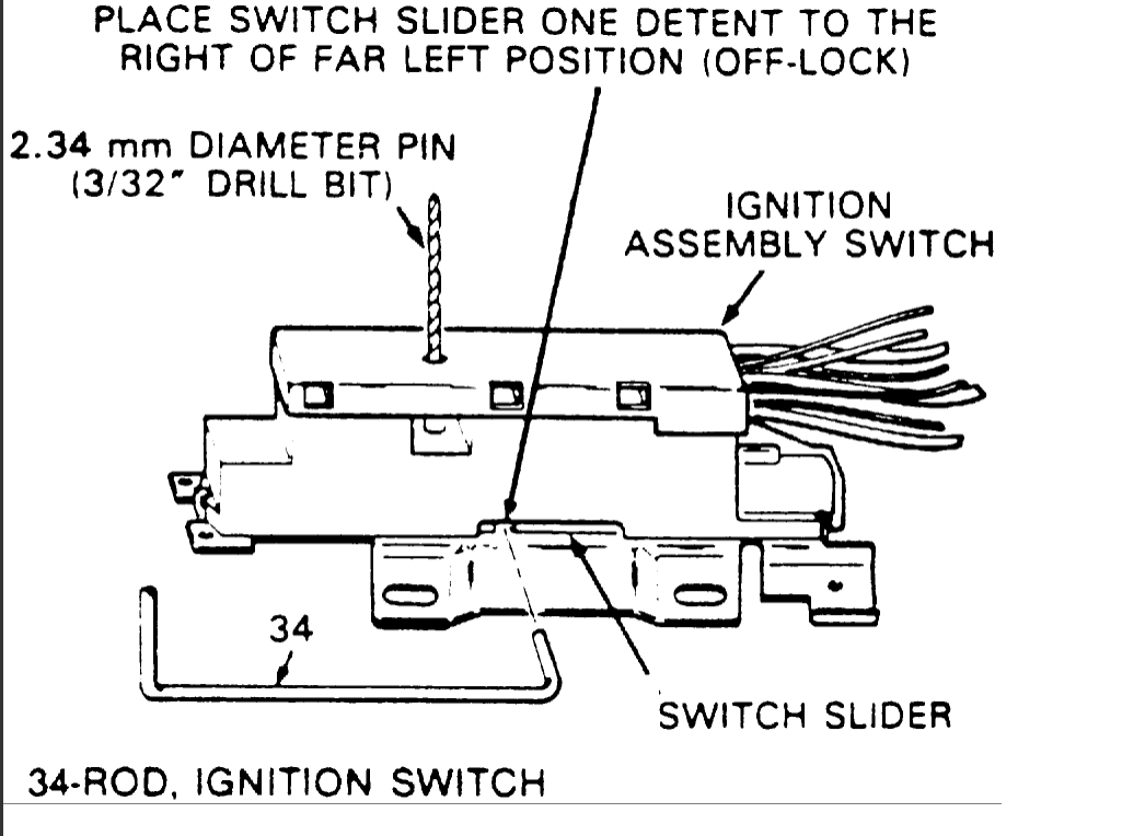

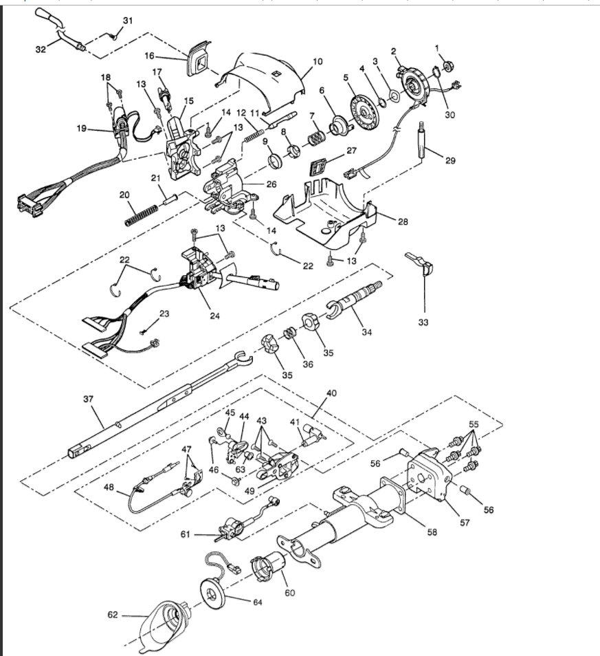

How to remove the ignition and the key switch? the car starts runs for a couple seconds then shuts off every time it is started. We've checked everything fuel pump its like the security is shutting down the fuel pump is that possible or u think its a bad connection sorry need advice on how to remove the ignition also.
Aug 15, 2017 at 11:04 AM
  • 55,766 POSTS
It does sounds like the ignitions witch is bad which is located down on the column on the top side.
Here is a diagram to help you see what I am talking about (below):
The key and tumbler will be a little tougher, here is the diagram for that as well.
