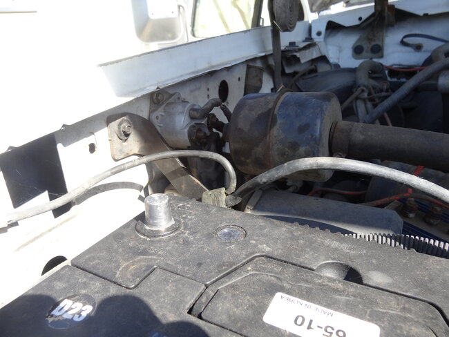

This is the relay behind the battery, correct?
Sunday, May 14th, 2023 AT 4:58 PM
KEN L
  • MASTER CERTIFIED MECHANIC
  • 48,363 POSTS
Yes, that is the starter solenoid.
Monday, May 15th, 2023 AT 9:57 AM

When I checked the starter solenoid the small wire while cranking there was no signal test light did not go on. I checked the large wire on the starter from the battery and I had voltage to the starter.
Tuesday, May 16th, 2023 AT 4:49 PM
SISTO27
  • 26 POSTS
I need to check that solenoid of the picture I sent you, right?
Tuesday, May 16th, 2023 AT 4:51 PM
SISTO27
  • 26 POSTS
I already took that solenoid off took jumper cables hooked negative to frame of solenoid positive to the small post on top of the solenoid and I can hear it open and close, but I did not check the amps with a meter.
Tuesday, May 16th, 2023 AT 5:00 PM
KEN L
  • 48,363 POSTS
If you hear the solenoid working check the power to the starter when in the crank position and if there is none replace the solenoid. Please referrer back to the previous page.

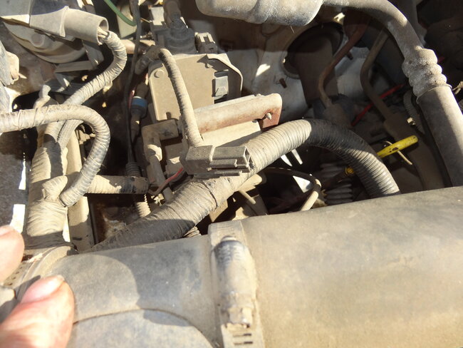

Ken, there was a wire next to the coil that connects to some ceramic resistor that's bolted to the frame. The wire comes out of that plug and if you look directly under the red wire you can see where the wire is the wire looks like it may of gotten hot if that's possible what is that wire for a ground.
Wednesday, May 17th, 2023 AT 10:24 AM
SISTO27
  • 26 POSTS
Ken, I found the problem, it is the neutral safety switch, so I am going to change it now. I unplugged the harness coming from the ignition going to the neutral safety switch put the key in crank position and got 12v at te plug, then I plugged it back in went to the relay switch by the battery nothing so I took the new neutral safety switch and plugged it in went up to the relay and now I have 12v so I am changing the switch now and get back to you.
Wednesday, May 17th, 2023 AT 12:38 PM
SISTO27
  • 26 POSTS
Let me know about that small wire by the coil what that is going too. Thanks
Wednesday, May 17th, 2023 AT 12:39 PM
KEN L
  • 48,363 POSTS
The small wire goes to a noise suppressor for the radio. Let me know if the neutral safety switch fixes it.
