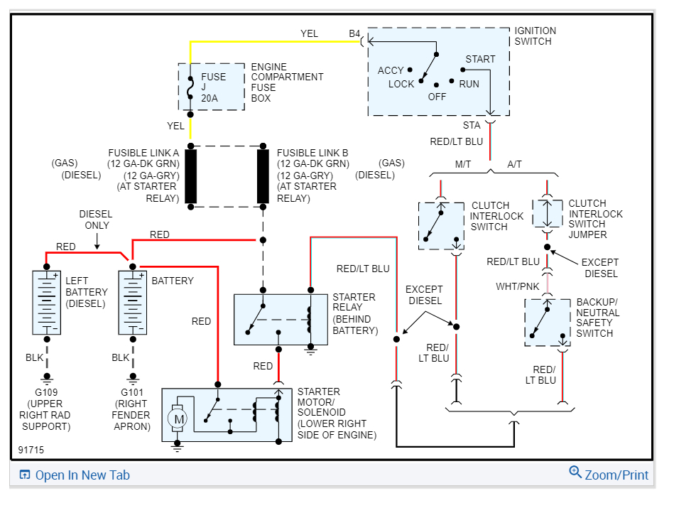

Okay, see if the engine will start in neutral. here is the starter system wiring diagram so you can use a test light to see where you lose power.

Ken, I took off the plug to the neutral safety switch I made a jumper wire and jumped the white and pink wire from the ignition to the light blue and red wire going to the starter and the motor cranked over.

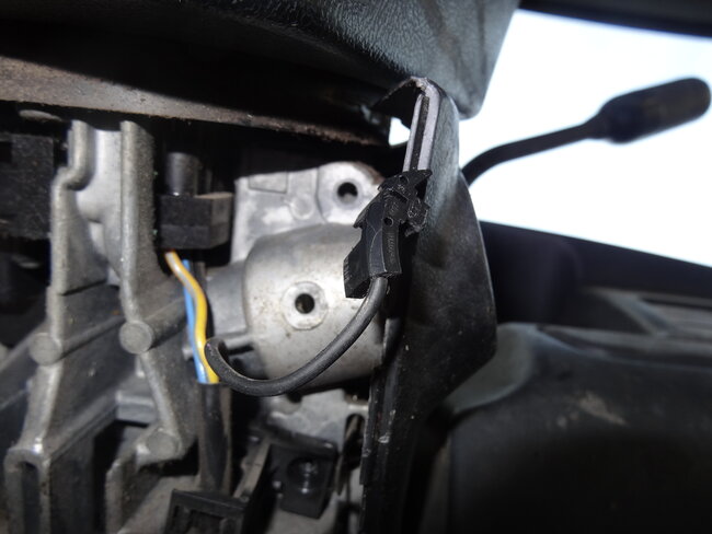

Ken, the buzzing is the warning signal the truck has when you turn the key to the on position but there is something not right. There is a clip with a black wire connected to it coming from the steering column, on top of the clip it has black plastic that looks like it pops in to where it holds the clip in place and I am not sure where it goes but the wire is only long enough to go around the outer cylinder area can you tell me where that clip should be if I clip it to the outer cylinder of the switch the warning buzzer goes off when I open the door with no key in it, then when I remove the clip the warning buzzer will not go on when the key is in the ignition on the off position. I can't see where that clip should go but it does not seem to clip to the ignition switch, but it goes someplace nearby.

This is the wire on the steering column.
May 6, 2023 at 12:37 PM
  • 55,224 POSTS
That is for the key left in the ignition when the door is open warning sensor.
May 7, 2023 at 4:31 AM
SISTO27
  • 26 POSTS
Is that wire necessary or can I just leave it disconnected?
May 8, 2023 at 8:29 AM
  • 55,224 POSTS
You can leave it disconnected but the key warning will not work.

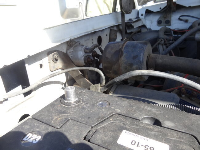

This is the relay behind the battery, correct?
May 14, 2023 at 9:58 AM
  • 55,224 POSTS
Yes, that is the starter solenoid.

When I checked the starter solenoid the small wire while cranking there was no signal test light did not go on. I checked the large wire on the starter from the battery and I had voltage to the starter.
May 16, 2023 at 9:49 AM
SISTO27
  • 26 POSTS
I need to check that solenoid of the picture I sent you, right?
May 16, 2023 at 9:51 AM
SISTO27
  • 26 POSTS
I already took that solenoid off took jumper cables hooked negative to frame of solenoid positive to the small post on top of the solenoid and I can hear it open and close, but I did not check the amps with a meter.
May 16, 2023 at 10:00 AM
  • 55,224 POSTS
If you hear the solenoid working check the power to the starter when in the crank position and if there is none replace the solenoid. Please referrer back to the previous page.

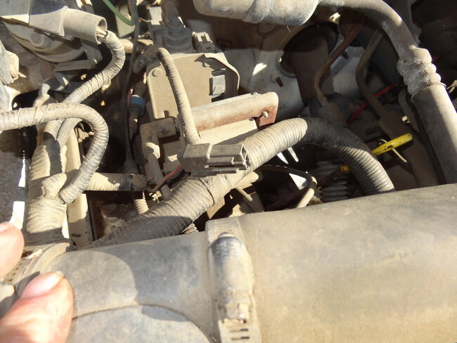

Ken, there was a wire next to the coil that connects to some ceramic resistor that's bolted to the frame. the wire comes out of that plug and if you look directly under the red wire you can see where the wire is the wire looks like it may of gotten hot if that's possible what is that wire for a ground.

Ken, I found the problem, it is the neutral safety switch, so I am going to change it now. I unplugged the harness coming from the ignition going to the neutral safety switch put the key in crank position and got 12v at te plug, then I plugged it back in went to the relay switch by the battery nothing so I took the new neutral safety switch and plugged it in went up to the relay and now I have 12v so I am changing the switch now and get back to you.

Let me know about that small wire by the coil what that is going too. Thanks
May 17, 2023 at 5:39 AM
  • 55,224 POSTS
The small wire goes to a noise suppressor for the radio. Let me know if the neutral safety switch fixes it.
