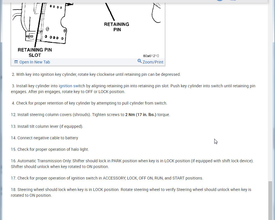

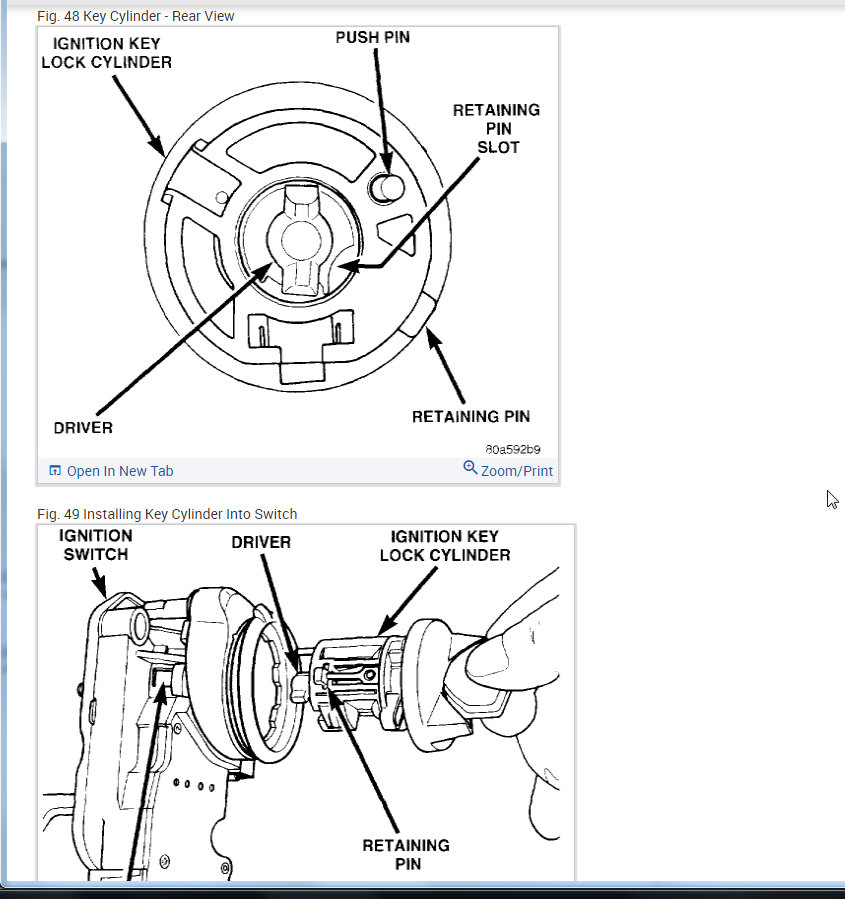

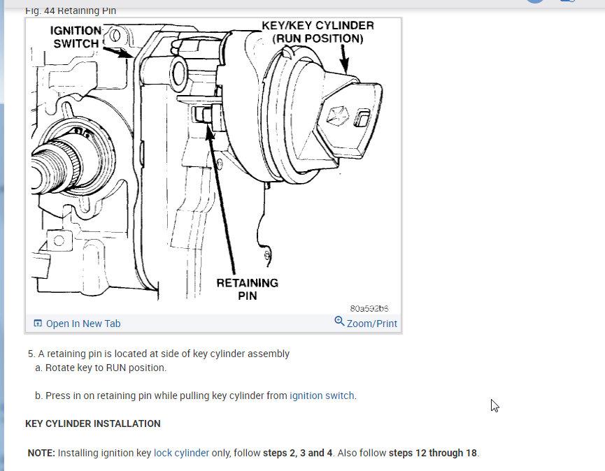

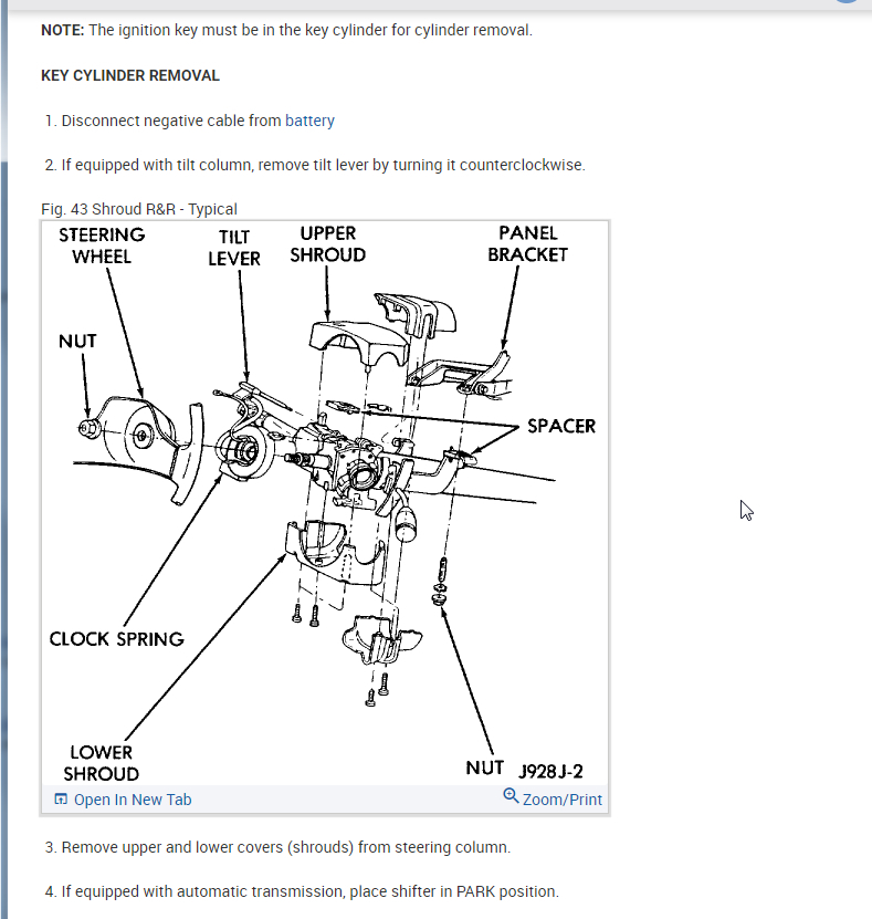

Just reviewing this and wanted to jump in because I have seen this before on this vehicle.
More then likely when you sprayed the WD40 in there, it broke loose the dirt and grime and when you put the key in, it blocked the tumblers. Then after it was dry the next day, things started to work again.
If this happens again, I would remove it and clean it out again or replace it.
I attached the process for this below if you need it. Thanks
