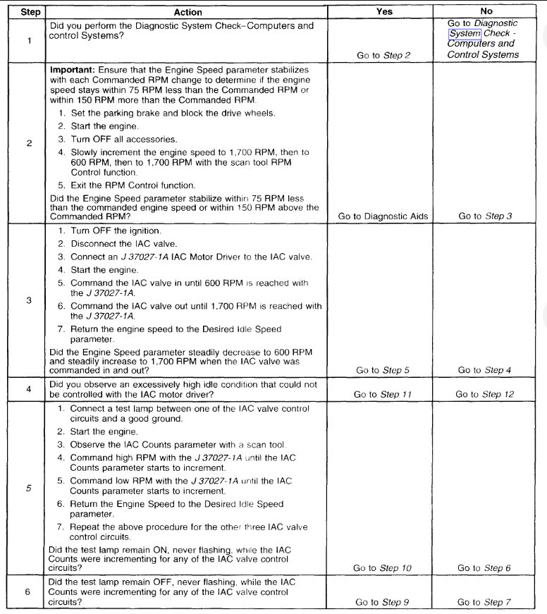

I step on the gas is rumble but does not want to stay on.
Dec 1, 2019 at 1:18 AM

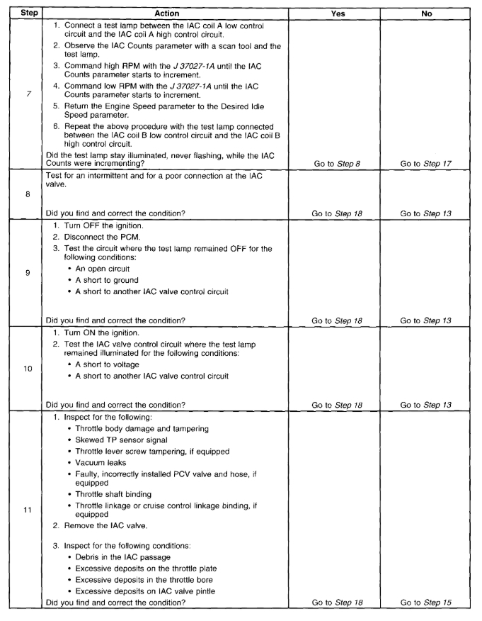

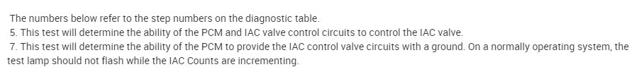

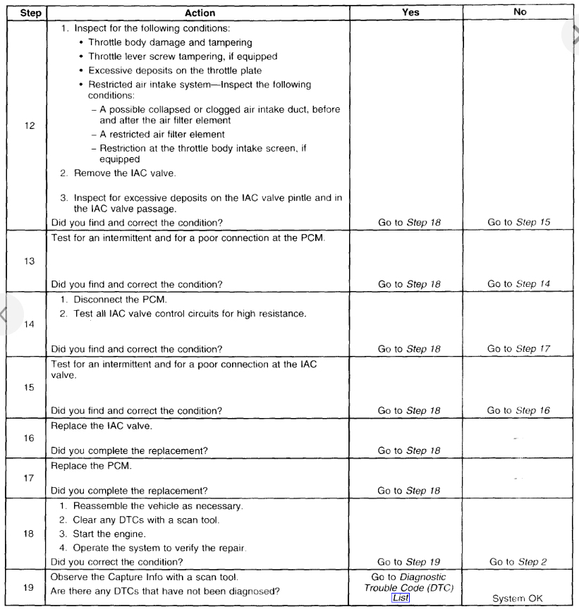

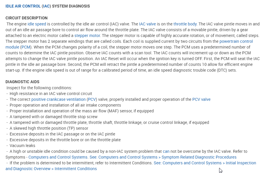

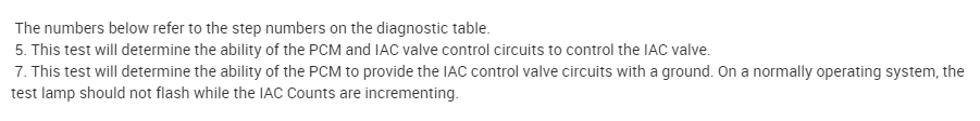

This sounds like the idle air control valve is sticking not allowing the engine to idle. I attached the diagnostic for this system and we need to run through it and see what we have.
Also, here is a guide that will help run through it:
https://www.2carpros.com/articles/how-to-replace-an-idle-speed-control-motor-iac
Let me know what you find and we can go from there. Thanks
