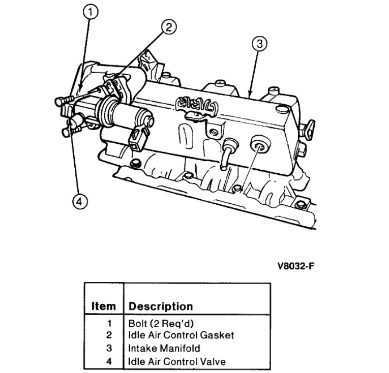

Tried to reset new IAC and PCM. didn't work. checked screw under throttle, it's nearly all the way in. changed MAF, TPS, fuel sensor,all o2 sensors, catalytic converter, manifold, all vacuum lines,and replaced fuel pump,pressure regulator,fuses,and other things such as coil, plugs,and wires. starting to run out of patience and money. any help will be appreciated.
Apr 11, 2021 at 10:14 AM
Good morning,
The base idle screw being all the way in has raised the idle very high. With the IAC motor disconnected, the idle should be 500 RPMs.
https://www.2carpros.com/articles/engine-idles-too-high
I would clean the throttle body of all carbon deposits to be sure the plate is closing all the way.

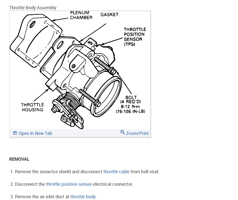

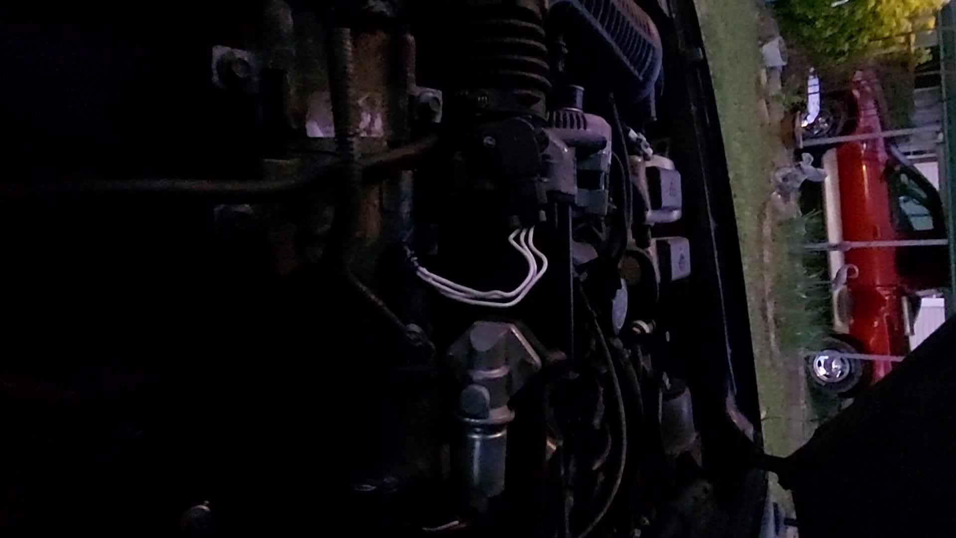

Can you attach some pictures and a video?

I'll try to upload some tomorrow after work, didn't check my emails before it got dark here.

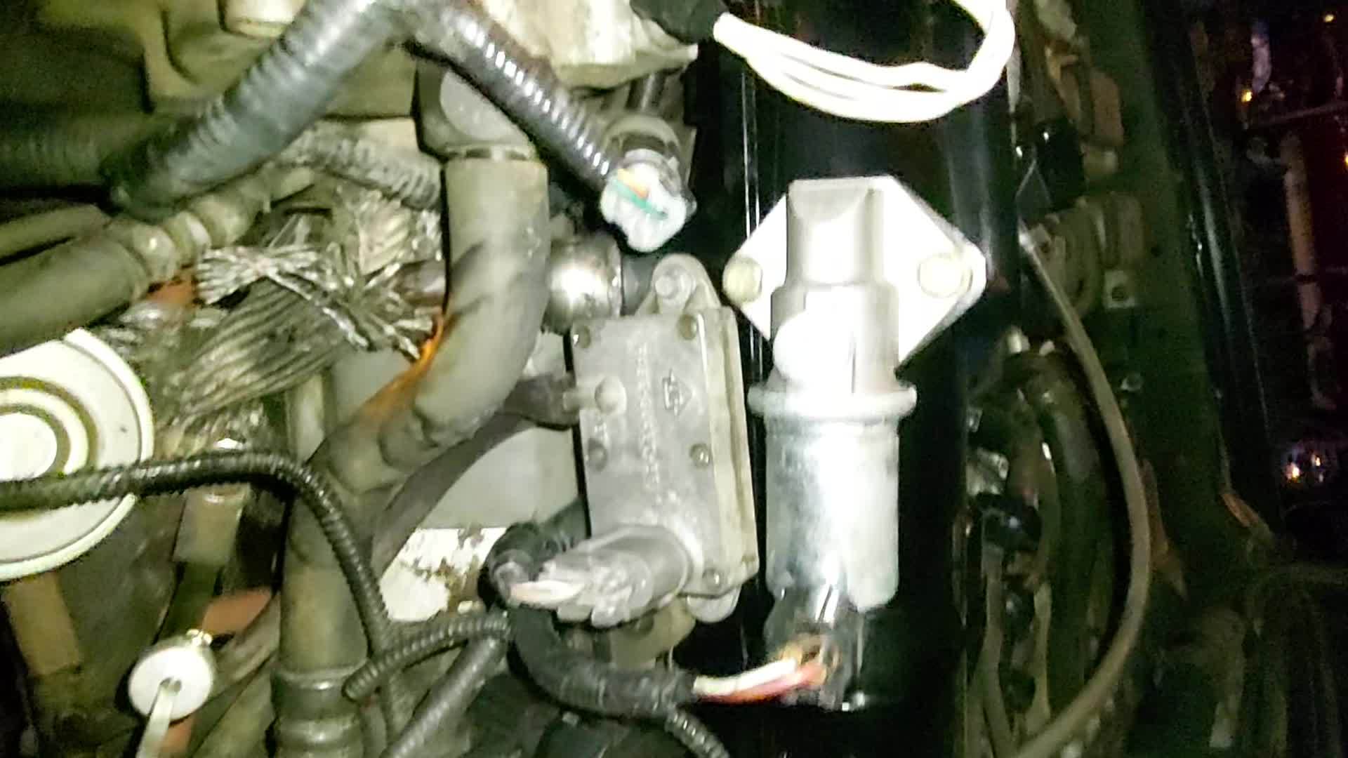

Also. Unplug the idle air control and see if the idles comes down.

Tried that, and it didn't.

Look for any vacuum leaks especially at the brake booster. If it is good, then I suspect the throttle body itself.

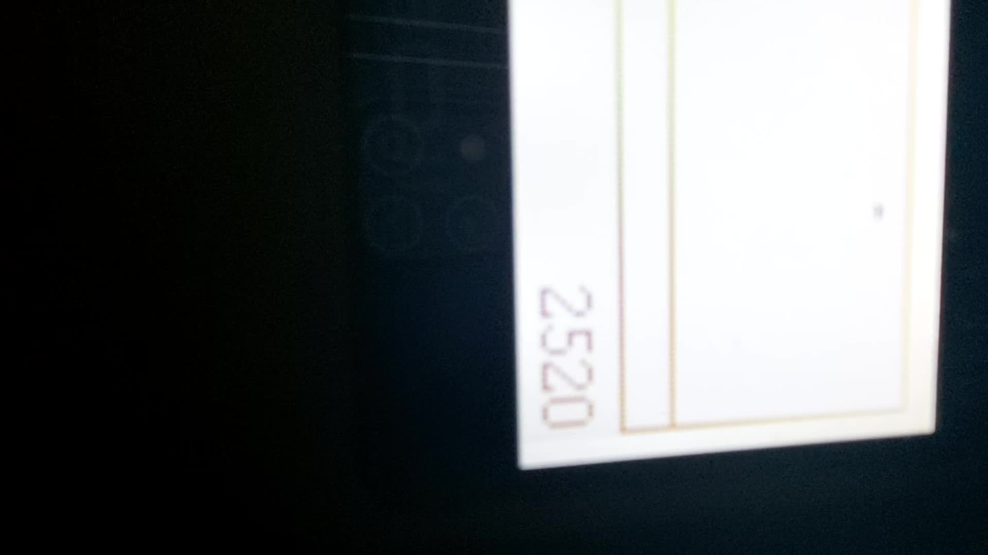

Apr 12, 2021 at 9:00 PM

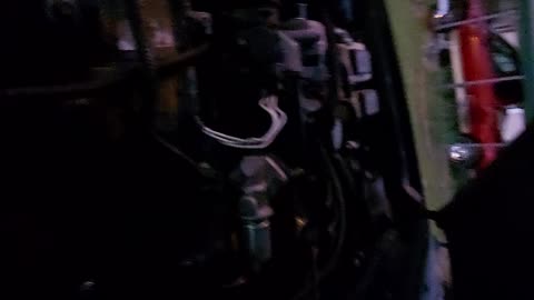

EWC177
  • 144 POSTS

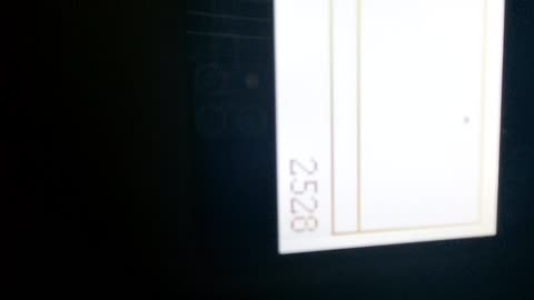

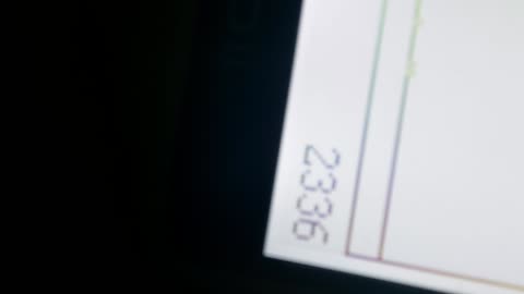

RPM checked with odb 2.
Apr 13, 2021 at 10:48 AM

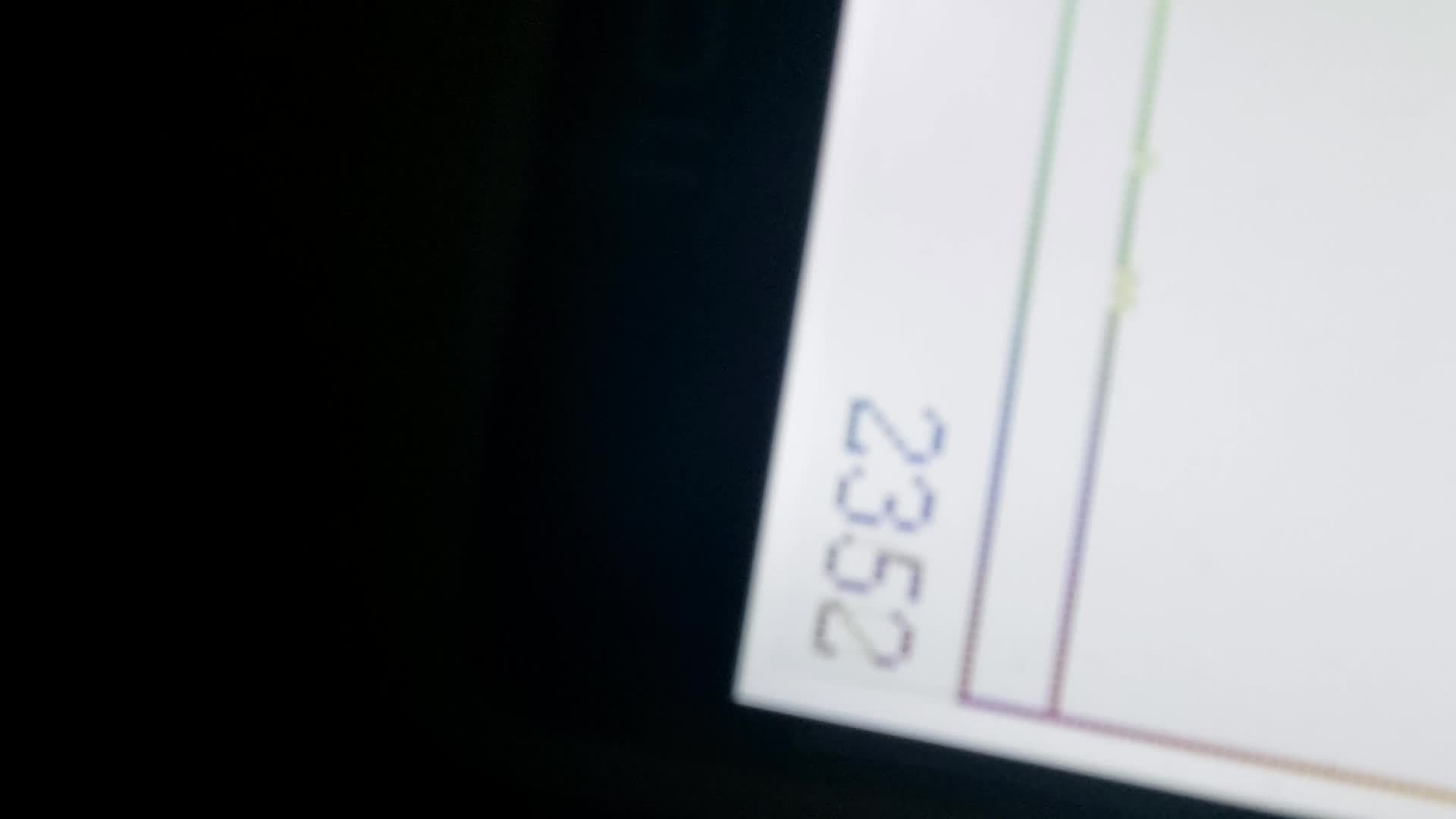

EWC177
  • 144 POSTS
2nd video.
Apr 13, 2021 at 10:51 AM
EWC177
  • 144 POSTS
After reconnecting IAC and TPS.
Apr 13, 2021 at 10:53 AM
EWC177
  • 144 POSTS

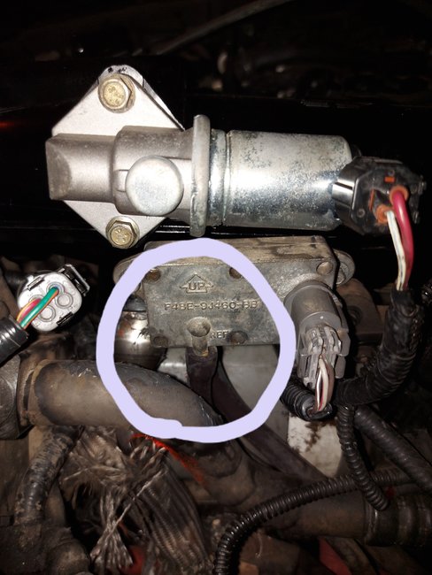

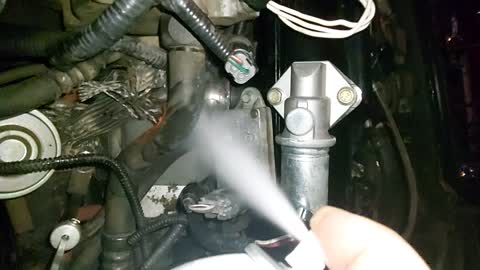

Vacuum leak.
Apr 13, 2021 at 10:55 AM

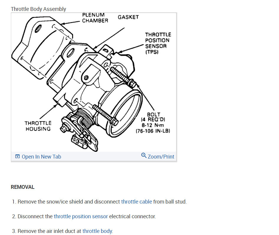

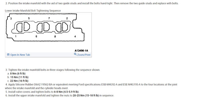

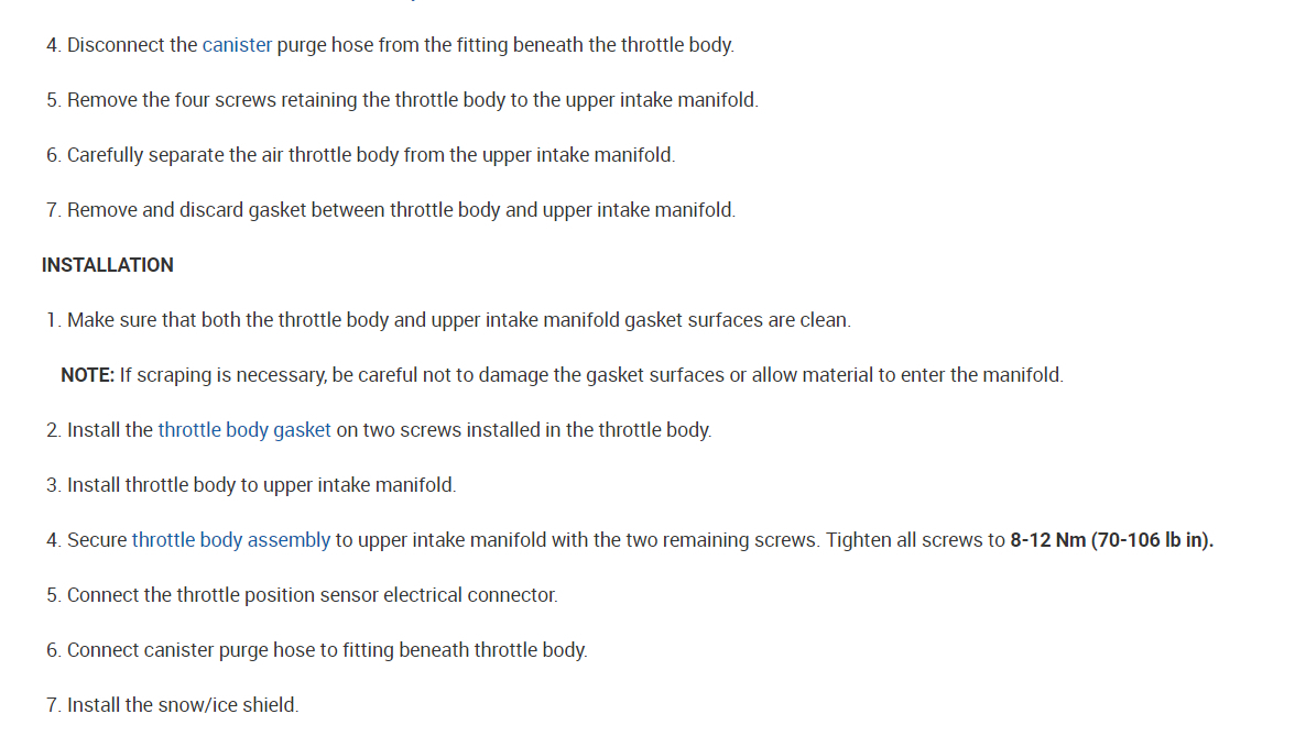

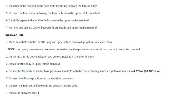

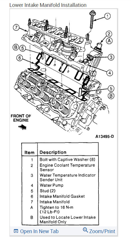

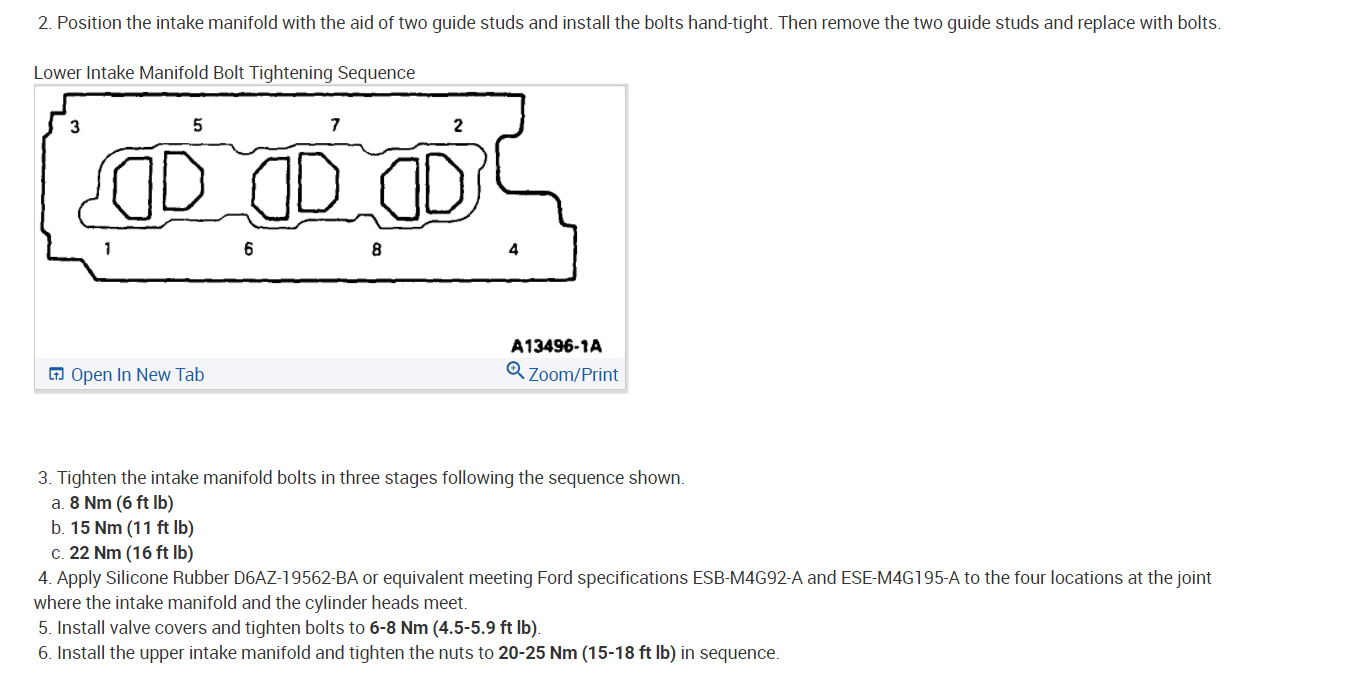

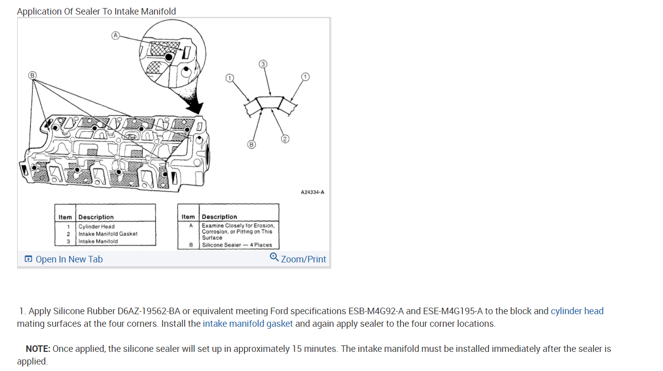

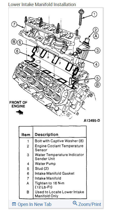

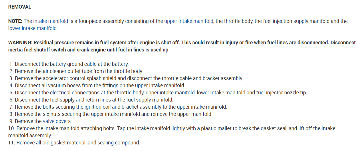

This sounds like you need a lower intake manifold gasket from where you are spraying.
The valve you circled is the DPFE and that will not cause the leak.
https://www.2carpros.com/articles/replace-intake-manifold-gasket
I attached the procedure for you to view.
Apr 13, 2021 at 5:32 PM

From your video, it points right to it.

Did they replace the upper and lower intake gaskets?
Apr 13, 2021 at 9:31 PM
EWC177
  • 144 POSTS
Yes, told me that they had a truck like mine and the surging was bad o2 sensors or stopped up cat on theirs, so they removed them..didn't help mine..now it has a new cat, muffler and all 3 o2 sensors have been replaced with the proper upstream and downstream sensors..
Apr 13, 2021 at 9:34 PM
With you spraying carburetor cleaner and the idle changing, you have a vacuum leak right there. Most of the time it is those gaskets.
