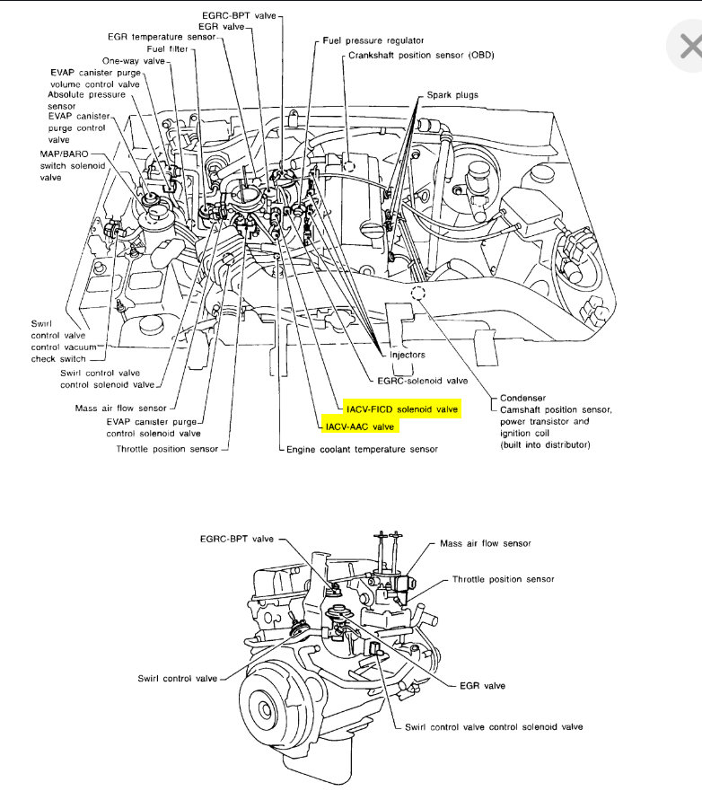

My truck idles up sometimes to 1,500 rpm's and then down and sometimes quits. It doesn't show any check engine lights . I know the distributor cap, rotor button, plug wires, gas filter and so on are good.
I was thinking it might be the idle control valve I call it. I don't know the technical name for it .
Does the idle control valve give me a check engine code if it's bad or does the IAC give a code is it goes bad ?

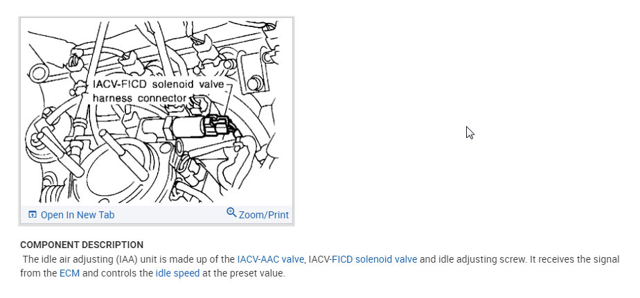

More than likely you are correct that it is the idle control valve. Your specific component is called the idle air adjusting unit.
If it were me I would go ahead and replace it. You can clean them but again, they are cheap enough I would just go with new one and then clean the old one so you always have a spare.
https://www.2carpros.com/articles/idle-air-control-valve-service
Let me know if you have questions. Thanks

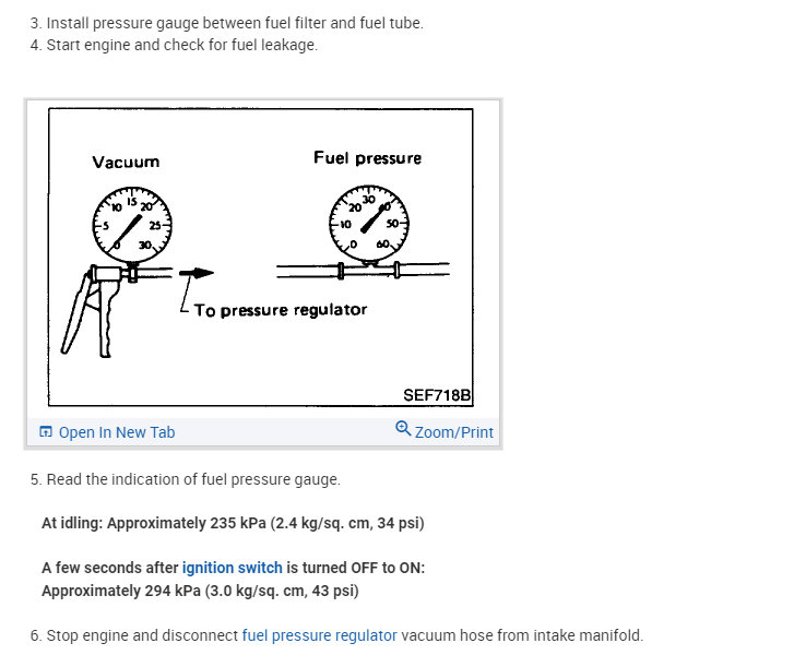

I've been told this might be the problem this part fuel injection thermostat in this web link:
https://www.carid.com/original-equipment/fuel-injection-thermostat-mpn-1639112g00.html?singleid=1795967990&url=4904360#warranty
Dec 25, 2019 at 12:13 PM
It could but if you monitor the fuel pressure you should see a change that corresponds with the surging if it is fuel related. If you don't then it is air control related.
