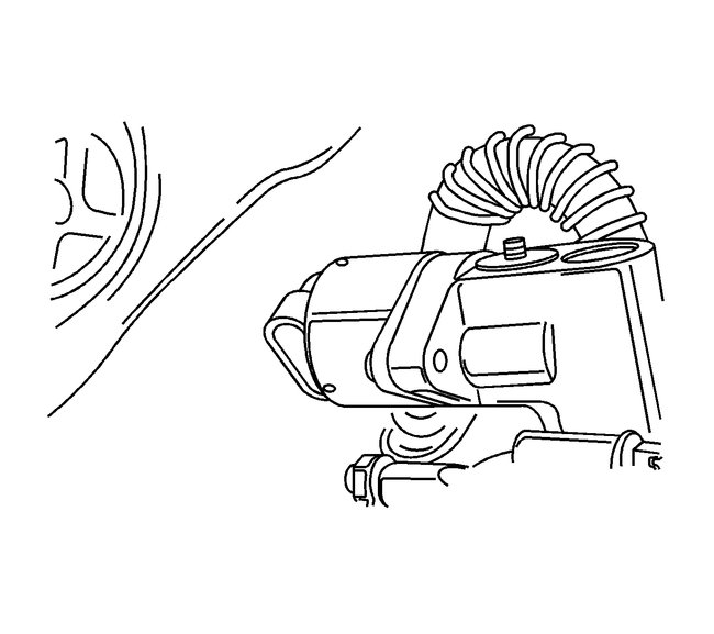

Idle inconsistencies.
Cleaned MAP no change
Seems bad when warm not cold.

The idle air control valve is responsible for maintaining idle speed. I would suggest checking it. It is located on the throttle body. Remove it and inspect it and the inside where it mounts for excessive carbon or dirt.
Here is a link that shows in general how one is replaced:
https://www.2carpros.com/articles/how-to-replace-an-idle-speed-control-motor-iac
Here are the directions specific to your vehicle for replacement:
REMOVAL AND REPLACEMENT
Idle Air Control Valve Replacement
Removal Procedure
See picture 1
Warning: Refer to Battery Disconnect Warning (See: Battery > Technician Safety Information > Battery Disconnect Warning).
1. Disconnect the negative battery cable.
2. Disconnect the idle air control (IAC) valve connector.
3. Remove the IAC valve retaining bolts.

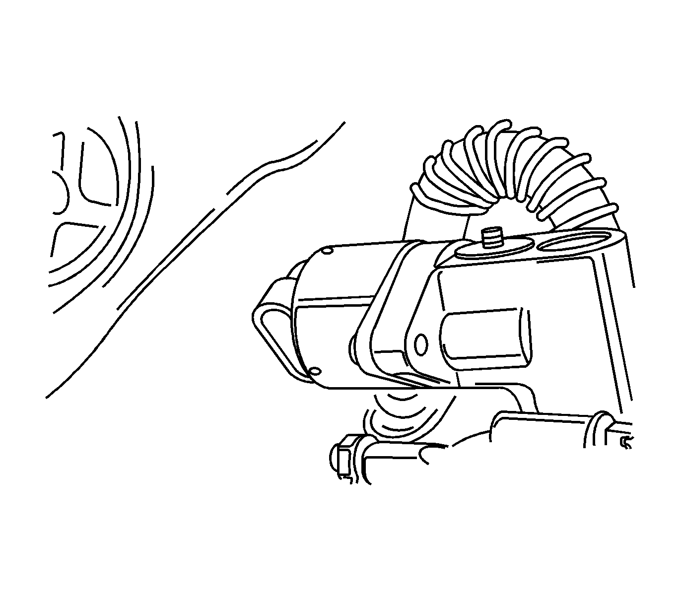

Caution:
* Do Not push or pull on the IAC valve pintle on IAC valves that have been in service. The force required to move the pintle may damage the threads on the worm drive.
* Do Not soak the IAC valve in any liquid cleaner or solvent, as damage may result.
4. Remove the IAC valve.
5. Clean the IAC valve O-ring seal area, the pintle valve seat, and the air passage with a suitable fuel system cleaner. Do not use methyl ethyl ketone.
See picture 2
Note: If installing a new IAC valve, be sure to replace it with an identical part. The IAC valve pintle shape and diameter are designed for the specific application. Measure the distance between the tip of the IAC valve pintle and the mounting flange. If the distance is greater than 28 mm (1.1 in), use finger pressure to slowly retract the pintle.
The force required to retract the pintle will not damage the IAC valve. The purpose of the 28 mm (1.1 in) setting is to prevent the IAC pintle from bottoming out on the pintle seat. This 28 mm (1.1 in) setting is also an adequate setting for controlled idle on a restart.

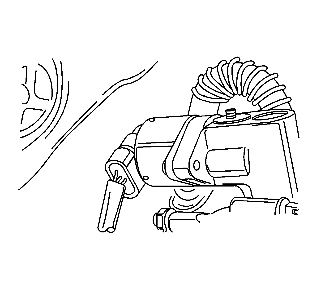

1. Lubricate a new O-ring with engine oil. Install the new O-ring onto the valve.
2. Install the IAC valve into the throttle body.
See picture 3
Caution: Refer to Fastener Caution (See: Vehicle > Vehicle Damage Warnings > Fastener Caution).
3. Install the IAC valve retaining bolts.
Tighten the idle air control valve retaining bolts to 3 Nm (27 lb in).
4. Connect the IAC valve connector.
5. Connect the negative battery cable.
6. Perform the idle learn procedure. Refer to Throttle/Idle Learn (See: Throttle Body > Procedures > Throttle Learn).
