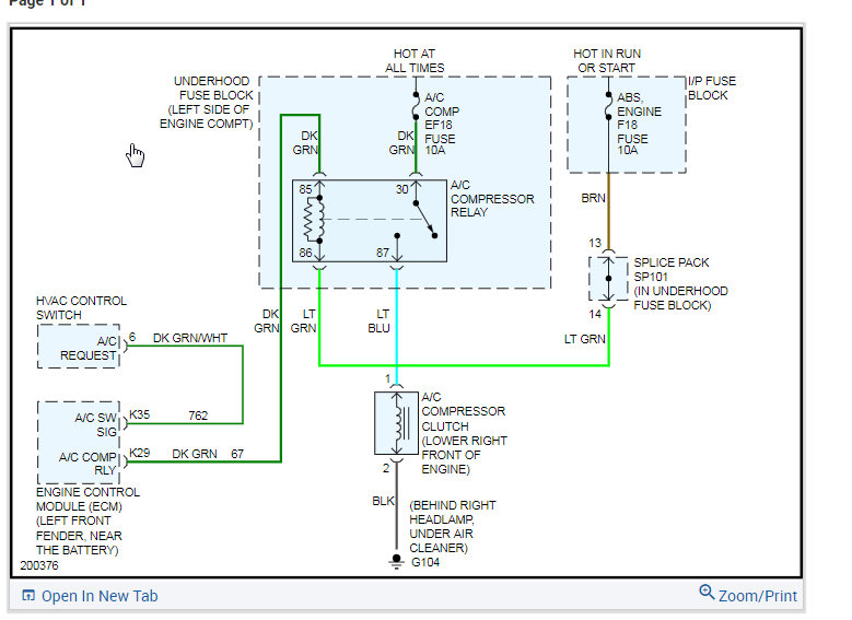

fuses are good, Freon is good, pressure switch is good. Any thoughts on what is the problem?
Jul 12, 2009 at 5:26 AM
If these are okay, we need to go to the compressor and check for power at the clutch to see if you have it when the A/C is on. If you do then the compressor has failed. If not then we have a wiring or control issue.
At that point we need to go to the relay and test the relay. Here is a guide that will help with that:
Here is a guide on this issue that will help with what we need to check. Let's check this out and go from there. Thanks
