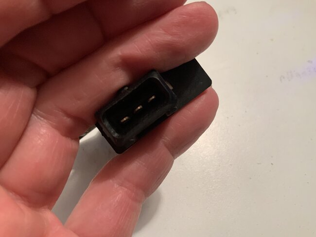

I checked it for codes, and I got 51. This is a switch signal issue, but explanation doesn't help. "A/C signal on, IDL contact off, or shift position in R, D, 2 or 1 range; with check terminals T and E1 connected." I did the proper connection. No problems with A/C, it works. Shifting works, it starts only in N and P. That leaves idle contact. I assume that is TPS?

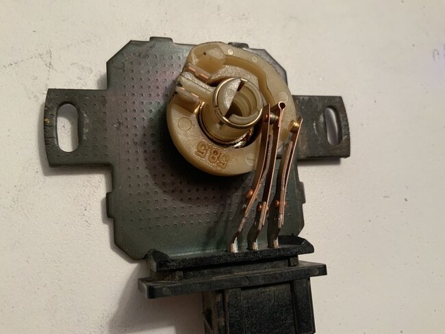

I checked it out, but I cannot find any instructions online that show the correct TPS. All instructions are for a 4 pin and mine is 3 pin. I can buy the correct one, by picking the one that looks like mine, yet there is another one that is commonly listed but it isn't the right one.
I get voltage to each outside terminal of 11.5 volts intermittently, as I turn the sensor. The center appears to be the source voltage and it switches from one terminal the other. Doesn't make sense to me because I opened it up and it is simply a switch from one side to the other.
Wide open throttle connects one terminal and closed connects the other, that's it. There is no Rheostat. There is no variable voltage in this TPS. I wish I could post a photo. It appears to work as designed, but not according to anything online. The other one they always show should have 5 volts source and vary down to .5 or so. Does anyone know anything about this?

I was mistaken about which pins have voltage. The two outside pins have 11.5 v when they are not touched by the center contact, but when they are, they go down to 0v. Never seen anything like it in my life.
Jan 22, 2023 at 8:52 AM
SECOND1UP
  • 9 POSTS
Center pin shows zero always. It's like it is grounding out the other ones when they touch, but no sparks or heat involved.

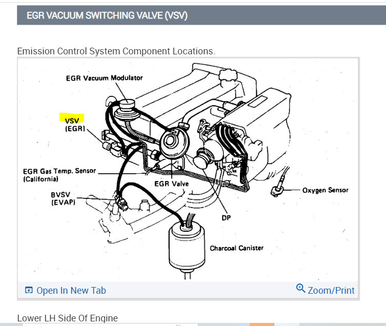

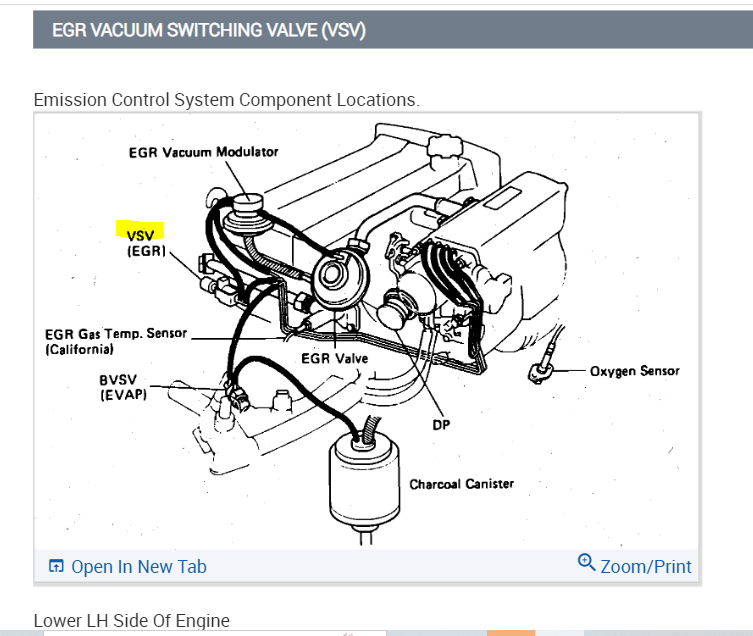

Idle speed is controlled by the throttle actuator, but the ECU uses different sensors to determine what is needed. The first thing that came to mind when I read your description was dealing with the idle speed VSV (vacuum switching valve) see pic 1 below. Check those vacuum lines to make sure nothing is disconnected, broken, or dry-rotted.

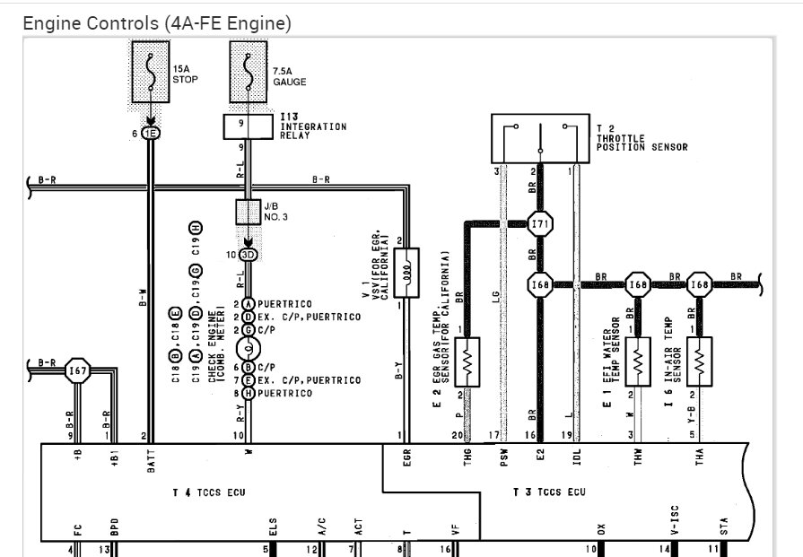

Next, the throttle position sensor, according to my schematics, does have 4 wires. See pic 2 below and let me know if the wire colors indicated match what you see.

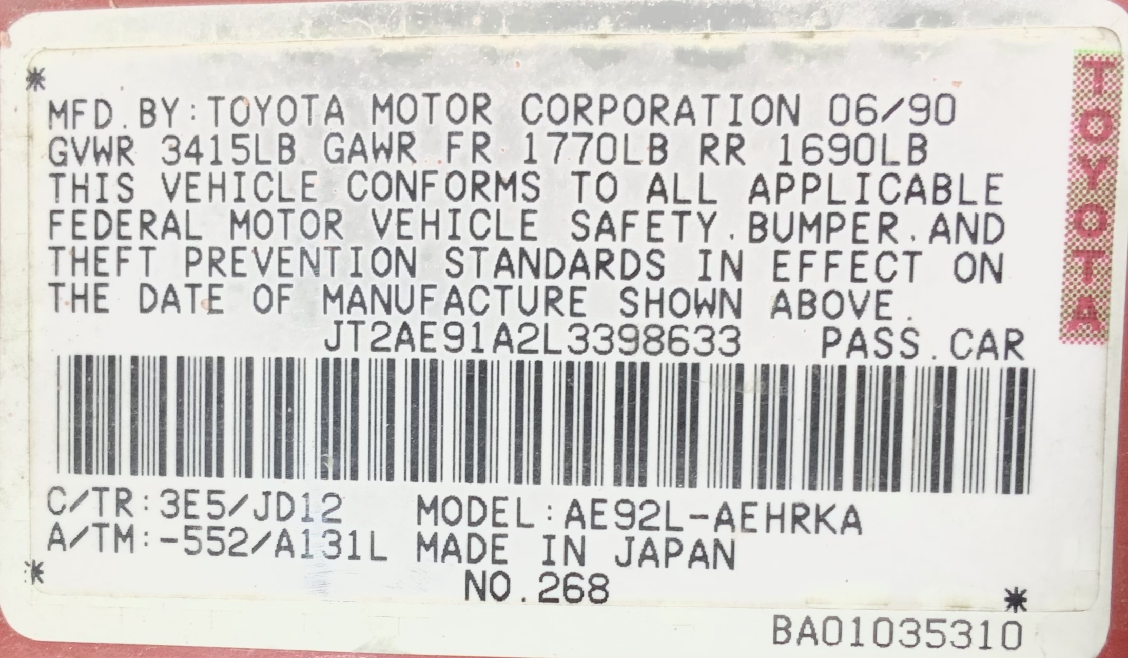

Thank you for the reply. The only smoke is sometimes when I first start it up it does smoke for 10 seconds or so, then quits. Regardless of the schematic, my TPS is 3 prong, so that schematic does not apply to this car. That's what threw me because I can't find any schematic or mention of it online, although I can buy the part. I will post a photo below. The engine is 4A-FE. It's night here but I did take a quick look at the vacuum hoses and didn't see any issues but will look more thoroughly tomorrow.

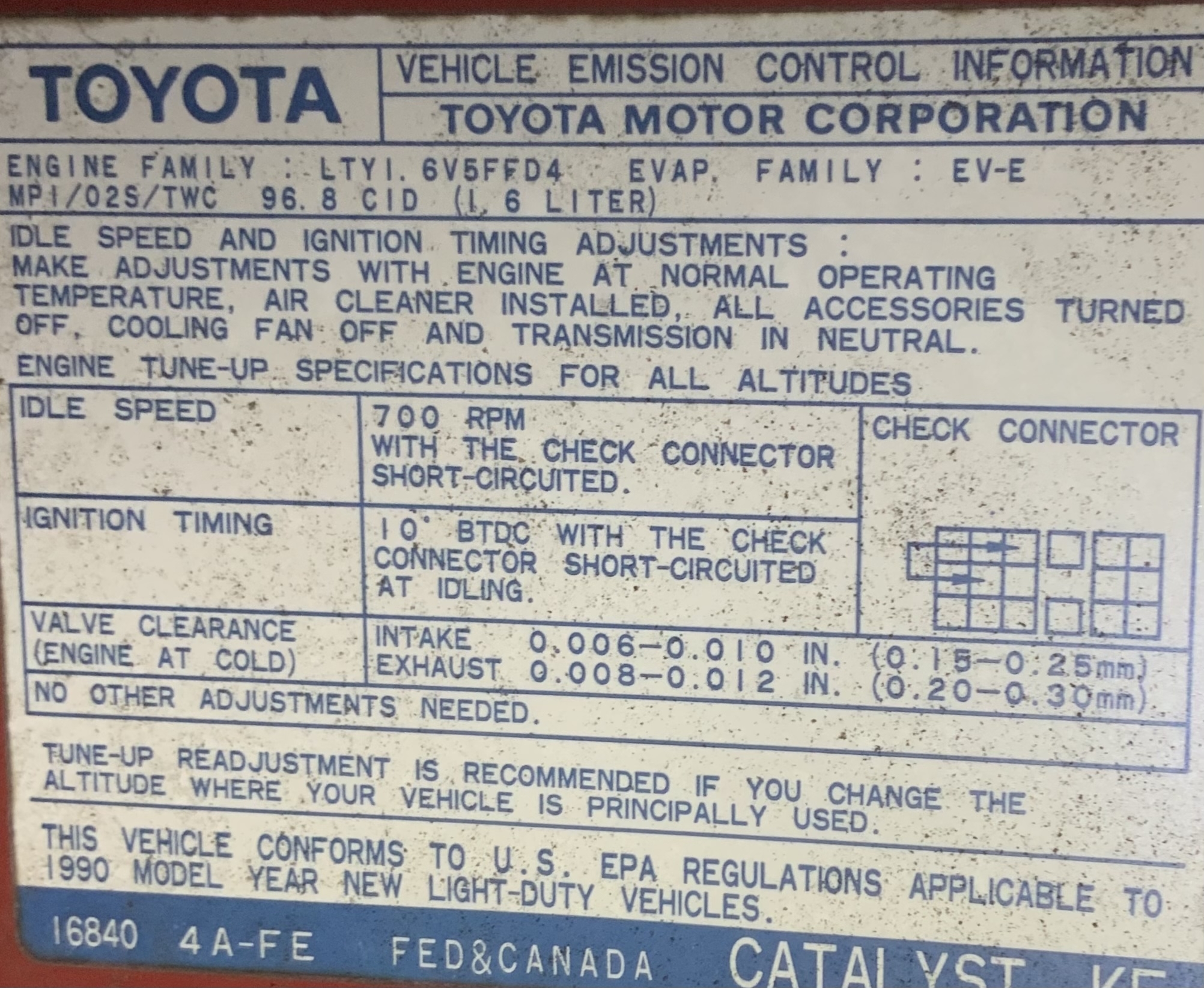

Info and TPS photos. TPS without cover on it. This is not a variable resistor component. Just contacts, that is it.

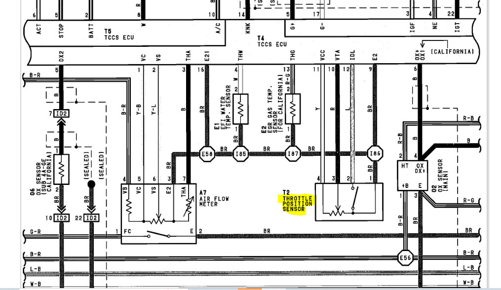

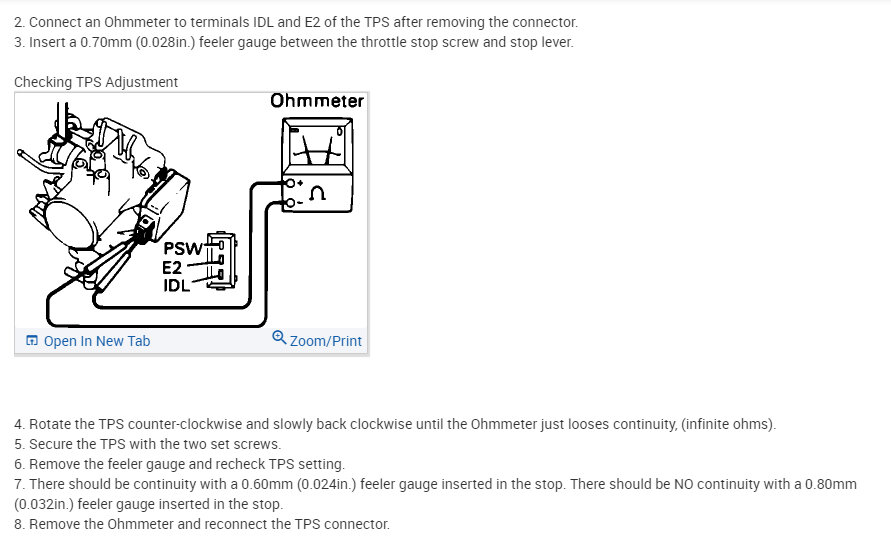

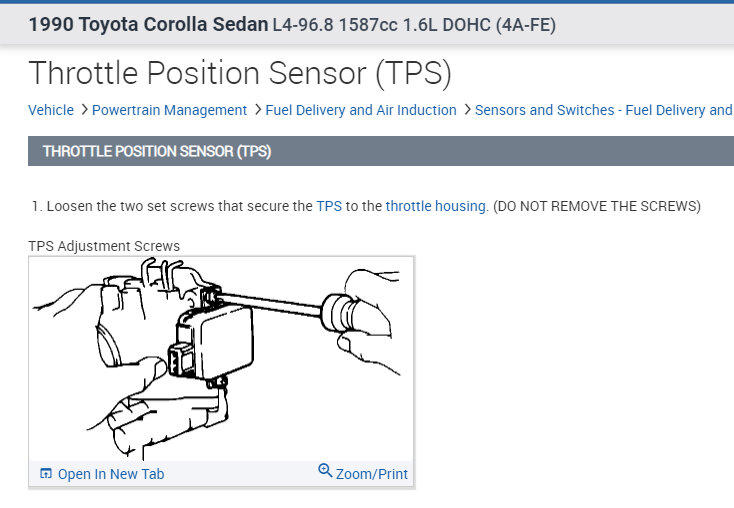

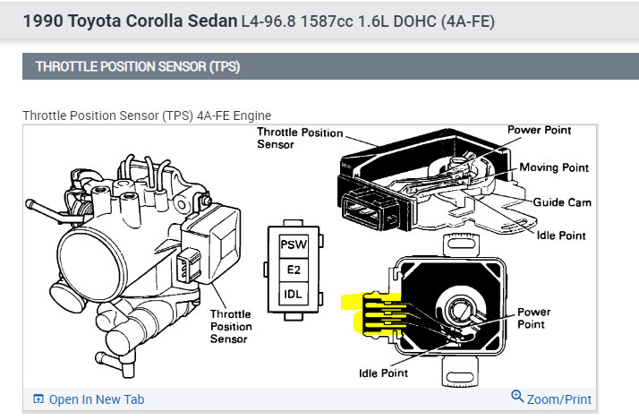

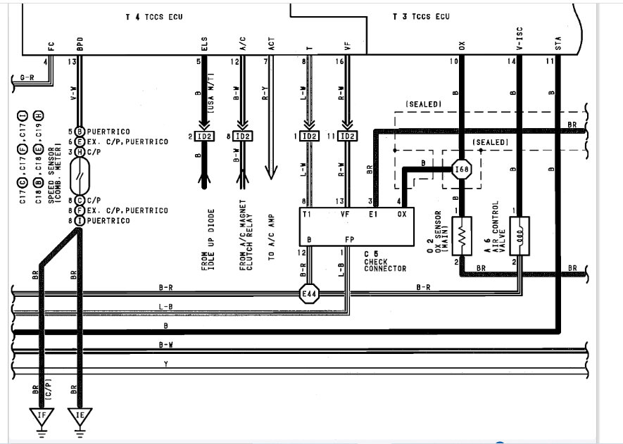

See pic below. The FE engine has a three-pin connector. For some reason, the four-pin is the only one shown in the schematics. If you look at pics 2 and 3, they provide the directions for adjusting the TPS. If the vehicle ran better with it disconnected, I would try this first.
Also, after digging, I found the OEM wiring schematic showing the three-pin TPS. The last two pics are what I found. I had to cut the pic in two to make it readable for you, but I did overlap them.
Let me know if this helps.

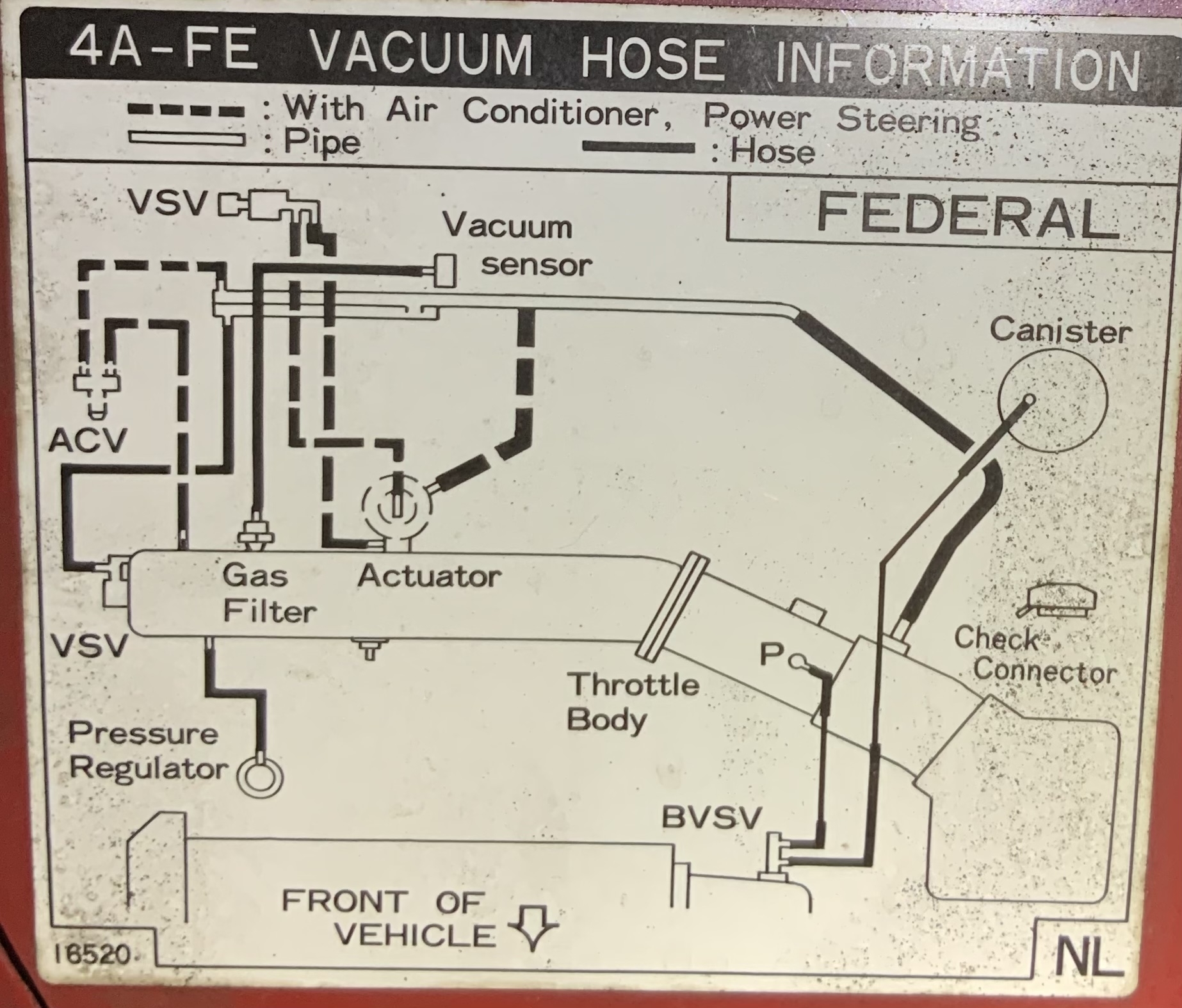

I certainly heard it. Was code 51 the only one you found? I heard the misfire so I would think there would be additional codes.
Since it starts running better when the engine warms up, I'm questioning if there is a vacuum leak at the intake or throttle body.

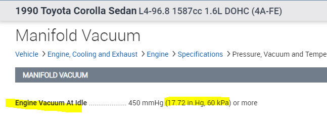

Do me a favor, if you have a vacuum gauge, check the engine vacuum at an idle and let me know what you find. (See pic below)
Also, take a look through this link on how to locate and repair engine vacuum leaks:
See pic below.

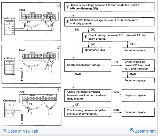

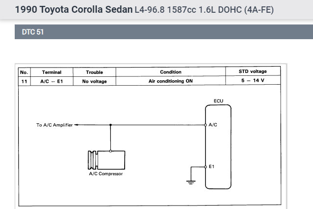

I attached two pics below related to testing for the original code. See if anything stands out to you.
