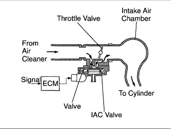

You have done a lot. The one thing I noticed you didn't mention was checking for engine vacuum leaks. That can cause an idle issue. Also, I noted you check for codes, so I suspect you have a scanner. If it is a live data scanner, can you let me know what the fuel trims are. I would specifically like to know the short term fuel trims.
Also, by any chance did you confirm there is nothing blocking the air passage allowing air to enter the engine via the IAC? Note in the pic below how air flows.
I'm not sure if you need it, but here is a link that explains how to check for a vacuum leak:

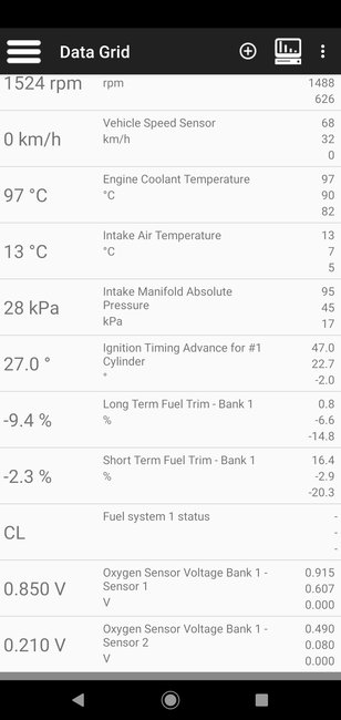

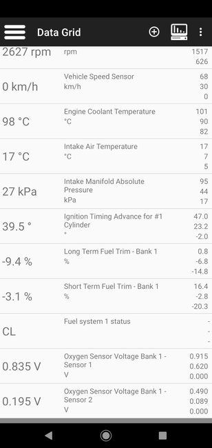

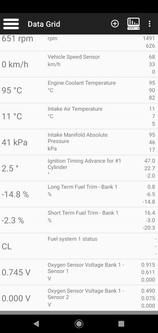

I added 3 data screenshots from idle 1500 and 2500 rpm. Short term trim bounces a lot but generally at idle it's plus minus 2, long term is locked on -14.8 at idle but when driving is around 0, at higher no load rpm it sits at -9.4 steady. O2 sensor 1 in header bounces .1 to .8, sensor 2 after cat is 0 to .1 whenndriving. Steady 0 at idle. I did hunt for vacuum leaks, couldn't find any. Any tricks to try on that? MAP seems low enough. I put some vacuum to EGR valve at idle and engine chokes instantly. If I pull a vacuum line and leak air the idle shoots up to 1200. How can I test EGR for leaks?

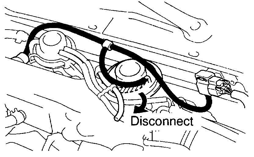

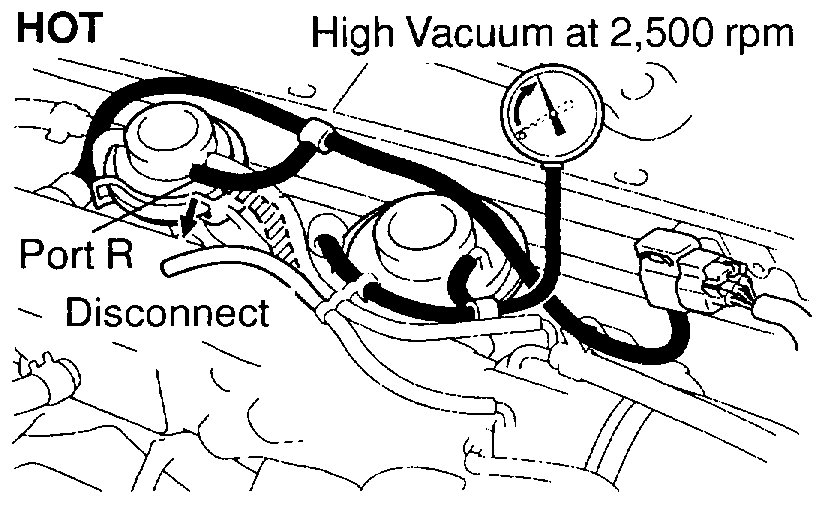

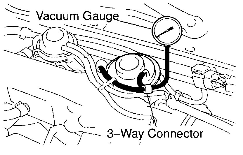

I looked through the pics you attached. Was the engine warm when you did the test? I noted the engine at 208°F and the air intake at 55°F. Just curious. As far as the egr leaking, based on fuel trims, I would say the problem isn't a vacuum leak. However, here are the directions for testing the EGR system. The attached pics correlate with the directions.

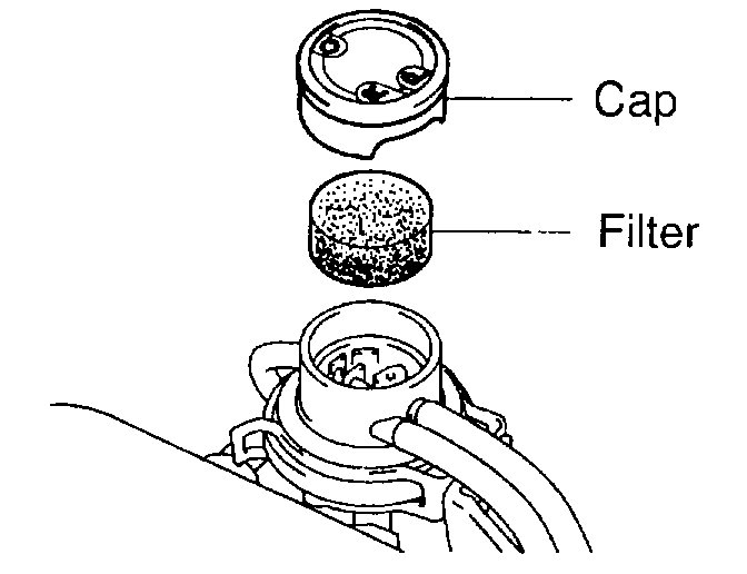

pic 1
a. Inspect and clean the filter in the EGR vacuum modulator.
1. Remove the cap and filter.
2. Check the filter for contamination or damage.
3. Using compressed air, clean the filter.
4. Reinstall the filter and cap.
HINT: Install the filter with the coarser surface facing the atmospheric side (outward).

b. Using a 3-way connector, connect a vacuum gauge to the hose between the EGR valve and VSV.
c. Inspect seating of the EGR valve.
Start the engine and check that the engine starts and runs at idle.

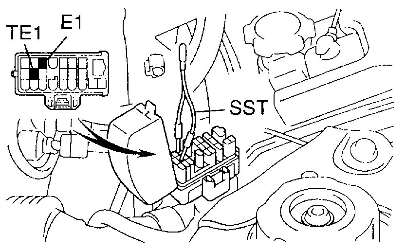

pic 3
d. Using SST, connect terminals TE1 and E1 of the DLC1.
SST 09843-18020
e. Inspect the VSV operation with the cold engine.
1. The engine coolant temperature should be below 55° C (131° F).
2. Check that the vacuum gauge indicates zero at 2,500 rpm.
pic 4
f. Inspect the operation of the VSV and EGR vacuum modulator with the hot engine.
1. Warm up the engine to above 60° C (140° F).
2. Check that the vacuum gauge indicates low vacuum at 2,500 rpm.
3. Disconnect the vacuum hose port R of the EGR vacuum modulator and connect port R directly to the intake manifold with another hose.
4. Check that the vacuum gauge indicates high vacuum at 2,500 rpm.
HINT: As a large amount of exhaust gas enters, the engine will misfire slightly.

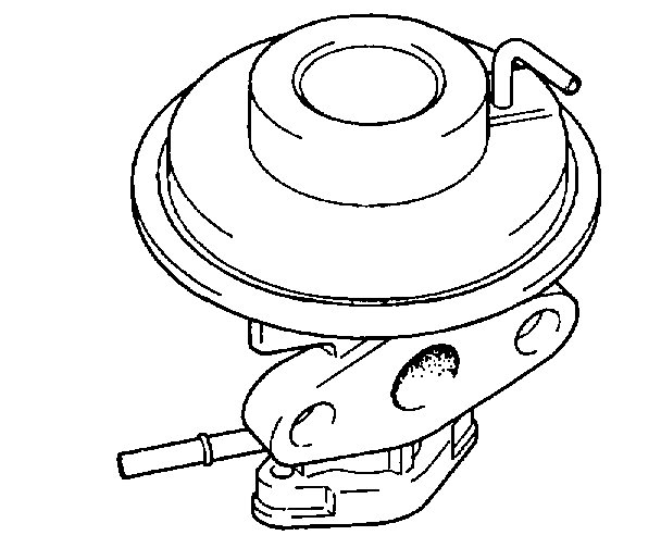

pic 5
h. Inspect the EGR valve.
1. Apply vacuum directly to the EGR valve with the engine idling.
2. Check that the engine runs rough or dies.
3. Reconnect the vacuum hoses to the proper locations.
HINT: As exhaust gas is increasingly recirculated, the engine will start to misfire.

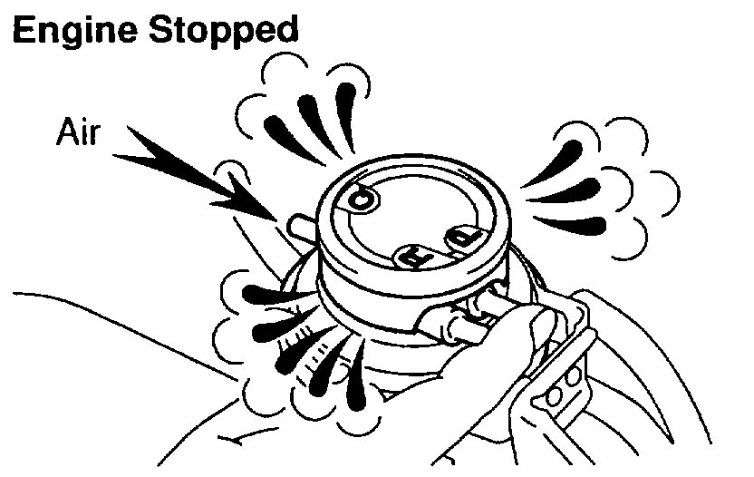

pic 6
a. Disconnect the vacuum hoses from ports P, Q and R of the EGR vacuum modulator.
b. Block ports P and R with your finger.
c. Blow air into port Q, and check that the air passes through to the air filter side freely.

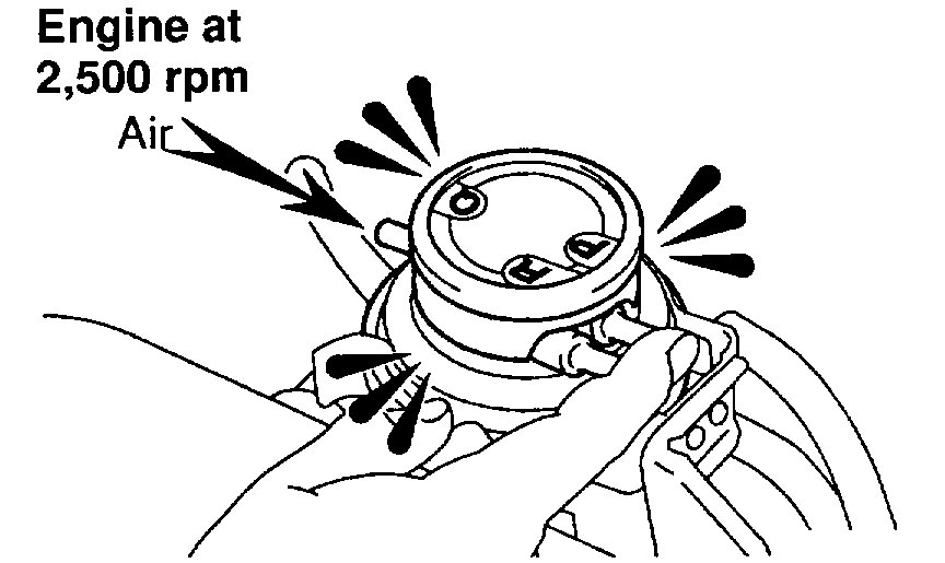

pic 7
d. Start the engine, and maintain speed at 2,500 rpm.
e. Repeat the above test. Check that there is a strong resistance to air flow.
f. Reconnect the vacuum hoses to the proper locations.
