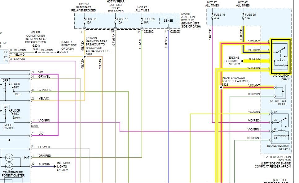

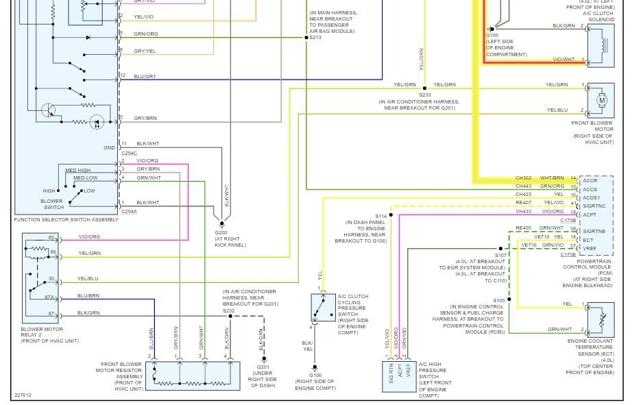

Symptoms: A/C has gone in and out over the last week (mostly out). Compressor is not engaging. Refrigerant is full.
Here's what I've done:
I have replaced the low pressure cycling switch.
I have recharged the system.
I have replaced every o-ring that I can get to.
Here's what I've tested:
I powered the compressor with a small 12v battery. Compressor worked fine and allowed me to recharge the system correctly.
I've tested the low pressure cycling switch for continuity past the connector. Switch and connector are fine. I do not get 12v on this wire when I turn on the A/C.
I've tested the high pressure sensor. Reference (5v), signal (1.3v), ground (good). Voltages are static when A/C is on or off.
The fuses and relay are fine.
I do not know how to test the climate control unit.
How would you proceed?

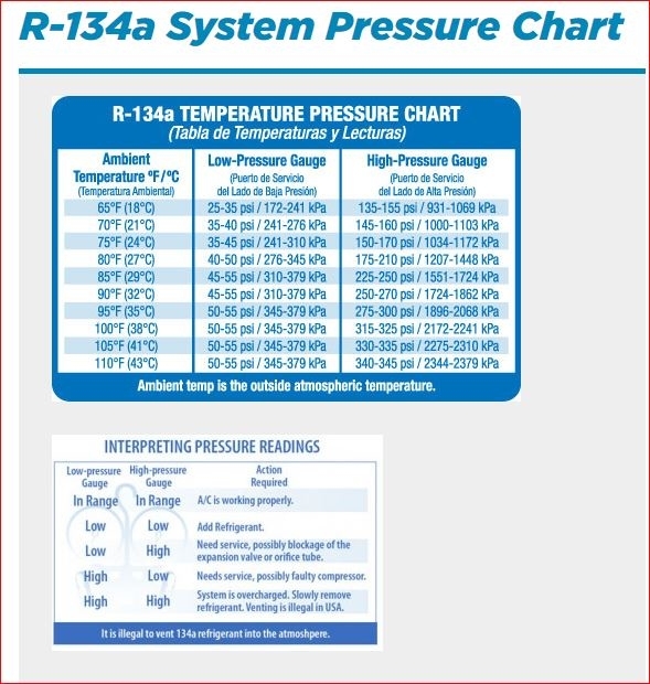

We need to start with checking pressures. This is the first thing we need to do and cannot assume it is full of Freon because there is no way to tell without knowing the pressures. Just because the system won't take any more Freon does not mean it is full.
If you don't have a gauge set to get high and low side pressures then check with local parts stores to see if they have tool rental programs. Then hook up the gauges to the low and high side with the engine on and A/C running. Once we get the pressure we will know what action to take.

Let us start with the pressures.
Can you give me the high and low side pressures both with the A/C off and running?

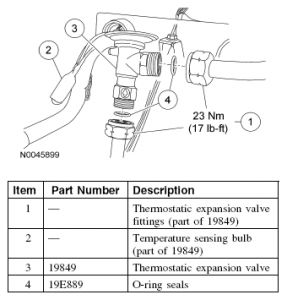

SMANDRY
Air Conditioning problem
2006 Mercury Mountaineer V8 Two Wheel Drive Automatic
The rear AC only blows warm or hot air, while the front AC blows cold. Neither refrigerant line to the rear evaporator is cold, or hot. Pressure readings on the system are normal and steady.
Jul 17, 2020 at 5:26 AM (Merged)
DOCFIXIT
  • 18,828 POSTS
Hi Maybe expansion valve stuck open not droping pressure to cool evaporator. see figure
https://images.2carpros.com/forum/automotive_pictures/198357_Graphic_128.jpg
Hope this helps Thanks for donate
SMANDRY
Thanks for the response. In your picture, is this valve mounted on the side of the evaporator inside the left rear quarter panel, or is it inside the connection block underneath the left-rear corner of the car?
DOCFIXIT
  • 18,828 POSTS
It will be in line to Evap very close to core

This is one of two things either the system was not running when you installed your gauges and the system is low or the the system has running and the system is overcharged.
Here are two guides that will help you get the problem fixed.

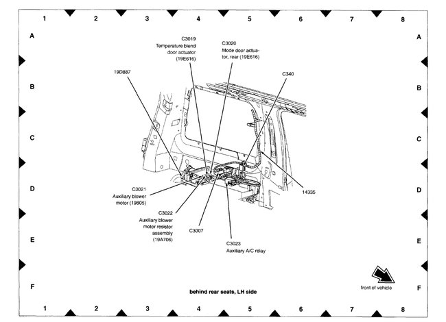

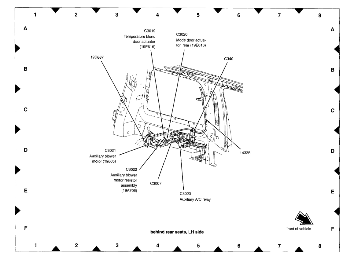

XODENNAXO
I have heat when I have it on face or floor but no hot air when I put it on defrost and the rear ceiling vents don’t blow hot air either.
  • 55,399 POSTS
It sounds like you have a mode and temperature actuator out which is common. here is a guide to help walk you through the repair with diagrams below to show you the location of the actuator in your car:
