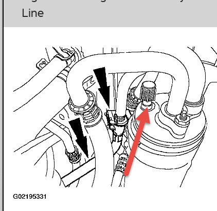

I am not sure exactly where to fill it and not sure if I just bought the wrong hose to place on the port I may be over looking. please help summer is coming and I have no ac at all in my car.
Apr 16, 2016 at 1:26 PM
HMAC300
  • CAR REPAIR CONTRIBUTOR
  • 48,601 POSTS

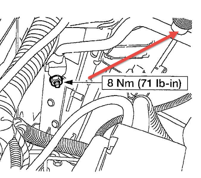

Here are two videos to help you get the job done with the low side post locations in the diagrams below.
