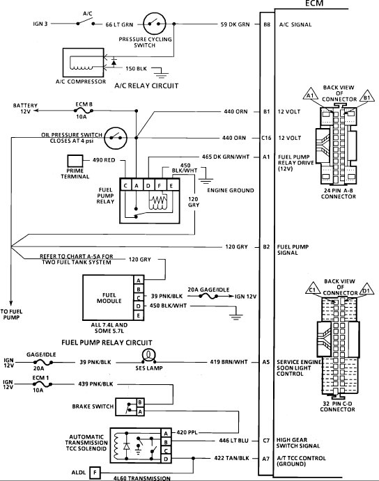

I was told by 2CarPros I needed a new fuel pump I put one in and it was working fine for twenty four hours. Now it is doing the same thing again. What do you think? Will not start all the time have to spray starter fuel in the carburetor to make it start? What do you think could be wrong?

To start the fuel pump is not mechanical it is in the gas tank. I just put a new one in and I put a new fuel filter on. Where should I go now?

Couple of simple tests to try to pinpoint the problem.
When it does not start can you hear the pump running for the two second prime?
With a new pump it may be quiet so pop the gas cap and have someone cycle the key.
If you do not hear the pump, check that the fuel pump relay socket is not melted or damaged, many times as a pump ages they draw more current and this heats up the relay socket and the connectors inside get weak and do not grip the relay very well.
Now for a simple test to see if it is the connection at the pump or elsewhere. If you look under the hood near the pump relay there should be a terminal with a red wire. That is the prime terminal. If you apply twelve volts to it the pump should switch on and pump fuel. When it does not start try jumping twelve volts to that terminal. If it now starts up okay the wiring to the pump is not the issue.
Next test would be to simply swap the pump relay after checking the socket real well.
I would also verify that the relays ground is good. If it gets loose or corroded they will start acting up. That is the black wire with a white stripe. It normally runs through the harness and grounds on the block. I generally will clean the end or just run a second ground right to the firewall to be sure.

Ok so I did the turn the key on then off thing and it seems to start every time no problems does that mean my fuel relay is not working right and I should replace it

If turning the key on/off worked for a bit the problem is pump related, Check the relay socket and the fit of the relay in it. The connectors can lose tension and the relay starts acting flaky when that happens. Also try jumping the relay by using the prime feed. If it starts and runs fine that way the issue in in the relay or power to it.

Ok so I did put in a new relay its been 5 days and the suburban has started every time so I think every thing is good thanks for all your help. Robert

Good news. Peel open the old relay and see if the contacts were burnt. That's a common failure in them.
