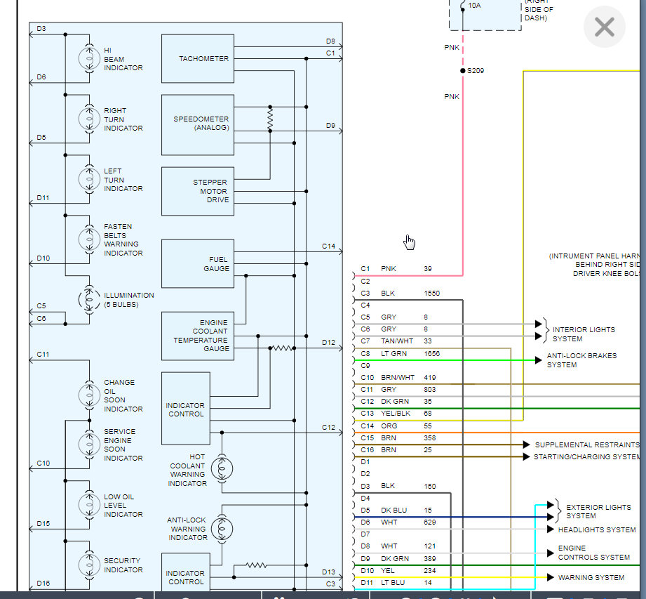

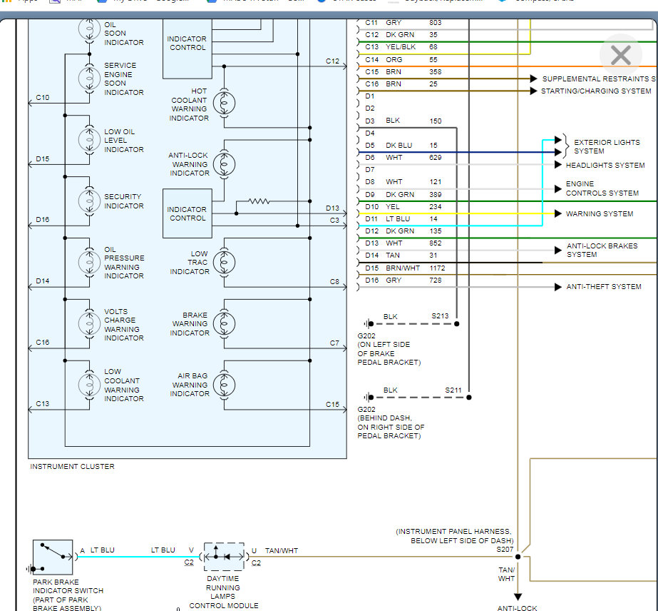

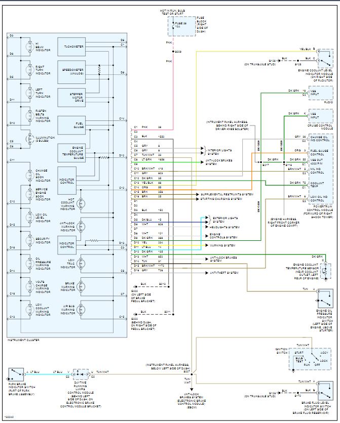

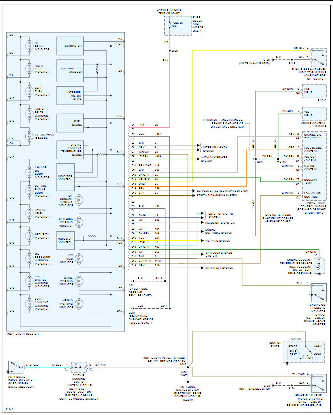

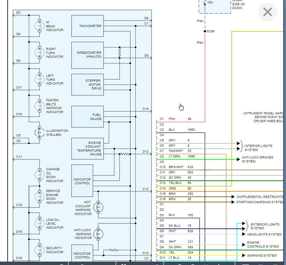

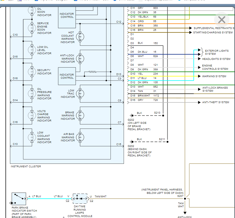

Hi all,
I am looking for cluster pinout for the car listed above.
I know its stop manufacturing it in US but it's continued in north Africa and Middle East.
Aug 31, 2020 at 1:19 PM
I don't have the diagram for the 2002 due to it not being offered in the USA as you stated and we only have manuals for USA vehicles. However, I attached the diagram for the 2001 as it is the same due to not making any changes.
Hopefully that helps. Let me know how you make out. Thanks
