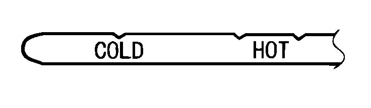

4. After wiping off any dirt around the dipstick, remove the dipstick and check the condition of the transmission fluid.
NOTE: If the transmission fluid smells as if it is burnt, it means that the transmission fluid has been contaminated by fine particles from the bushings and friction materials. A transmission overhaul and cooler line flushing may be necessary.
pic 1
5. Check that the transmission fluid level is at the "HOT" mark on the dipstick. If the transmission fluid level is less than this, add DIAMOND ATF SPIII or equivalent transmission fluid until the level reaches the "HOT" mark.
NOTE: If the transmission fluid level is too low, the oil pump will draw in air along with the transmission fluid, which will cause bubbles to form. If the transmission fluid level is too high, rotating components inside the transmission will churn the fluid and air into a foamy liquid. Both conditions (level too low or too high) will cause the hydraulic pressure to drop, which will result in late shifting and slipping of the clutches and brakes.
In either case, air bubbles can interfere with normal valve, clutch, and brake operation. Also, foaming can cause transmission fluid to escape from the transmission vents where it may be mistaken for a leak.
