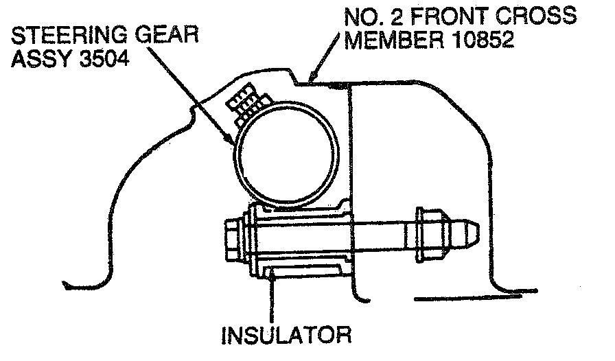

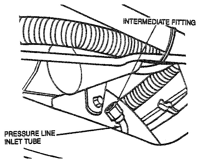

If there are no leaks at the rack, just make sure to flush it. It should be fine. However, if you decide to replace it, here are the directions. Pics 1 and 2 correlate with these directions.

6. Disconnect power steering pressure hose (3A719) at intermediate fitting and position out of the way.
See Pic 1
7. Remove steering shaft retaining bolt.
8. Remove rack-to-subframe bolts and nuts (access nuts through hole in front cross member (10852)).
9. Lower steering gear (3504) as necessary to remove pressure line inlet tube. Remove and discard plastic seal on inlet tube.
10. Cut tie strap securing power steering pressure hose to each tube.

4. Install pressure line in intermediate fitting.

6. Install steering gear sector shaft retaining bolts and nuts. Tighten bolts to 135-195N.m (100-144 lb-ft.
7. Install steering shaft retaining bolt and tighten to 41-57 N-m (30-42 lb-ft).

See Pic 2
