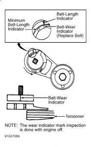

Possible your belt since it happens when you turn. . .. . .. . .it may be your belt tensioner. . .. . .below is a way to check to see if the tensioner is within spec. . .. . .. . .
https://www.2carpros.com/forum/automotive_pictures/248015_tensionor_1.jpg
Still with about 110K the tensioner could be replaced. . ...they aren't that expensive. . .. . ..that would ensure the alternator etc are getting the proper power to work.
