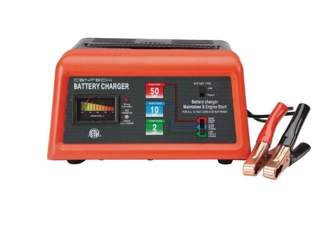

What did the car do when you put a charger on it? Was it a modern charger? I ask because many of the newer chargers will not put out any charge if it's truly a dead battery, instead they will shut off the charging section. If you can hook a small jump pack or another battery in parallel they will usually start charging. Or if you can find one of the older chargers that has no fancy circuitry they will usually work as well. I suggest a jump pack because they will normally put out enough power to make things work, even with a drained battery.

The locks are generally set up so the key pushed a small cover out of the way to access the pins, the problem is that if it hasn't been used in a long time or ever, they can fill up with dust, dirt and moisture and freeze up. Put the pack on and turn on the key, if it's sending power the dash should at least come on. If the battery is very discharged it may have frozen, for that the smaller pack might not have enough power to do anything. For that you might see if any of the local garages or road service have a vehicle they send out for these situations. Those are usually set up with large batteries or more than one and can deliver a big jolt to start even frozen batteries. If you are in an area that doesn't get that cold you could get a regular manual battery charger and just leave it on there a while. One that says manual on it like in the image (which is in the same store your jump pack came from). Put it on there at the middle setting and see what the battery does, if it takes a charge then let it charge an hour or so and see what it does then. If it got that low the battery will need to be replaced but that should at least get you in.
