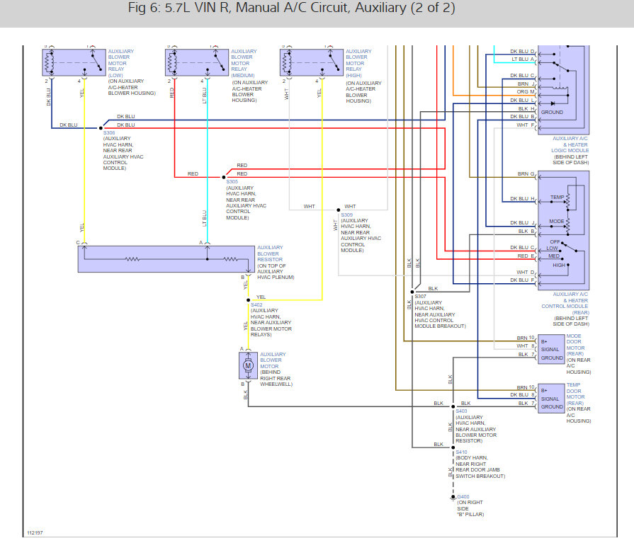

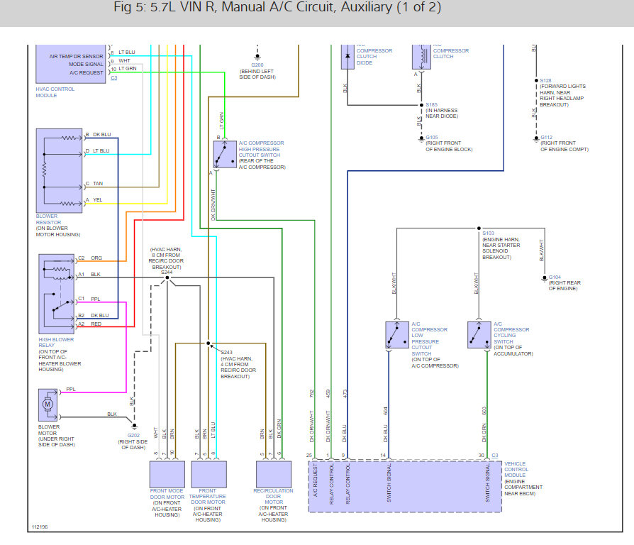

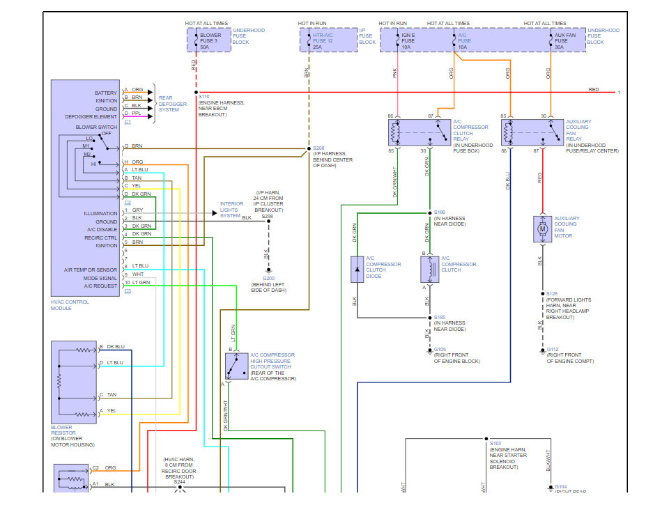

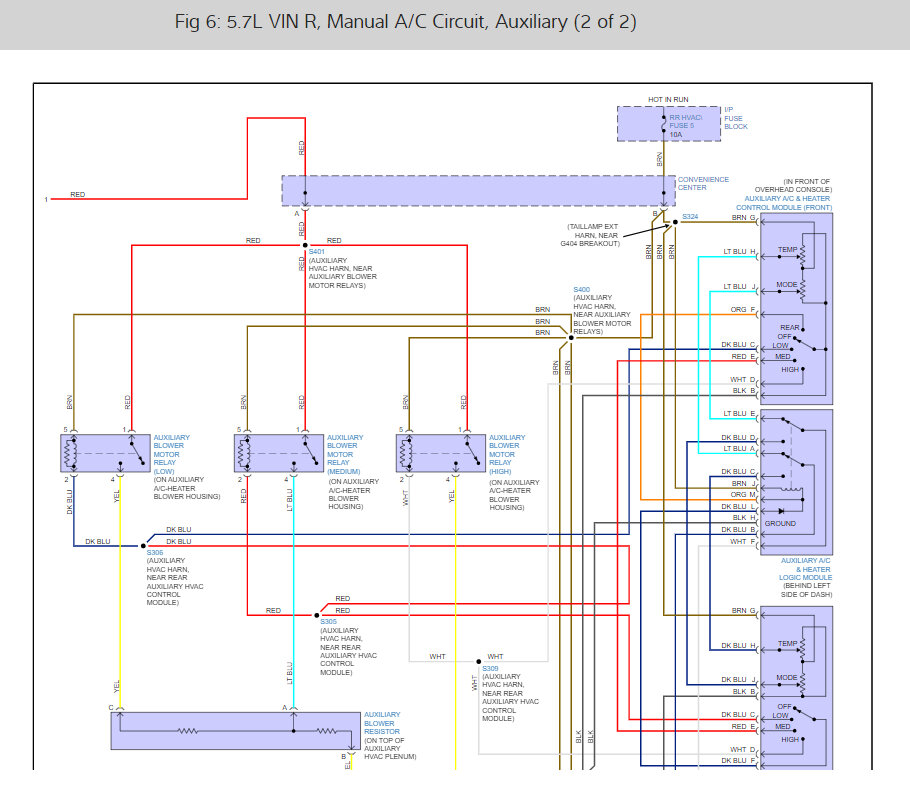

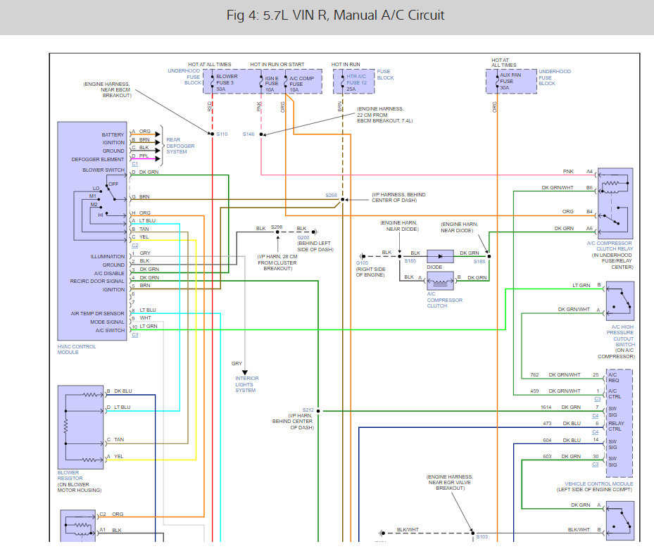

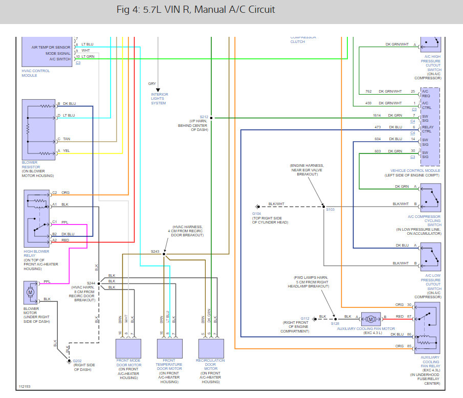

Here are the wiring diagrams for the HVAC system and a guide to help you check the connections:
Check out the images (below). Please let us know if you need anything else to get the problem fixed.
