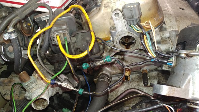

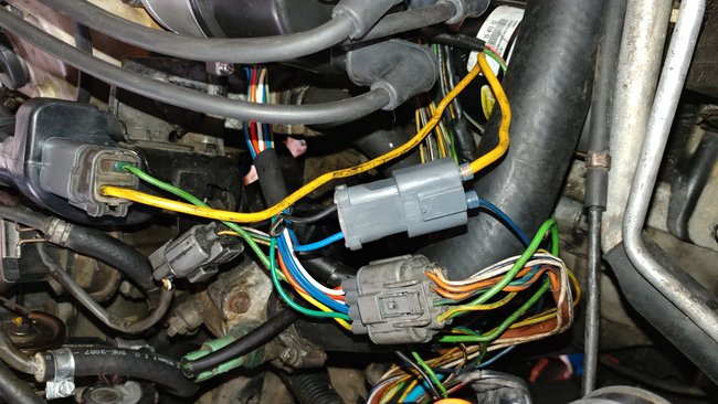

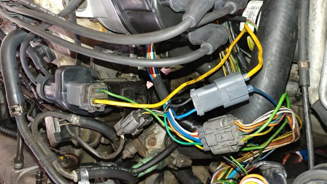

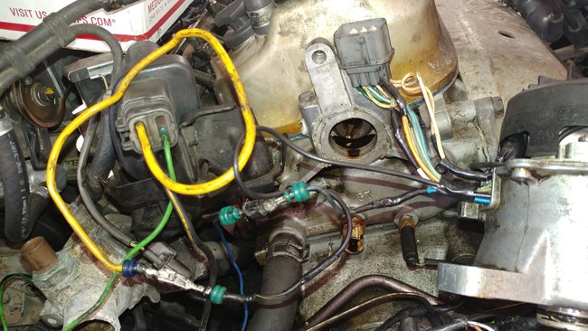

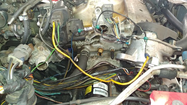

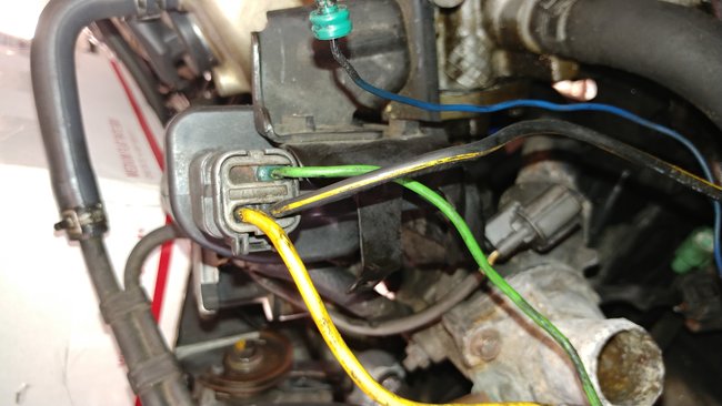

Someone told the last owner of this car that he was an electrical mechanic and you going to see that he is not.
I want to know about this connection and how to put it the right way, that is why i need your help. Can you send me the exploited view of the wiring for the ignition coil and the distributor? this a tune-up for this circuit, as you going to see.
You would not believe me if i told you that there was some wiring connection wrapped with masking tape blue, the same as we use for when we paint.
I really need your help. Thanks.
If you need more photos or more information ask me.

He is an electrical mechanic no doubt because he knows what goes to where and has a nice piece of art work there, only problem is the quality of his work.
Is that an external ignition coil in the first picture, attached with a bright yellow wire? Original ignition is located inside distributor.

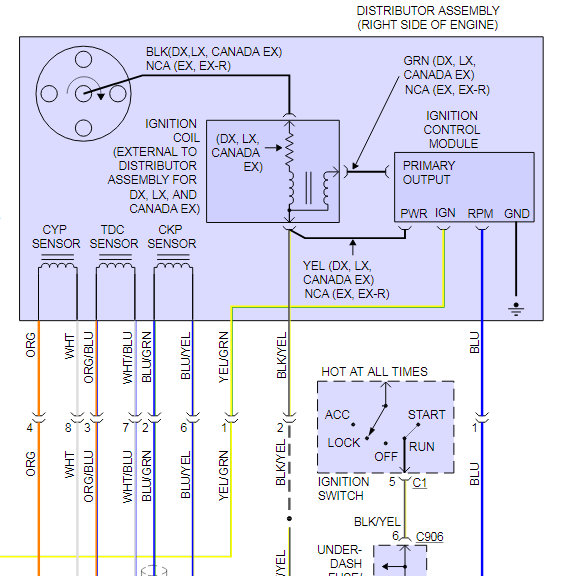

Our wiring diagrams do not come in exploded views, only in circuit diagrams format. Hope it is good enough for you.

Yes, the ignition coil is out of the distributor. can you tell to me that the connection are right? And yes the yellow wire is on the plug of the ignition coil. I need to send you more photos? Or for your experience you saw everything fine, only a touch of aesthetic appearance. But you saw the connection are right? I need to do nothing with the wiring, only make them look better.

THE QUESTION IS THAT THIS CONNECTION ARE RIGHT THEY ARE CORRECT?

It is not possible to understand if the wiring were connected correctly as those inside the distributor are not visible. If the engine could be started previously and you have not done anything to them, they should be correct.
Just ensure they are insulated well to prevent accidental shorting to ground.
