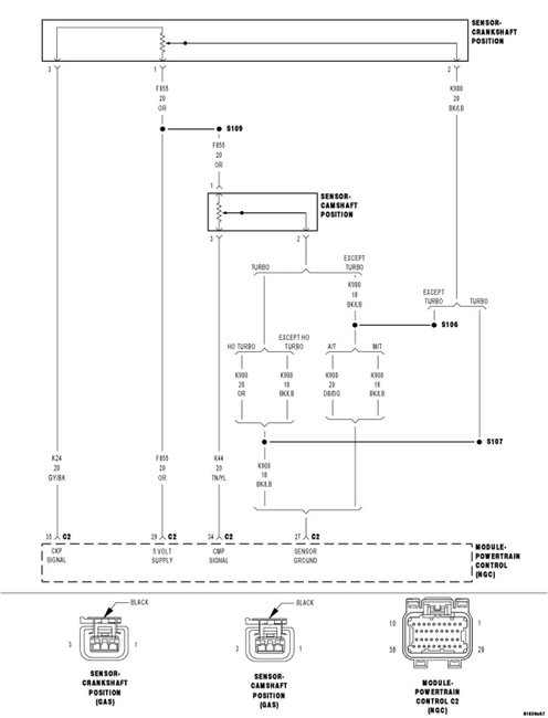

What I am going to provide is a flow chart related specifically to this code. It is a bit involved, but that is the point where you are. Here are the directions and the pictures will correlate with the directions.
____________________________________________
2007 Chrysler Truck PT Cruiser
Gas
Vehicle ALL Diagnostic Trouble Codes ( DTC ) Testing and Inspection P Code Charts P0340 Gas
GAS

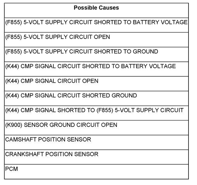

P0340-CAMSHAFT POSITION SENSOR CIRCUIT
pic 1
For a complete wiring diagram refer to Diagrams/Electrical.
- When Monitored:
During engine cranking and with the engine running. Battery voltage greater than 10 volts.
- Set Condition:
At least 5 seconds or 2.5 engine revolutions have elapsed with crankshaft position sensor signals present but no camshaft position sensor signal. One Trip Fault. Three good trips to turn off the MIL.
pic 2

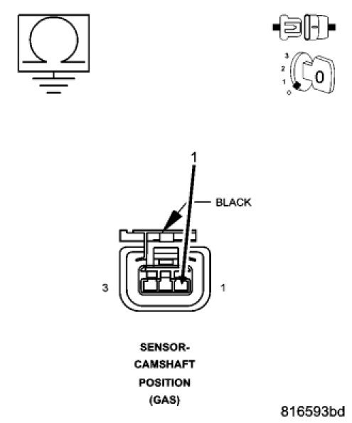

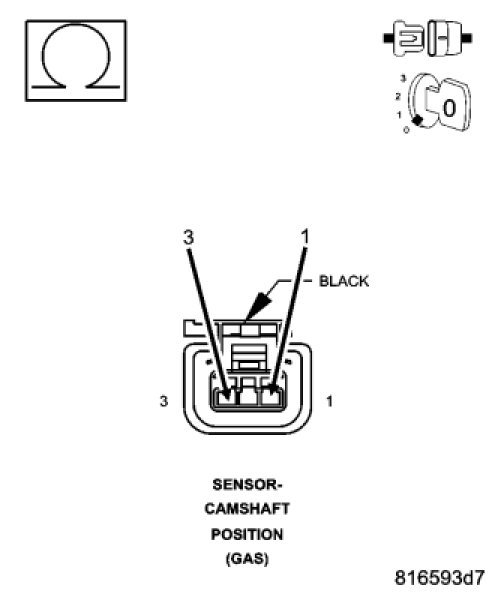

2. (F855) 5-VOLT SUPPLY CIRCUIT
pic 3
Turn the ignition off.
Disconnect the CMP Sensor harness connector.
Ignition on, engine not running.
Measure the voltage on the (F855) 5-volt Supply circuit in the CMP Sensor harness connector.
Is the voltage between 4.5 and 5.2 volts?
- Go To 3
- Go To 10

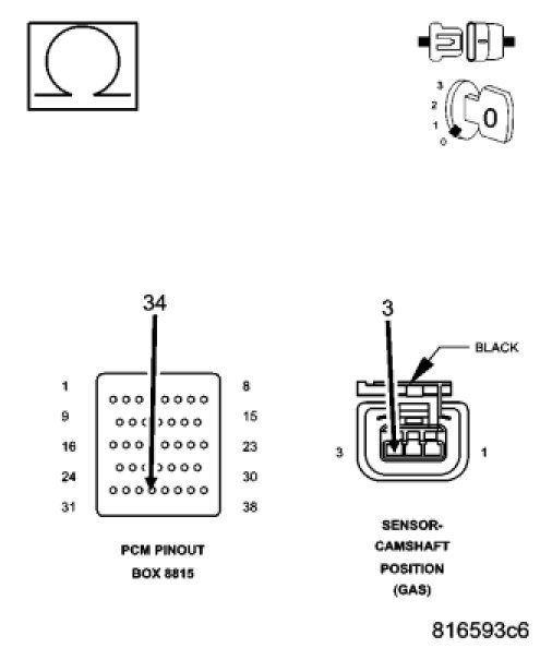

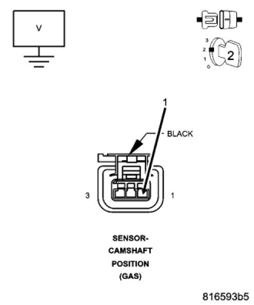

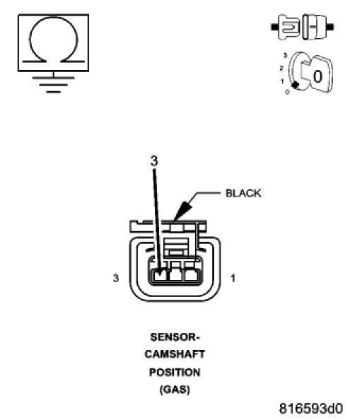

3. (K44) CMP SIGNAL CIRCUIT
pic 4
Measure the voltage on the (K44) CMP Signal circuit in the CMP Sensor harness connector.
Is the voltage between 4.5 and 5.0 volts?
- Go To 4
- Go To 7

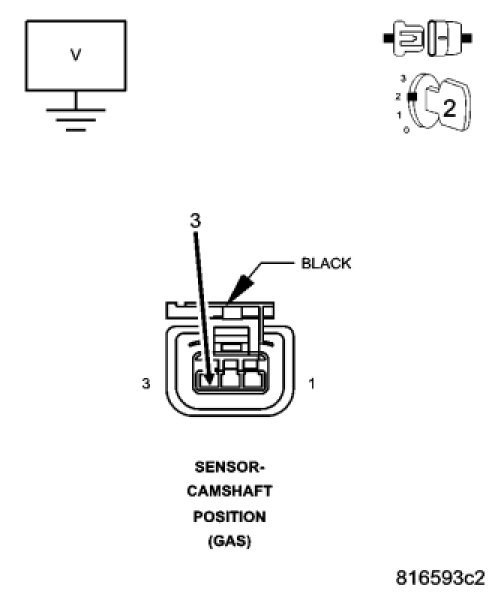

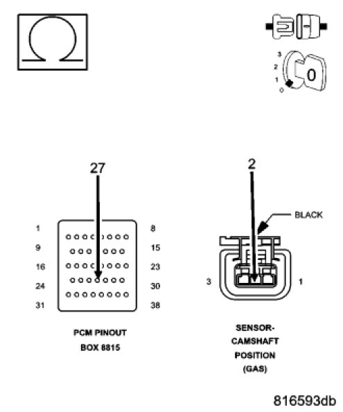

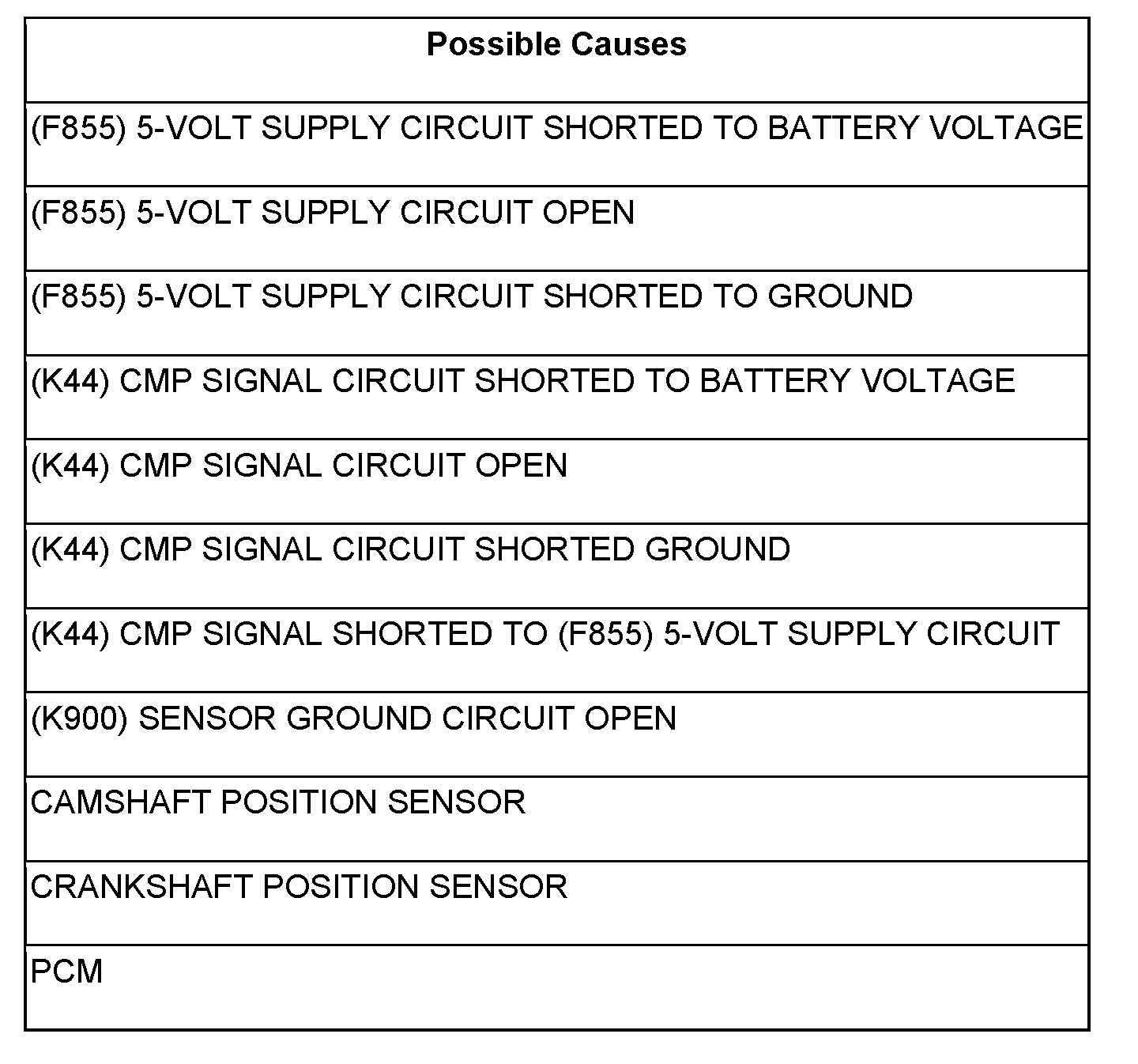

4. (K900) SENSOR GROUND CIRCUIT OPEN
pic 5
Disconnect the PCM harness connectors.
CAUTION: Do not probe the PCM harness connectors. Probing the PCM harness connectors will damage the PCM terminals resulting in poor terminal to pin connection. Install Miller Special Tool #8815 to perform diagnosis.
Measure the resistance of the (K900) Sensor ground circuit from the CMP Sensor harness connector to the appropriate terminal of special tool #8815.
Is the resistance below 5.0 ohms?
- Go To 5
- Repair the open in the (K900) Sensor ground circuit.
- Perform the POWERTRAIN VERIFICATION TEST. See: A L L Diagnostic Trouble Codes ( DTC ) > Verification Tests > Powertrain Verification Test

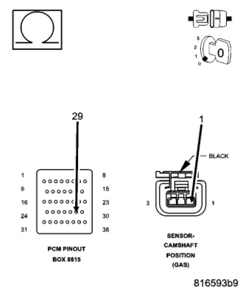

5. (K44) CMP SIGNAL SHORTED TO THE (F855) 5-VOLT SUPPLY CIRCUIT
pic 6
Measure the resistance between the (K44) CMP Signal circuit and the (F855) 5-volt Supply circuit in the CMP Sensor harness connector.
- Repair the short between the (K44) CMP Signal circuit and the (F855) 5-volt Supply circuit.
- Go To 6
