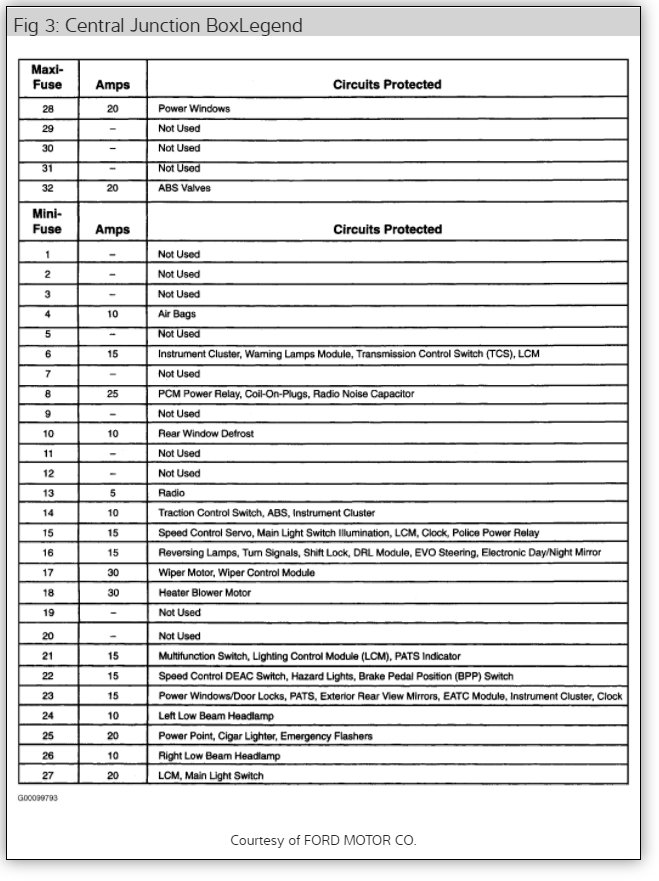

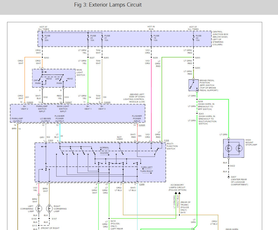

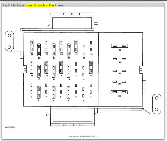

i have no tail lights in my car and no license or dash lights. i cannot figure out what is wrong. i did have a 15 amp fuse that was blown. can someone please help me figure out what my issues are? Thanks
Dec 2, 2017 at 12:54 PM
  • 55,423 POSTS

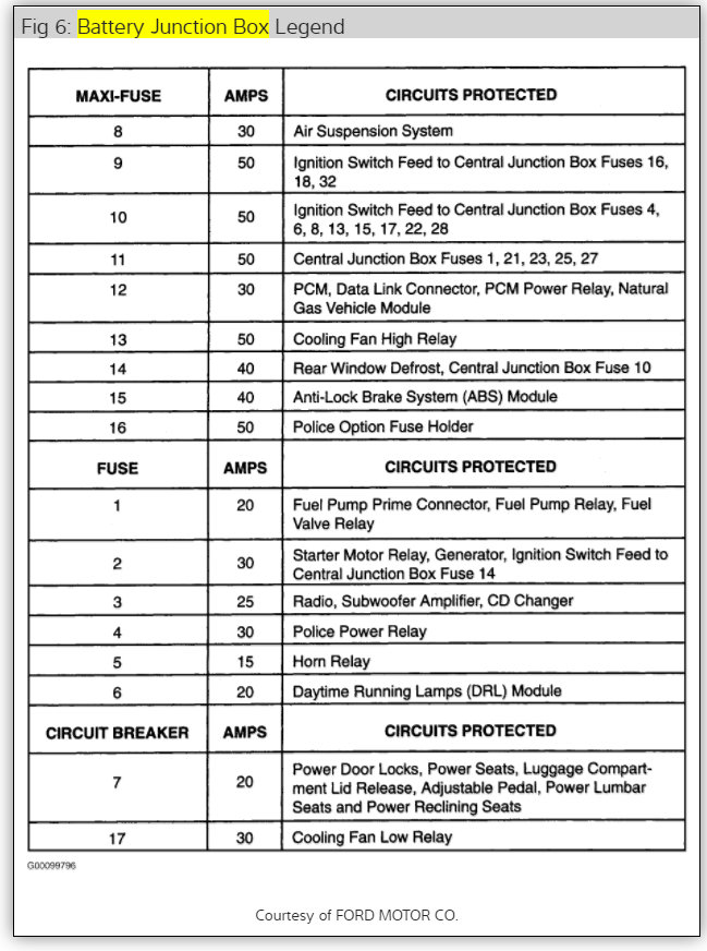

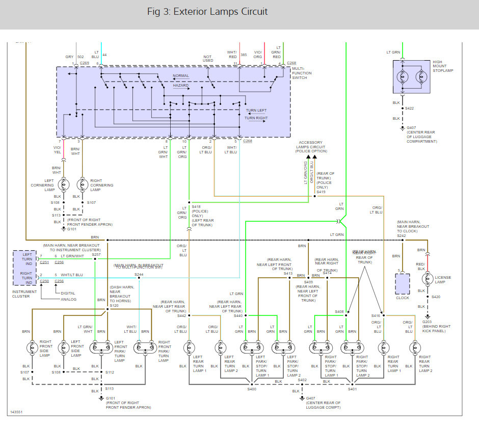

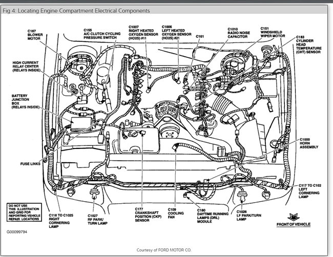

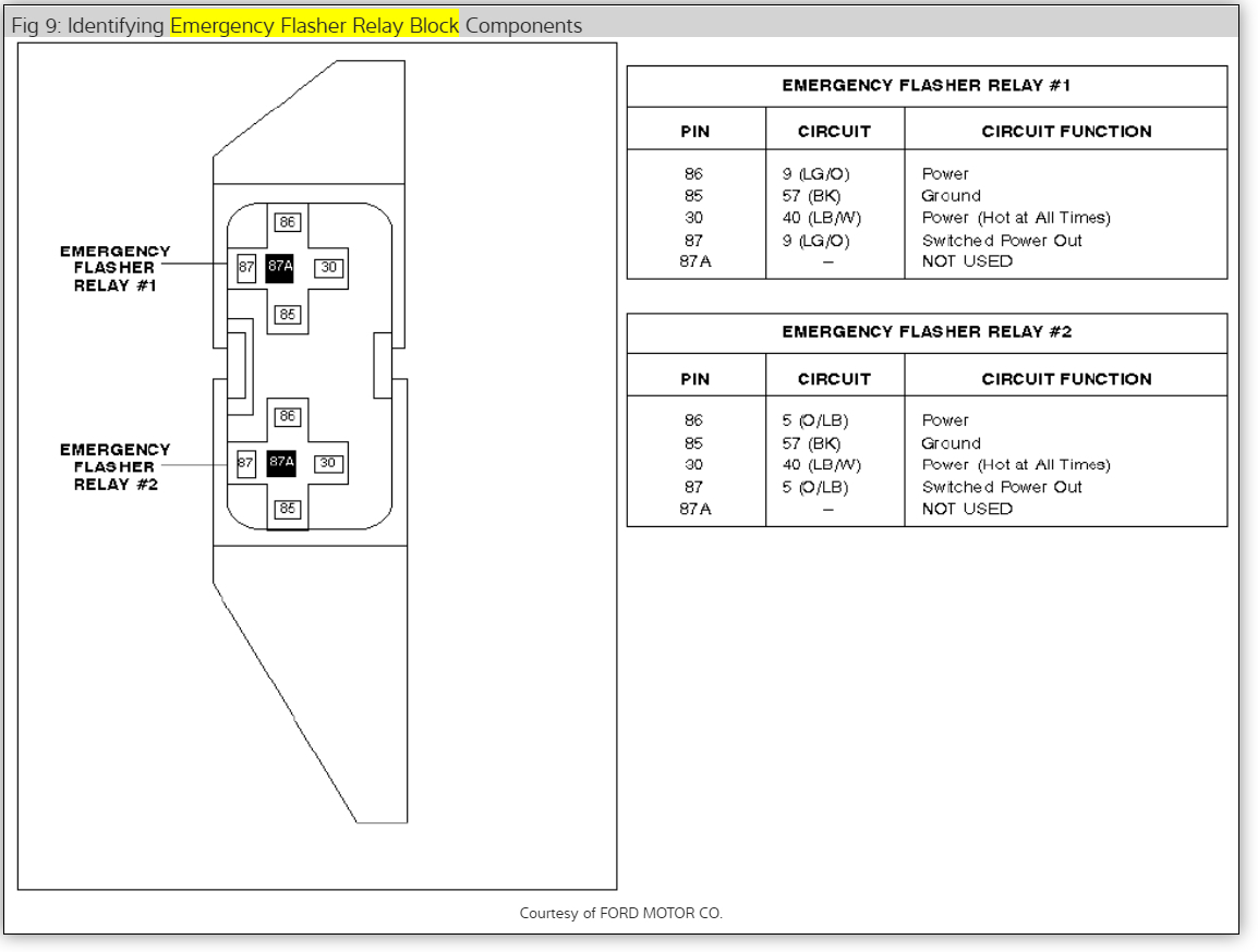

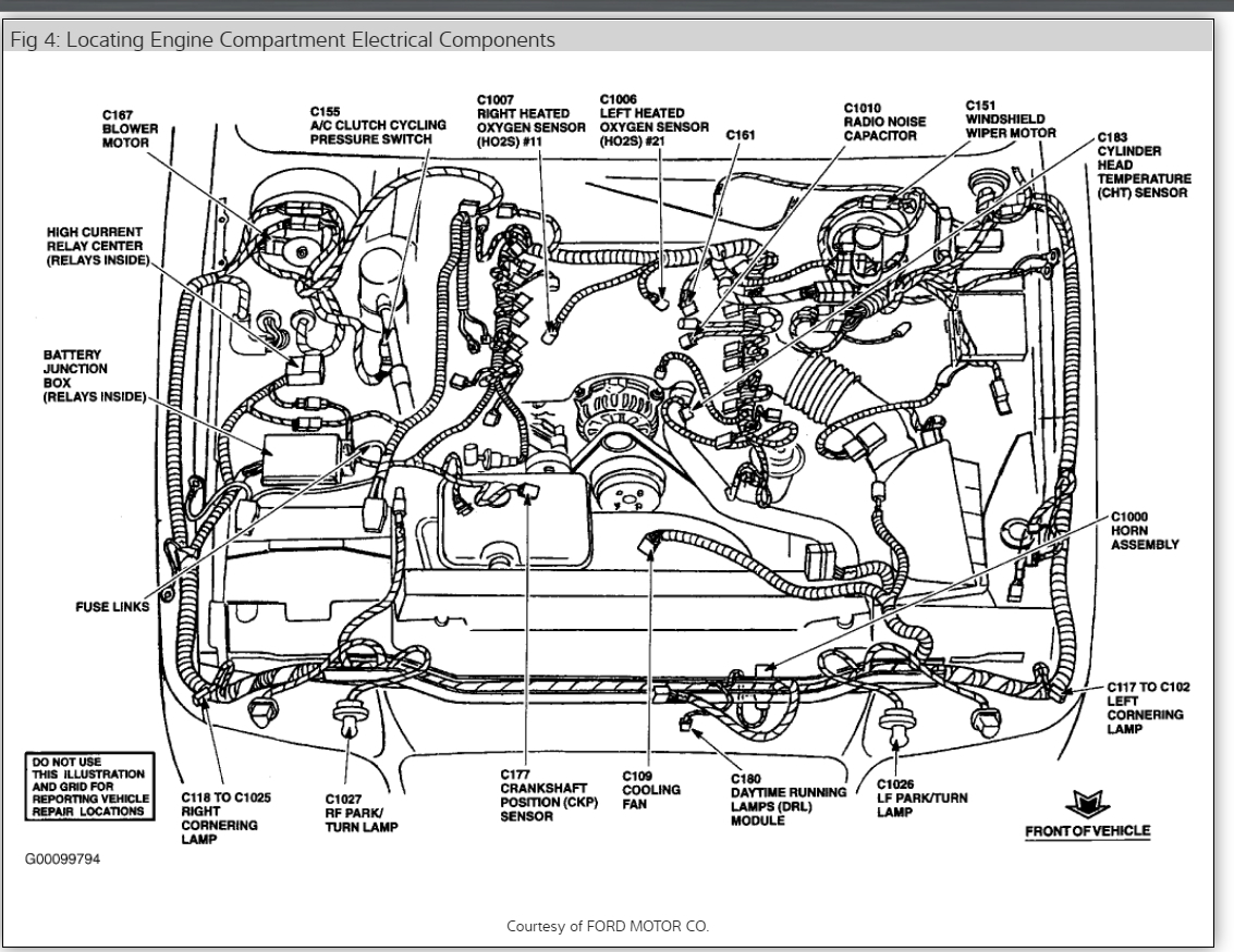

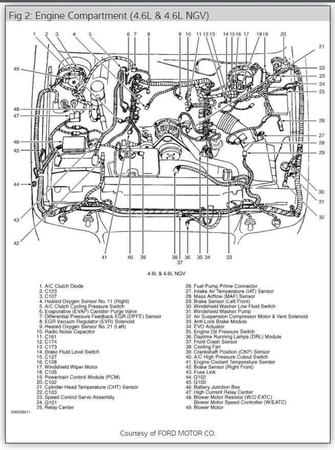

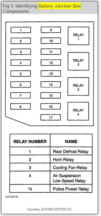

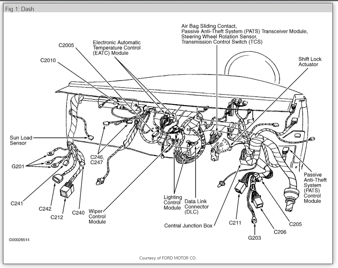

There are 5 fuses that run the system so we need to check them all, also there is a lighting control module that can be bad. Here are a couple guides to help you do some easy testing to see where you lose the power at.
and
Here are the fuse panel and lighting wiring diagrams to help us on our way.
Please run some tests and get back to us.
