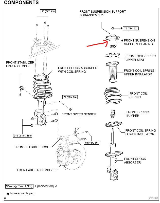

By heavy you mean hard to turn the steering wheel, correct? It sounds like the front strut bearing plates are locked up, I would raise the front of the car up with a jack and then steer the wheel, if it is easy with no strain on the pump, I would replace the front struts. Can you please shoot a quick video with your phone so I can hear the noise? That way I can tell for sure what's going on. You can upload it here with your response. Here is how to change the struts out. Check out the images (below). Let us know how it goes.

What causes the front strut bearing plates to lock?

They get rusted and lockup. I would try lifting the front of the car to see if the problem goes away.

Oh yeah, I think it behaved like that before.
When we lift it up and turn it, it was soft but when it's on ground it becomes hard.
I would try it with my mechanic and let you know how it goes?

Sounds good, I don't think it is the pump or rack, you changed it too many times. To confirm you did change the high pressure hose, correct? It might be the low-pressure hose though FYI.
