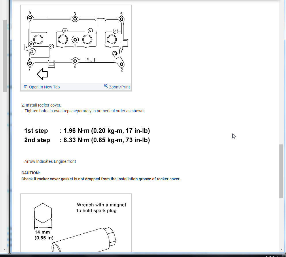

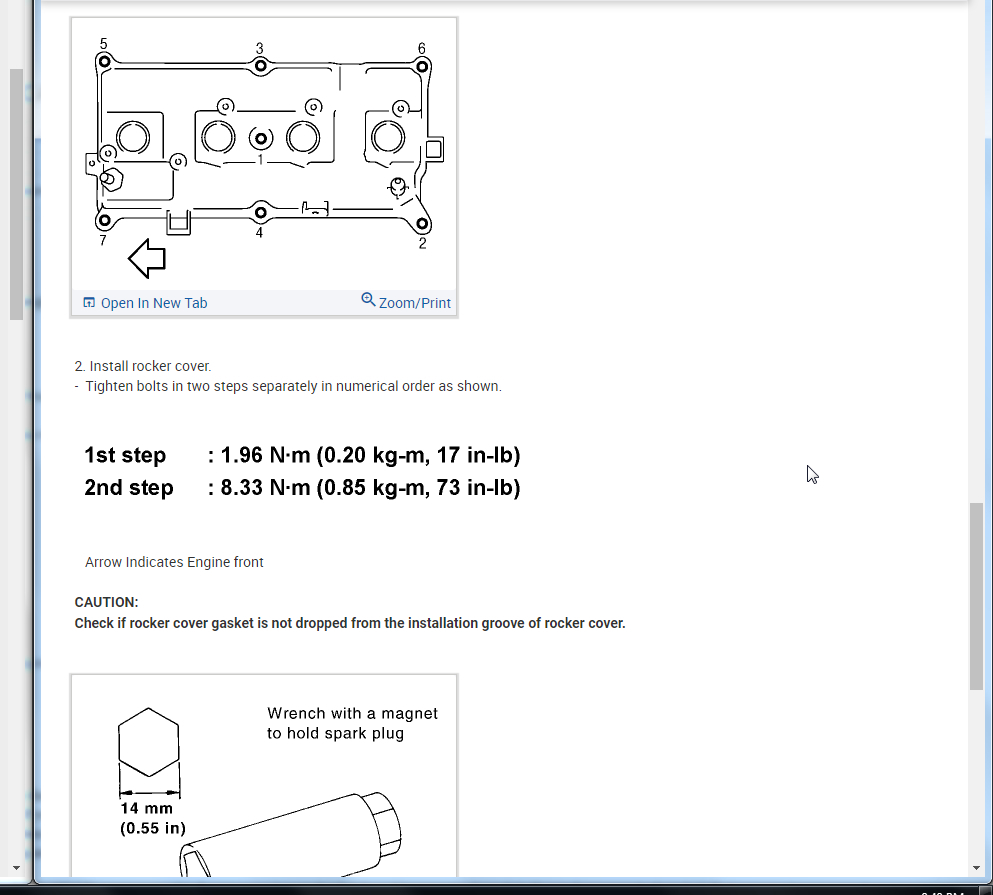

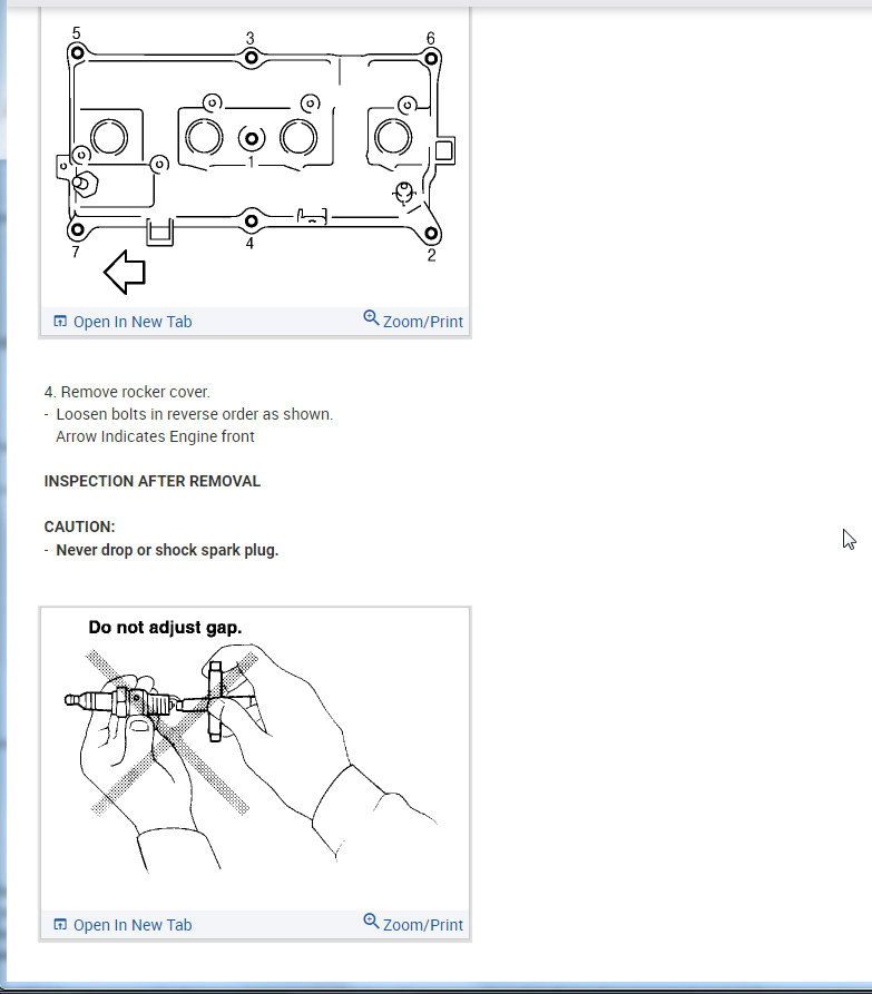

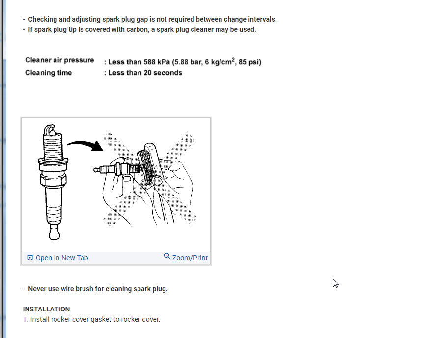

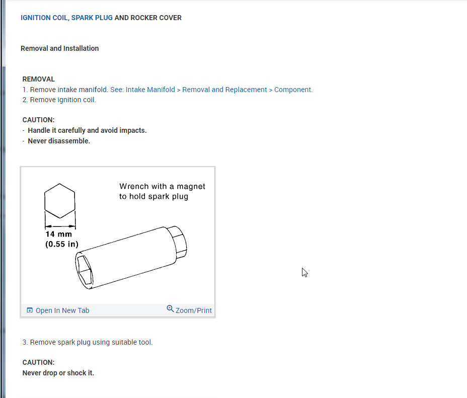

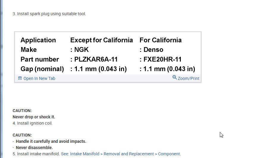

Do you still have the cylinder 2 misfire? If so we need to chase that down first.
If that is gone then we need to look at a fuel issue and spark plugs. You said you replaced the coils but did you replace the plugs as well? If not, we may want to do that.
Also, here is a guide on how to check fuel pressure when this is happening:
Let's run through this material and let us know what you find. Thanks
