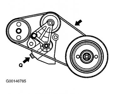

To loosen (or tighten) the tension on the power steering belt, you will want to turn the adjusting bolt (labeled Q below). Counterclockwise to loosen and clockwise to tighten.

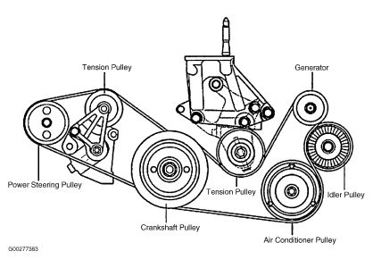

Okay, for the A/C / alternator drive belt you will want to turn the adjusting bolt (pictured below) counterclockwise to loosen it.
A/C / Alternator Adjusting Bolt
https://www.2carpros.com/forum/automotive_pictures/261618_Graphic_765.jpg

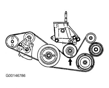

Drive Belts Routing
https://www.2carpros.com/forum/automotive_pictures/261618_Graphic2_110.jpg

Okay sorry about that. No, once the bolt is loose you will want to rotate the belt tensioner CLOCKWISE to loosen the belt, rather than counterclockwise. I may have confused you on that with saying CC with the bolt. So try rotate the actual tensioner itself clockwise and it should loosen belt. If it is a bit tight you can peck on it with a rubber headed mallet with slight force.

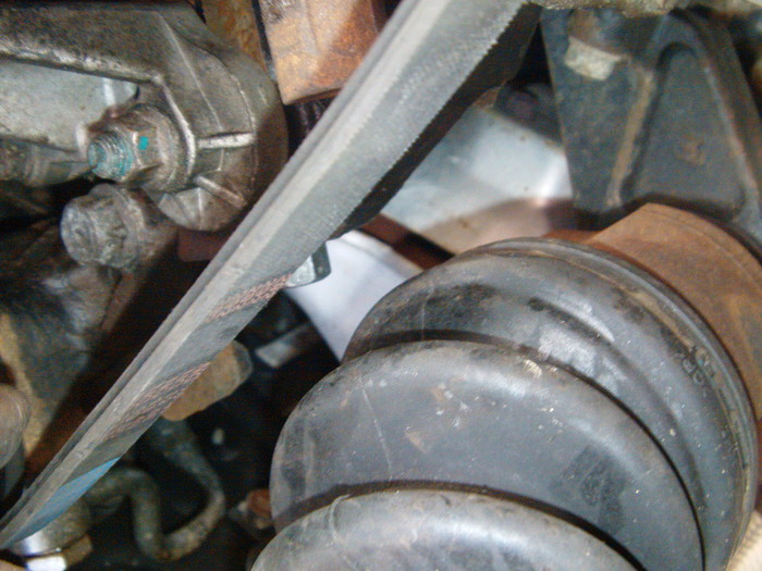

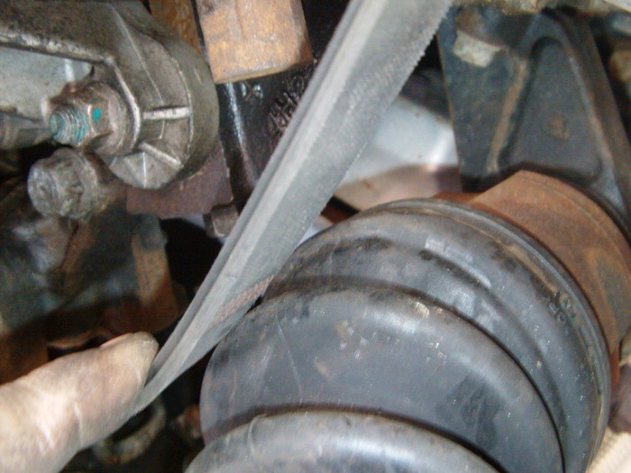

Winter is gone. I'm trying it again. I have the right side tension pulley bolt down (released) about one inch (couterclockwise), and the left tension bolt (first graphic above) has been turned counterclockwise and became loose but the more I continue turning it this way the more harder it becomes like adjuasting it again. No motion of the "bracket" is seen, and the belts are both hard to remove. I turned that car On to see if the motion release them, and nothing, they still working as if I never loose any bolt. Please tell me "where to hit" with the rubber hammer, like to say, "hit the Power steering pulley" or "hit the tension pulley" or "hit the air conditioner pulley".
Do I must keep turning the left tension pulley bolt counterclockwise regardless of the feelng that is "adjusting it" until I see the bracket moving of easy to move?
I know I'm close to remove the belts, but still can't get the trick.

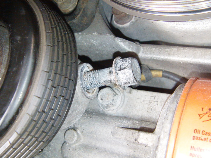

IMNOTAMECHANIC
  • 17 POSTS

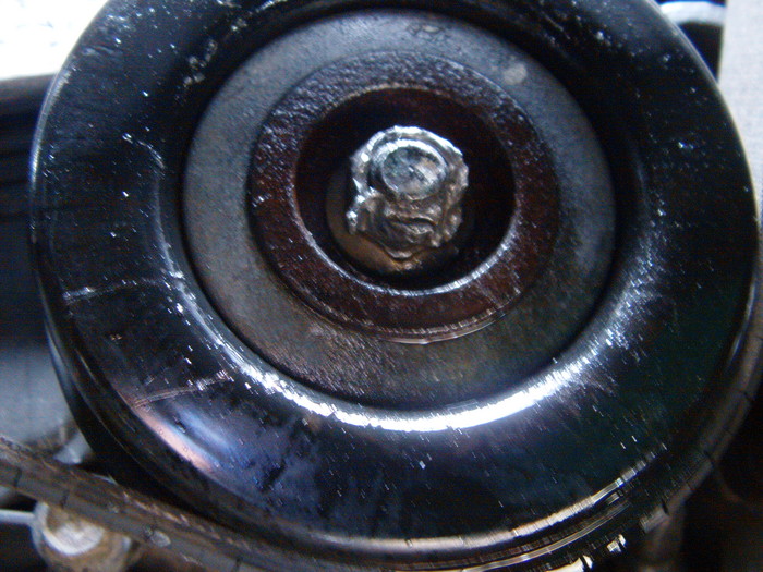

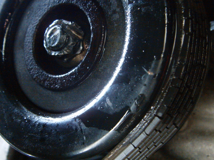

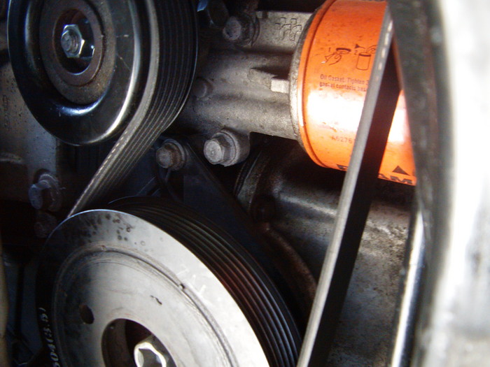

. But, my main concern still is the AC/alternator belt. I have turned the bolt counterclockwise as indicated by you and the belt still is tight as hell. You can see in the picture the bolt coming out. Is perhaps the turning of the bolt clockwise instead?
In case I'm in the right path, how to make the belt to get loose now? What to move? Where to hit? Just "cut off" the belt? :-)
(I think the picture will show the bolt going right, actually the bolt is going down, the same as the oil filter behind it)
Wednesday, April 6th, 2011 AT 8:46 PM

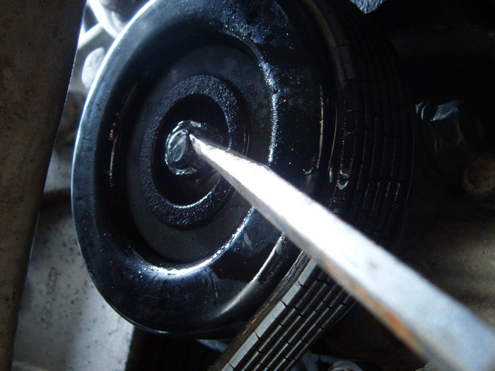

KHLOW2008
  • 41,814 POSTS
At the side of the pulley ther is a holding nut, it must be released before the pulley will move.
Thursday, April 7th, 2011 AT 10:31 PM
IMNOTAMECHANIC
  • 17 POSTS
KHlow2008,
the first move I did in my first try before writing here, was to loose the nut that holds the pulley. It was that hard that I used D-40 and nothing, I noticed that I was starting to destroy the corners of the hexagon of the nut and I did stop. The releasing of this nut is hard by its location, which is very difficult to reach. I thought after this first step which failed, that the loosing of the belt was by doing it in a different way.

KHLOW2008
  • 41,814 POSTS
Sorry if I did not make myself clear.
There are 2 bolts, one for the pulley ( bearing ) and the other is the mounting. The one to loosen is the mounting bolt and not the one holding the pulley.
Friday, April 8th, 2011 AT 11:31 AM

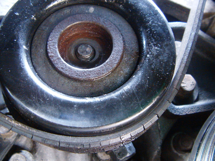

IMNOTAMECHANIC
  • 17 POSTS
I'm glad for the rain, otherwise I should be loosing the other nut. I will look for the other nut on Sunday. There is a graphic above showing the pulleys, the one I must release has three bolts around, one right above and the other two on its right side. There is also one more to the far left. If you are reading this reply before Sunday, please tell me which one of those bolts, or if the nut is other than the ones shown in the graphic.
Thanks again for your help.

KHLOW2008
  • 41,814 POSTS
Maybe I was not paying too much attention.
The one that you are having problem with is it the A/C or Power Steering Belt?
Sometimes pictures are shown not in their proper perspective so it is a little confusing.
For the A/C belt, the central holding the pulley (bearing) has to be loosened.
Saturday, April 9th, 2011 AT 12:11 AM

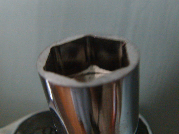

IMNOTAMECHANIC
  • 17 POSTS

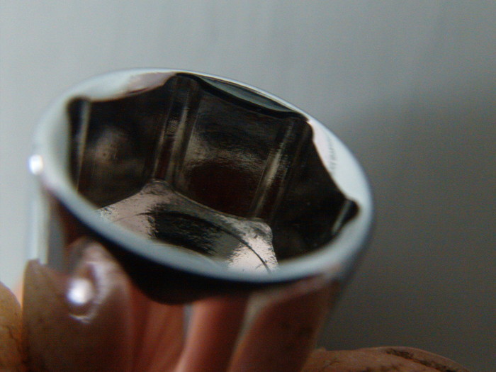

Today I was looking for a metric wrench similar to a break bleeder wrench, because they can reach nuts and bolts that are located in a lower surface level. This is the problem with the nut of the pulley in question, my wrench has a regular angle which is not enough to reach and fit properly to the nut.
I will heat a wrench and bend it in that way to reach the nut and make it fit entirely. Or perhaps I will reduce the beveled interior sides of the nut socket in the bench grinder for the same purpose, because the nut's width is very thin.
I will find the way to loose that nut that gave me hard time in my first try, Sunday I will loose it even if I must have to use the troglodyte method using a flat screww driver and a hammer and hit and push a side of the nut until moves.

KHLOW2008
  • 41,814 POSTS
The hex part is rather thin and you need a hex wrench, not those with multi points which can easily result in it going loose.
There are wrenches available which are not angled which would be the best choice of tool to use. Snap-on makes one of the best but they are rather pricey.

IMNOTAMECHANIC
  • 17 POSTS
Well, I bought extra nut sockets in the pawnshop for a buck, and took the beveled interior. This way the nut socket will fit entirely to the nut. I didn't find a 14mm hex head wrench to release the bolt, so I went with the wrench.
Monday, April 11th, 2011 AT 12:18 AM
IMNOTAMECHANIC
  • 17 POSTS

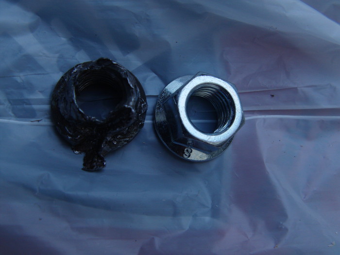

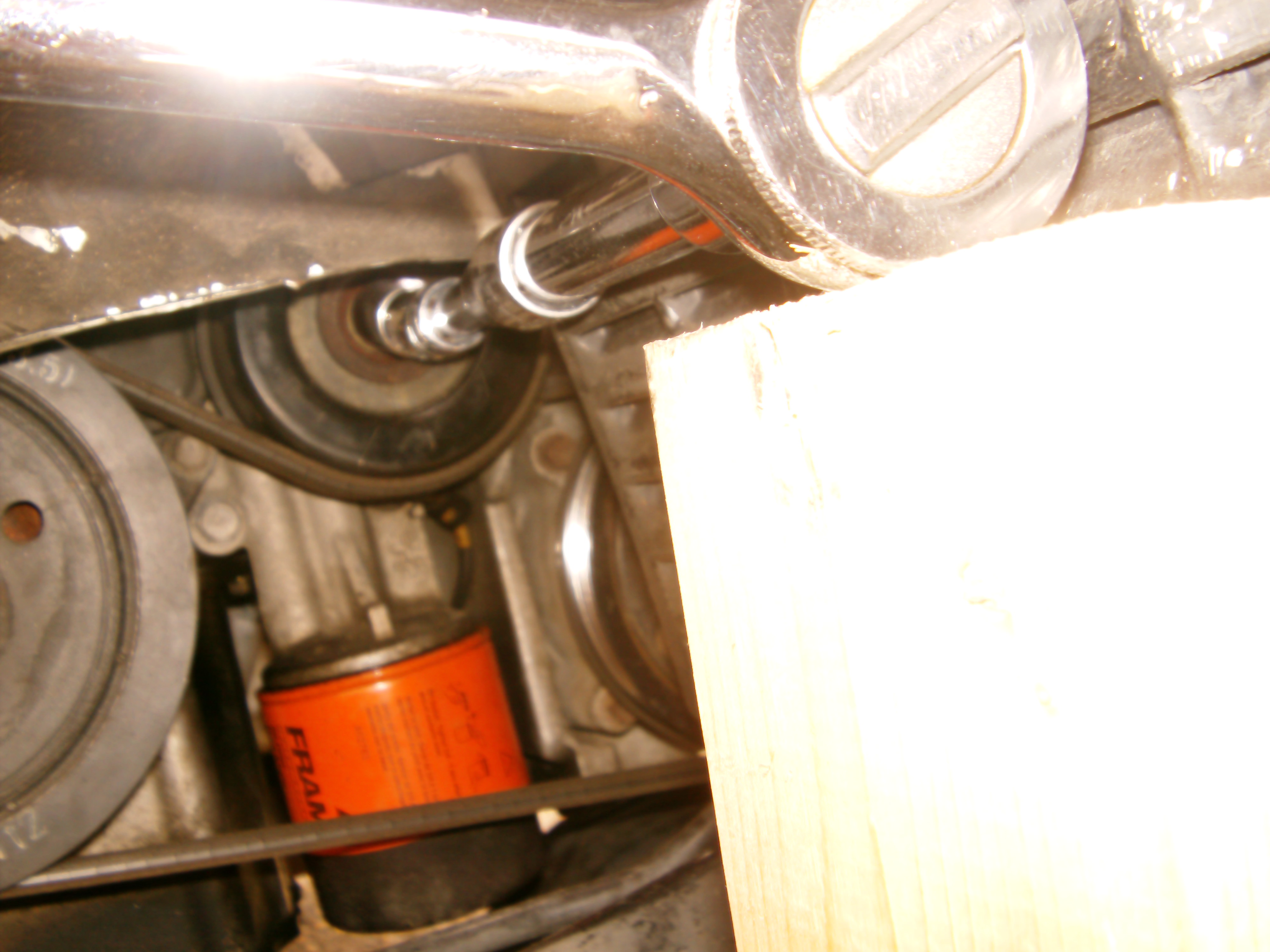

In order to take the nut out I had to make a base to hold the wrench, to which I must have to add extensions because otherwise won't fit straight. The nut came out so easy, that I should made this step in November last year and have no need to consult no one. After I took the nut, the process of changing the belts was a piece of cake, the way it is suppose to be.
Monday, April 11th, 2011 AT 12:26 AM
IMNOTAMECHANIC
  • 17 POSTS
Ha ha ha ha. Easy! To take that nut was HELL. I had to become a troglodyte and with a set of screwdrivers and a hammer I practically had to brake the nut. I spent lots of D-40 and took me about an hour of hard work. Finally the nut moved, look at it, believe me, there was no other way because I lack of "special tools" for situations like this.
