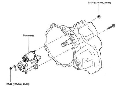

How would you go about taking the starter out? Is one of the bolts on the Transmission?

Remove or disconnect the following: Negative battery cable Speedometer and shift control cables Starter electrical connectors Starter motor
https://images.2carpros.com/forum/automotive_pictures/261618_Noname_320.jpg
Install or connect the following: Starter motor and torque the bolts to 25 ft. lbs. (34 Nm) Starter electrical connectors Speedometer and shift control cables Negative battery cable Thanks for using 2CarPros.com!
