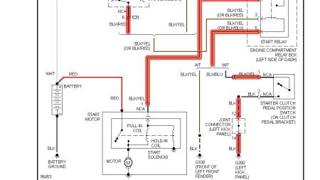

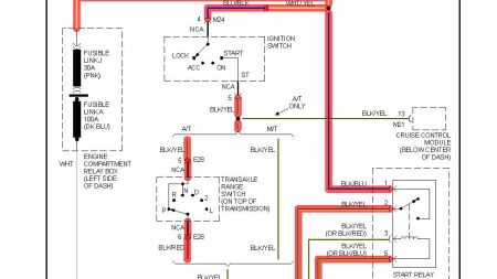

Do a battery capacity test-if it passes make sure the its clean and tightened properly.
Below is your starter control circuit-if you wish to start-find the clutch switch at the pedal support bracket disconnect it and jumper it and see what happens if it continues track it by using the diagram below
https://www.2carpros.com/forum/automotive_pictures/12900_st1_22.jpg
https://www.2carpros.com/forum/automotive_pictures/12900_st2_20.jpg
