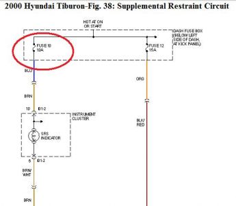

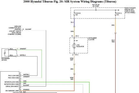

There is no relay, but you need to check fuse #10, rather than #12.

Fuse #12 said on the fuse cover that it was for the airbags. I checked fuse #10 which says it is for the cluster. They are both good. Still no light, though.

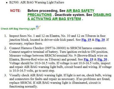

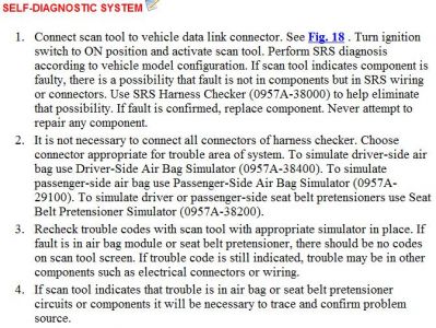

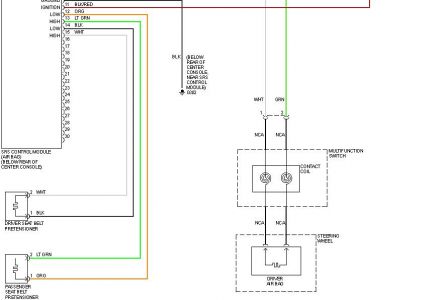

Both fuses #10 and 12 control the SRS system. The only to diagnose the problem, though unfortunately by using scan tool capable SRS operation.
