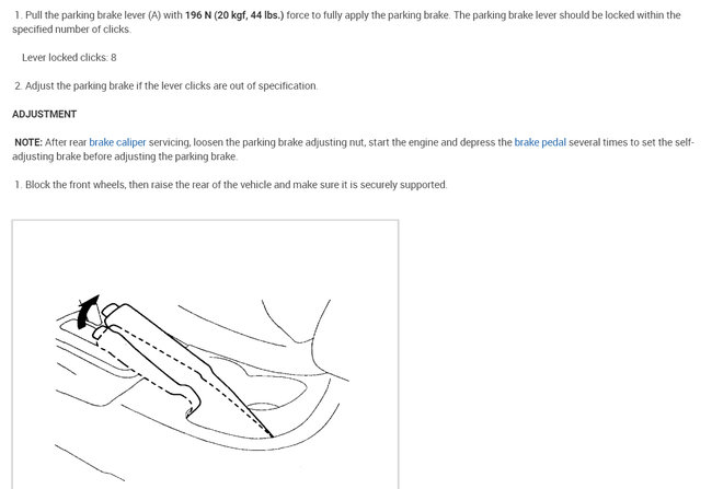

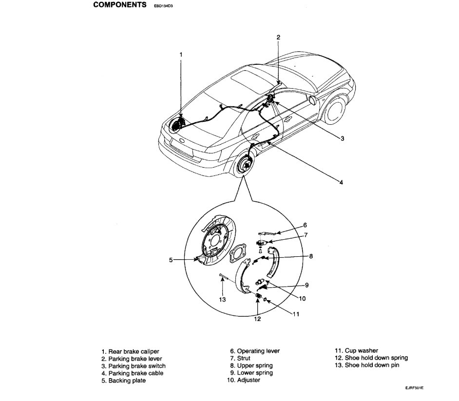

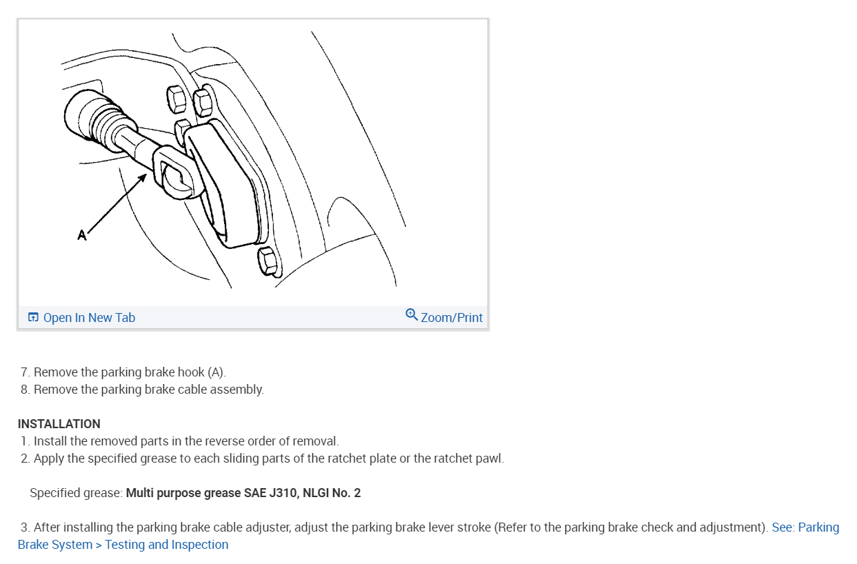

I recently replaced the rear rotors and pads on my 07 sonata. I manually backed off the star wheels for the parking brake shoes prior to installing the new rotors. I'm not sure if there is an automatic adjustment to readjust the parking brake as I am not able to get it readjusted automatically by applying and releasing the parking brake handle. Please help with the proper parking brake readjustment procedure.

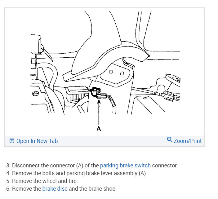

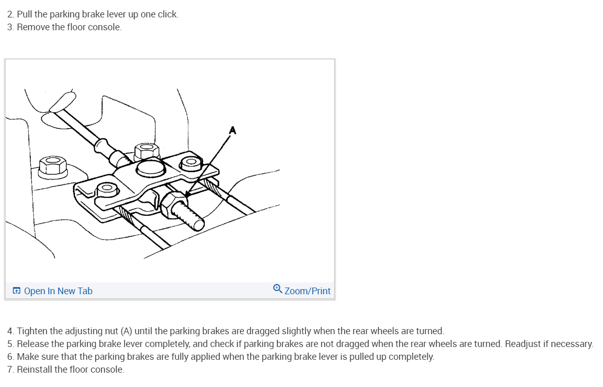

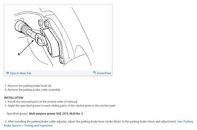

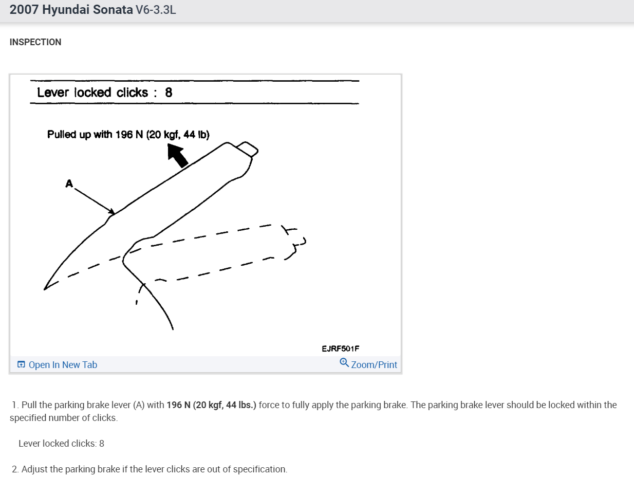

It sounds like you may have not connected one of the braking brake cables here are the instruction on how to install the parking brake shoes and how to adjust them. Check out the diagrams (Below). Please let us know what happens. Check out the diagrams (Below). Please let us know if you need anything else to get the problem fixed.
